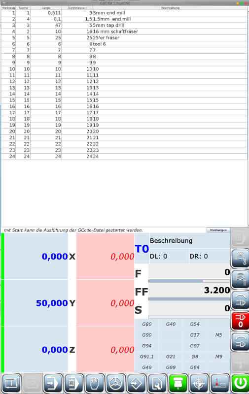

I just finished my tooleditor.
There I read in the tools from definition file named in ini-file.
When the user (me) changes a tool offset, the changes are commanded to linuxcnc via NML interface.
When I then start gcode execution with that tool, I see the new tool offset in statusline of axis ...
... and best of all - changes are persisted without me having to code anything for it
So the changes got active instantaneously.
Ah - and there are no lags, freezes or whatever.
Everything works as expected.
Cheers Reinhard
Cheers Reinhard
