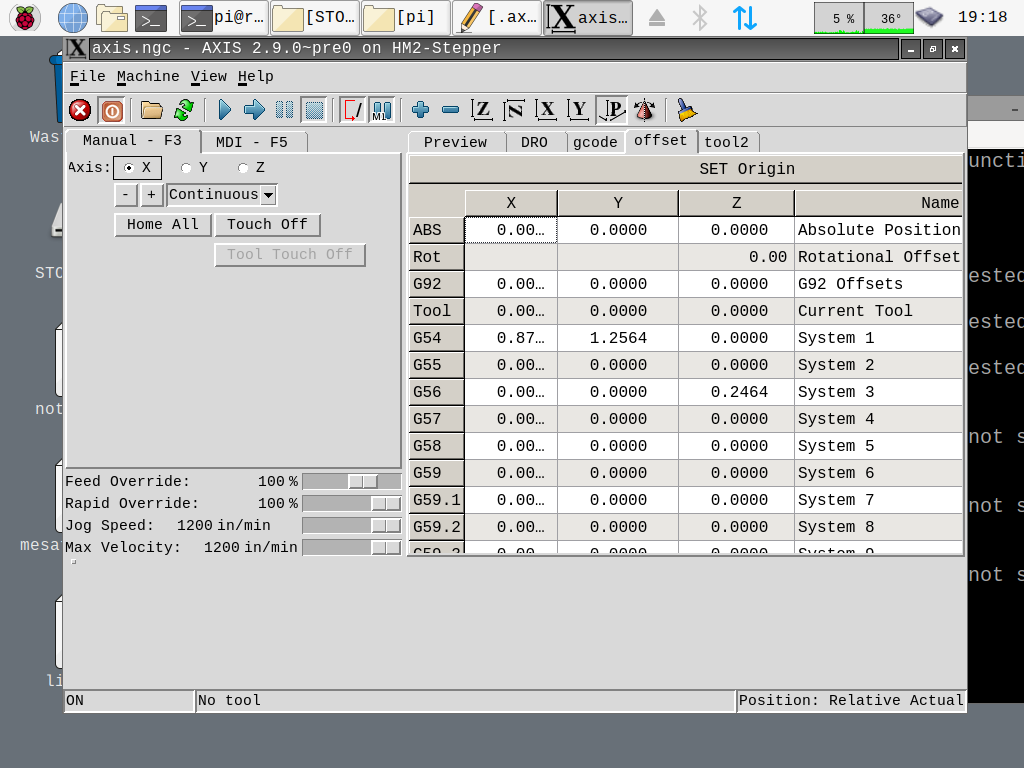

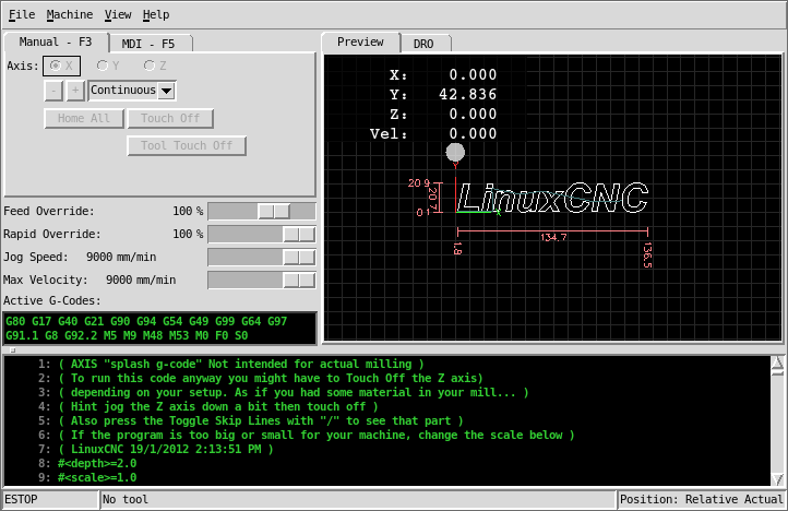

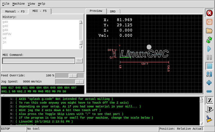

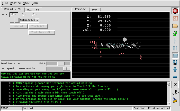

When you start getting down in screen size to 5" and 7" screens, most of them have a 800x480 resolution sometimes not scalable.
pic is just an example i found online but ive seen pictures like this several times. The same thing happened to me the first time I got axis to load on my 7" screen, it completely cuts off the gcode bar. Not totally unusable but not ideal. (I know, im using an RPI4 to do stuff and i mention machine kit so dont judge me to harshly,this is the reason i cannot do a full qtvcp gui but this isnt about that, its about modding the trusted/stable axis gui to work on 800x480 screens, so please keep an open mind) Im not to good with computers and honestly dont know what Im doing, but I have been reading a lot so here is what Ive got
Goal: to get specifically Axis working well in 800x480
Current route: try to resize everything using usercommand file, and reframe the toolbar to a vertical pan on the right
progress so far
forum.linuxcnc.org/21-axis/38188-solved-...w-usercommand#168337
USEABLE AXIS for small screens
Best option: move gcode into the manual/mdi tab
no idea how to do this, but if anyone else does thats cool

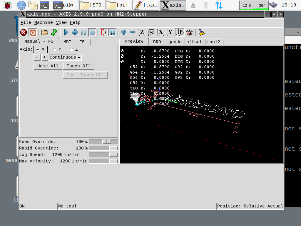

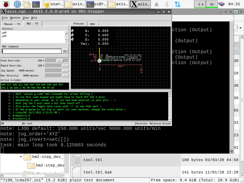

Current routefirst attempt: with qtvcp(or maybe glade) tabs and .axisrc
(hopefully to make it somewhat cross compatible with machinekit, they have a qt thing but idk if it will work with this)
qtvcp tabs: somehow i installed qt designer with the linuxcnc plugins by mashing commands into terminal. from there, I copied the qtvcp tab stuff for axis. I opened up the camview widget and made some panels with widgets like the gcode viewer and added them to the share/qtvcp/panels.
The panel files still need some work, but its a proof of concept
only loads gcode after a new file is loaded also during tests seems 1 line ahead of the axis gcode viewer. need to add run from line and fix sizing, maybe gcode edit

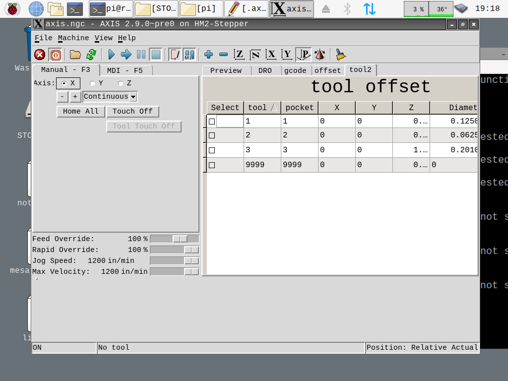

I know there is already a tool table thing in axis, but i like things being in tabs,
I added this to my ini file to get it to load more than 1 tab. i dont know how to do it properly i think its something like usertab1 or something but i dont know, this is just something me and a friend were trying out and it worked
[DISPLAY]
# Embed tabs
#EMBED_TAB_NAME= offset
#EMBED_TAB_COMMAND= halcmd loadusr -Wn qtvcp_embed qtvcp -d -c qtvcp_embed  -x {XID} offset
#EMBED_TAB_NAME= alarm
#EMBED_TAB_COMMAND= halcmd loadusr -Wn qtvcp_embed qtvcp -d -c qtvcp_embed  -x {XID} alarm
EMBED_TAB_NAME= gcode
EMBED_TAB_COMMAND= halcmd loadusr -Wn qtvcp_embed qtvcp -d -c qtvcp_embed  -x {XID} gcode
EMBED_TAB_COMMAND= qtvcp -d -c qtvcp_embeda  -x {XID} offset
EMBED_TAB_NAME= tool2
EMBED_TAB_COMMAND= qtvcp -d -c qtvcp_embedd  -x {XID} tool2
I might have to remove Max velocity slider but I dont know if thats ini or .axisrc

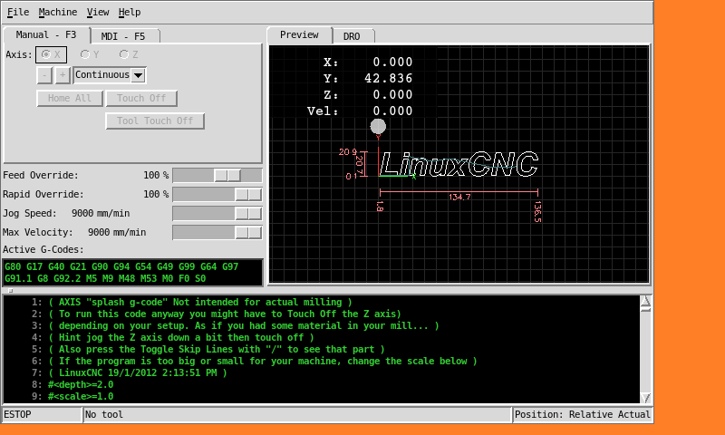

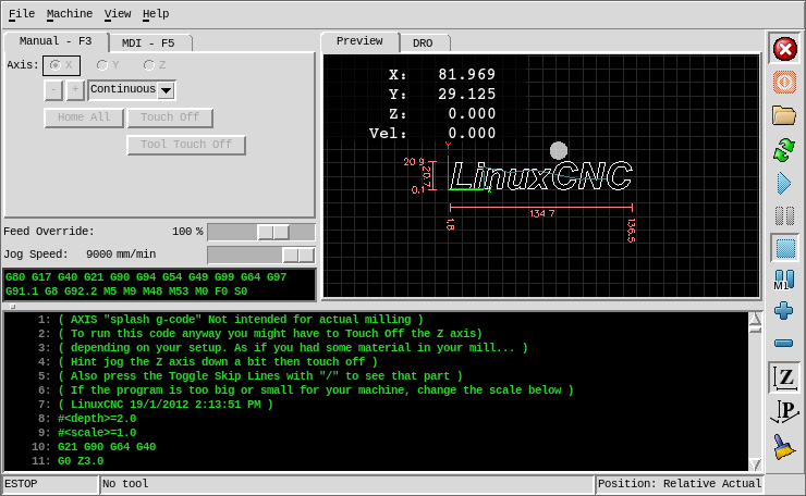

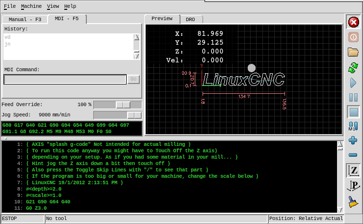

20 May 2020 01:40 #168337 by cakeslob
Replied by cakeslob on topic [solved]Axis for 800x480 screen w/ usercommand
Ok, I think Ive got it. Not finished but usable.
clocking in at 722x468, which is well within spec (800x480), and could probably go even smaller to make it 640x480 but I didnt adjust any width values
But, I had to remove the toolbar. Not a show stopper by any means, all the items removed are available through the drop down menus, and the main ones i usually have as physical buttons anyways. With the extra space on the sides, Im hoping to (learn how to) reframe the toolbar vertically along the side, looking at the plasmac vertical specifically for guidance. If reframing proves to daunting, I will try to do something with pyvcp, or qtvcp sidebar .
you still have 2 readable bars on the mdi, and can probably squeeze a few more out by playing with the vertical spacers a but more. None of my configs use the rest of the buttons in the manual tab (coolant,mist,spindle, brake), if a config does have these buttons, they will most likely be cut off because of what I have done to resize the top pane, if a config has a 4th axis, it will add an extra line in manual tab(wont change/affect anything) and feeds tab, feeds tab will break the sizing

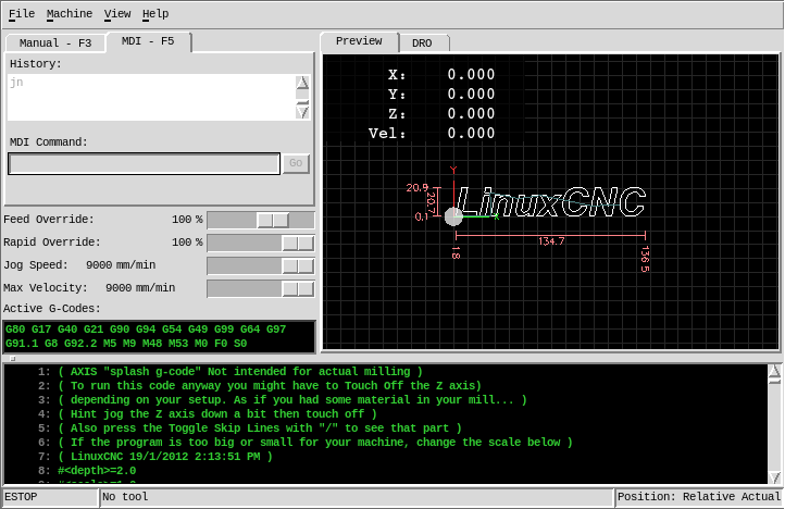

30 May 2020 00:35 #169372 by cakeslob
Alright, I have managed to do it all in the usercommand file, with some pixels to spare
Got it down to 722x468 , thats 12 vertical pixels extra. Unfortunately, I cannot find the correct path to take care of the vertical spacers in the mdi tab, so it will only show 1 history line. Im trying to use grid forget, but cant find the right path. Here is what I have so far

01 Jun 2020 06:39 - 01 Jun 2020 06:47 #169617 by cakeslob
I dont think its going to get any better than this,
min size, 740x456
pick and choose tool bar buttons, manual sliders, and gcode lines
########### remove manual buttons ########################
root_window.tk.call('pack','forget','.tabs_manual.spindlef.ccw')
root_window.tk.call('pack','forget','.tabs_manual.spindlef.cw')
root_window.tk.call('pack','forget','.tabs_manual.spindlef.stop')
root_window.tk.call('pack','forget','.tabs_manual.spindlef.spindleplus')
root_window.tk.call('pack','forget','.tabs_manual.spindlef.spindleminus')
root_window.tk.call('pack','forget','.tabs_manual.spindlef.brake')
root_window.tk.call('pack','forget','.tabs_manual.flood')
root_window.tk.call('pack','forget','.tabs_manual.mist')
######################## remove toolbar ##########
root_window.tk.call('pack','forget','.toolbar.machine_power')
root_window.tk.call('pack','forget','.toolbar.machine_estop')
root_window.tk.call('pack','forget','.toolbar.file_open')
root_window.tk.call('pack','forget','.toolbar.reload')
root_window.tk.call('pack','forget','.toolbar.program_run')
root_window.tk.call('pack','forget','.toolbar.program_step')
root_window.tk.call('pack','forget','.toolbar.program_pause')
root_window.tk.call('pack','forget','.toolbar.program_stop')
root_window.tk.call('pack','forget','.toolbar.program_blockdelete')
root_window.tk.call('pack','forget','.toolbar.program_optpause')
root_window.tk.call('pack','forget','.toolbar.view_zoomin')
root_window.tk.call('pack','forget','.toolbar.view_zoomout')
root_window.tk.call('pack','forget','.toolbar.view_z')
root_window.tk.call('pack','forget','.toolbar.view_z2')
root_window.tk.call('pack','forget','.toolbar.view_x')
root_window.tk.call('pack','forget','.toolbar.view_y')
root_window.tk.call('pack','forget','.toolbar.view_p')
root_window.tk.call('pack','forget','.toolbar.rotate')
root_window.tk.call('pack','forget','.toolbar.clear_plot')
root_window.tk.call('pack','forget','.toolbar.rule0')
root_window.tk.call('pack','forget','.toolbar.rule4')
root_window.tk.call('pack','forget','.toolbar.rule8')
root_window.tk.call('pack','forget','.toolbar.rule9')
root_window.tk.call('pack','forget','.toolbar.rule12')
root_window.tk.call('grid','forget','.toolbar')
###############  choose/remove sliders ########################
#root_window.tk.call('grid','forget','.pane.top.feedoverride')
root_window.tk.call('grid','forget','.pane.top.rapidoverride')
#root_window.tk.call('grid','forget','.pane.top.spinoverride')
#root_window.tk.call('grid','forget','.pane.top.jogspeed')
root_window.tk.call('grid','forget','.pane.top.ajogspeed')
root_window.tk.call('grid','forget','.pane.top.maxvel')
############ remove active gcodes lable and codes ##########
root_window.tk.call('grid','forget','.pane.top.gcodel')
#root_window.tk.call('grid','forget','.pane.top.gcodes')
########### move toolbar ###############
root_window.tk.call('grid','.toolbar','-row','1','-column','6','-sticky','nsew')
########### move/choose toolbar buttons ################
root_window.tk.call('pack','.toolbar.machine_estop','-side','top','-fill','y')
root_window.tk.call('pack','.toolbar.machine_power','-side','top','-fill','y')
root_window.tk.call('pack','.toolbar.file_open','-side','top','-fill','y')
root_window.tk.call('pack','.toolbar.reload','-side','top','-fill','y')
root_window.tk.call('pack','.toolbar.program_run','-side','top','-fill','y')
root_window.tk.call('pack','.toolbar.program_pause','-side','top','-fill','y')
root_window.tk.call('pack','.toolbar.program_stop','-side','top','-fill','y')
#root_window.tk.call('pack','.toolbar.program_blockdelete','-side','top','-fill','y')
root_window.tk.call('pack','.toolbar.program_optpause','-side','top','-fill','y')
root_window.tk.call('pack','.toolbar.view_zoomin','-side','top','-fill','y')
root_window.tk.call('pack','.toolbar.view_zoomout','-side','top','-fill','y')
root_window.tk.call('pack','.toolbar.view_z','-side','top','-fill','y')
#root_window.tk.call('pack','.toolbar.view_z2','-side','top','-fill','y')
#root_window.tk.call('pack','.toolbar.view_x','-side','top','-fill','y')
#root_window.tk.call('pack','.toolbar.view_y','-side','top','-fill','y')
root_window.tk.call('pack','.toolbar.view_p','-side','top','-fill','y')
#root_window.tk.call('pack','.toolbar.rotate','-side','top','-fill','y')
root_window.tk.call('pack','.toolbar.clear_plot','-side','top','-fill','y')
########## resize bottom pane #######
root_window.tk.call('.pane','paneconfigure','.pane.bottom',"-stretch","always","-height","200");
######### resize top pane ########
###### smaller manual frame /11 lines of gcode ########
root_window.tk.call('.pane','paneconfigure','.pane.top',"-stretch","never","-minsize","250");
##### bigger manual frame /7 lines of gcode #####
#root_window.tk.call('.pane','paneconfigure','.pane.top',"-stretch","never","-minsize","300");
########### window resize #########
root_window.tk.call(".pane","configure","-height","350");
########### display z plane in preview  ###########
commands.set_view_z()
########### window resize ##################
#root_window.tk.call("wm","geometry",".","700x440")
#root_window.tk.call("wm","geometry",".","800x480")
#root_window.attributes("-fullscreen",1)
# change the font
font = 'mono 8'
fname,fsize = font.split()
root_window.tk.call('font','configure','TkDefaultFont','-family',fname,'-size',fsize)
# redo the text in tabs so they resize for the new default font
root_window.tk.call('.pane.top.tabs','itemconfigure','manual','-text',' Manual - F3 ')
root_window.tk.call('.pane.top.tabs','itemconfigure','mdi','-text',' MDI - F5 ')
root_window.tk.call('.pane.top.right','itemconfigure','preview','-text',' Preview ')
root_window.tk.call('.pane.top.right','itemconfigure','numbers','-text',' DRO ')
# disable the do you want to close dialog
root_window.tk.call("wm","protocol",".","WM_DELETE_WINDOW","destroy .")
# change dro screen
root_window.tk.call('.pane.top.right.fnumbers.text','configure','-foreground','limegreen','-background','black')
#modal text
root_window.tk.call('.pane.top.gcodes','configure'
,"-font","mono 8 bold"
#gcode preview text
root_window.tk.call(pane_bottom+".t.text","configure"
,"-foreground","Limegreen"
,"-background","black")
Last edit: 01 Jun 2020 06:47 by cakeslob.
