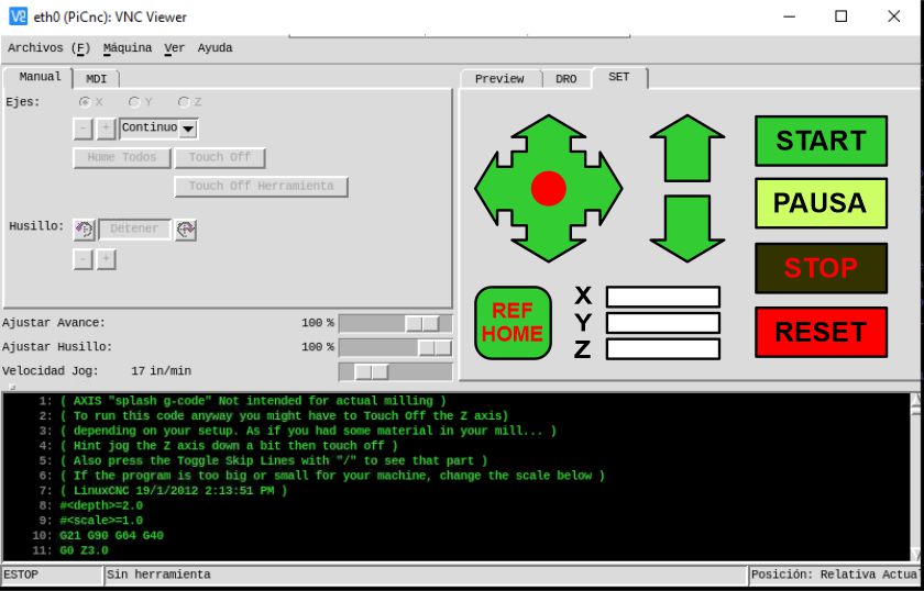

Hi there, after your help i was able to start with my own mods.
I plan to start with an extra tab for the basic functions of the machine, here is a small layout.
When I finish I make a small tutorial of how I did it so the post is more complete.
Please don't kill me, the graphic part was never my strong point..
... and is only a layout.
Thank you.!

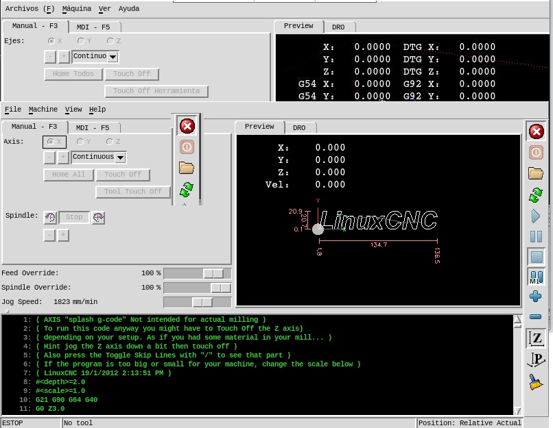

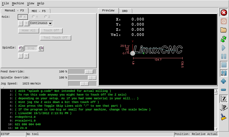

19 Apr 2022 12:43 - 19 Apr 2022 12:49 #240650
by geminis
Replied by geminis on topic [solved]Axis for 800x480 screen w/ usercommand
Ok:
If i try your usercommandfile just like you poste it, right side bar don`t show up. (fig. 1)
If, i add the line you posted ni previus message i get an error, but .... is just for a breack line jump, once i correct thats i have same result: "right side bar don`t show up." (fig. 2)
BUT: If i change mode from fullscreen to vw.geometry (800x480) al works fine, but now show entire screen, just a window.(fig. 3)

19 Apr 2022 22:19 #240692
by cakeslob
Replied by cakeslob on topic [solved]Axis for 800x480 screen w/ usercommand
Ok, thats cool if you like it more that way. lol no i dont speak spanish though. It looks like in fig2 the last part of the code line was missing. It is good to know the buttons showup, thank you.
