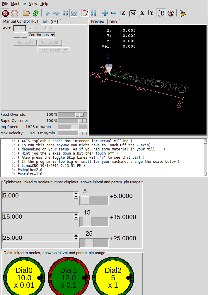

I'm looking to change my monitor orientation from Landscape to portrait so I can mount it on the side of my enclosure.
I'm using the Axis UI and have developed a ppvcp panel that sits in the default right side of the Axis display.
Is it possible to move the pyvcp location to the bottom either below or above the gcode window?
This would make a vertical display a more feasible option for me.

There is not an easy way to do this - it requires code changes - which may be possible using the .axisrc capability.
Just wait and maybe the AXIS guru will help you out...

Unfortunately because the relevant code is not in a function it cannot be changed from .axisrc
It is a simple code change in axis.py from:to:
A neater way would be to change it to:and have an optional PYVCP_POSITION in the [DISPLAY] section of the ini file requiring BOTTOM to effect the change.
Attached image is with the pyvcp-demo sample and would need to be reconfigured to suit the placement
Note that the line numbers above are correct for master branch.
3797 f = Tkinter.Frame(root_window)
3798 f.grid(row=0, column=4, rowspan=6, sticky="nw", padx=4, pady=4)
3799 vcpparse.filename = vcp3797 f = Tkinter.Frame(root_window)
3798 f.grid(row=4, column=0, columnspan=6, sticky="nw", padx=4, pady=4)
3799 vcpparse.filename = vcpA neater way would be to change it to:
3798 if inifile.find("DISPLAY", "PYVCP_POSITION") == "BOTTOM":
3799 f.grid(row=4, column=0, columnspan=6, sticky="nw", padx=4, pady=4)
3800 else:
3801 f.grid(row=0, column=4, rowspan=6, sticky="nw", padx=4, pady=4)
3802 vcpparse.filename = vcpAttached image is with the pyvcp-demo sample and would need to be reconfigured to suit the placement

Thankyou! This looks really good! Do you think this is something that might be worth committing to the tree? I'm sure I'm not the only one who would benefit from this code.

It probably is worth committing at least into master, it shouldn't break any existing configs.
Edit: github.com/LinuxCNC/linuxcnc/pull/685

Chris has merged this into master and will put it in 2.8 later. 2.8
linuxcnc.org/docs/devel/html/gui/pyvcp.html#sec:pyvcp-with-axis
There is also an example configuration.
