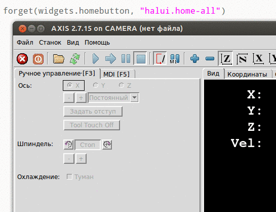

Is it possible delete home button on manual tab?
I would build a custom home cycle using pyvcp button and disable or delate home button on manual tab.

You would need to find the name of the button in axis.tcl, then you could have a .axisrc file or user_command file to hide the button.
linuxcnc.org/docs/2.8/html/gui/axis.html#_axisrc
linuxcnc.org/docs/2.8/html/gui/axis.html#_user_command_file
linuxcnc.org/docs/2.8/html/gui/axis.html#_hide_widgets

Work!
Thank you.
