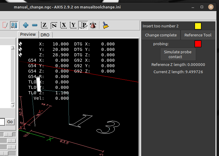

Hi all
Not sure this is the right place to post my problem. So, moderators, feel free to move it to the correct place.
I have a small three axis router that has a tool length sensor sitting idle for the last few years. I want to make use of it. So digging up the forums, I came accross "examples/sample-configs/sim/axis/remap/manual-toolchange-with-tool-length-switch" to get familiar with it. This "sim" just worked on 2.8.4. runing debian buster.
I upgraded to bookworm and 2.9.2. Same "manual-toolchange-with-tool-length-switch" does not work anymore. OK, using gitzip, I downloaded the latest source from github , unpacked in a new directory and ran it again, to no avail. I positively verified that all files downloaded *ARE* really the same as on github .
os: debian bookworm
LCNC: 2.9.2
user/group cnc:users
owner/group of manual-toolchange-with-tool-length-switch: cnc:users
when I run: "linuxcnc manualtoolchange.ini", I get the following errors (full messages attached)
Any help greatly appreciated
greez chris

- Posts: 4806
- Thank you received: 2163
01 Jul 2024 14:00 #304155
Replied by Aciera on topic manual-toolchange-with-tool-length-switch sim fails mill upgraded to 2.9.2
Not sure how far behind the bookworm package is but '/sim/axis/remap/manual-toolchange-with-tool-length-switch' runs for me on a 2.9 build from February:
Maybe updating from the linuxcnc.org sources would help:
linuxcnc.org/docs/2.9/html/getting-start...dating-linuxcnc.html
The following user(s) said Thank You: seuchato

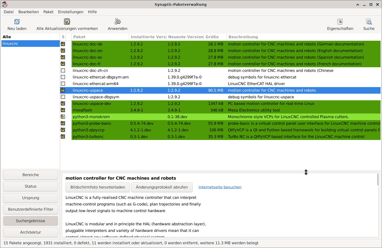

- Posts: 4806
01 Jul 2024 14:46 #304161
Not quite, what you get with bookworm is what has been sent to the debian organization at the time. There have been bug fixes in 2.9.2 since that are not in the current bookworm packages.To my believe, bookworm is as new as can be, so not "behind"
I was suggesting to change the linuxcnc package sources to linuxcnc.org instead of the official debian bookworm repositories. The link I posted should show you how to do that.So, would you like me to jump to 2.10x? Guess that's not released, yet?

01 Jul 2024 15:57 #304169
by seuchato
Replied by seuchato on topic manual-toolchange-with-tool-length-switch sim fails mill upgraded to 2.9.2
Aciera
Thanks for iterating. I AM on the latest version.
"cat /etc/apt/sources.list
deb deb.debian.org/debian/ bookworm main contrib
deb deb.debian.org/debian bookworm main non-free-firmware
deb linuxcnc.org/ bookworm 2.9-uspace base "
"linuxcnc
LINUXCNC - 2.9.2"
Guess, I am up to date
greez

- Posts: 12128
- Thank you received: 4140
01 Jul 2024 23:31 #304181
Replied by rodw on topic manual-toolchange-with-tool-length-switch sim fails mill upgraded to 2.9.2
You are up to date with what is in Debian but it is very old and out of date. Please read heading #7 in the 2.9.2 docss titled "Getting Linuxcnc" and follow those steps
