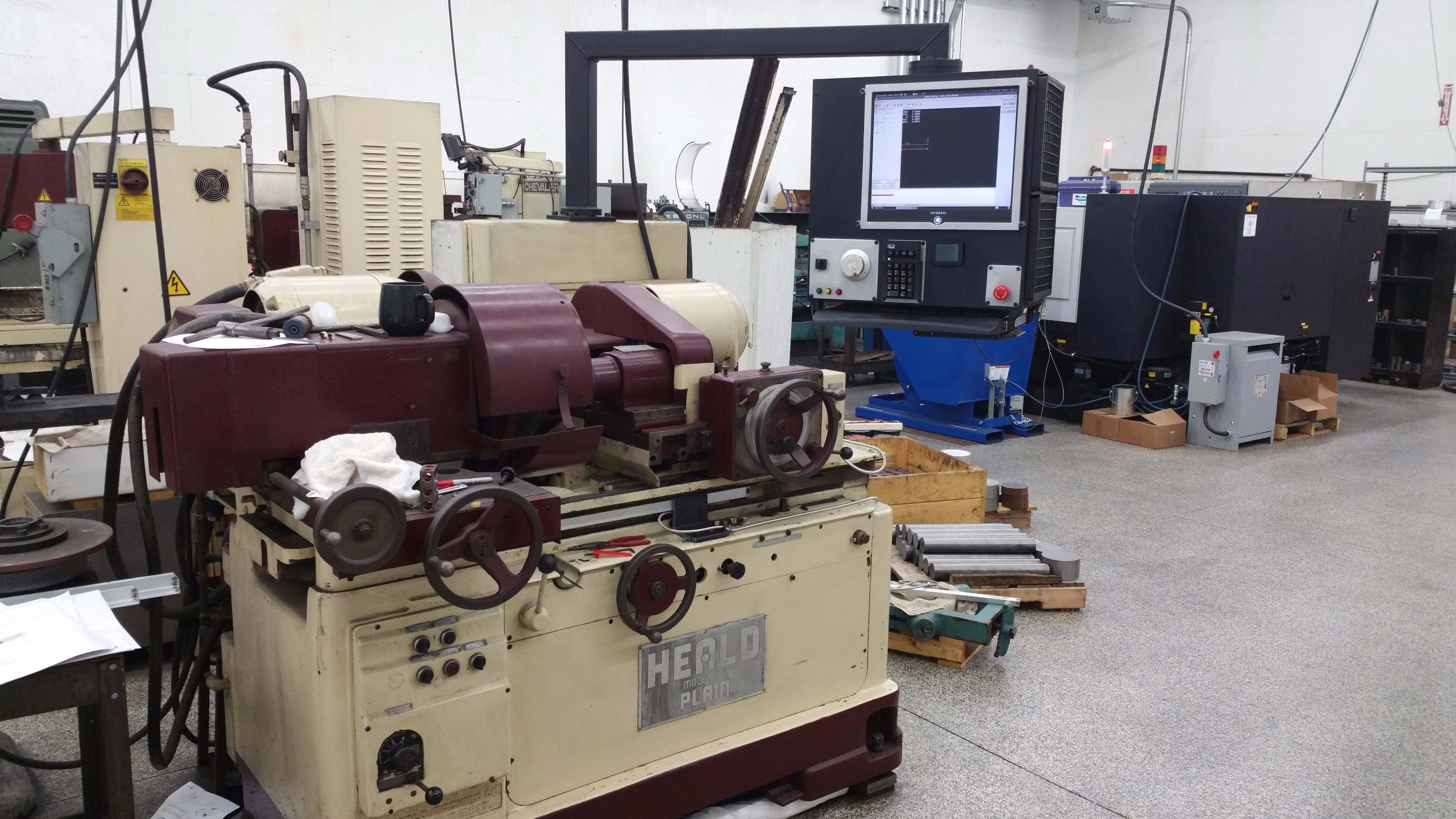

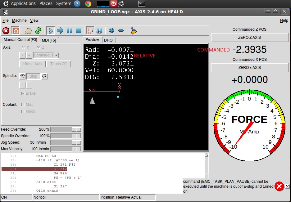

I am sprucing up an old Heald ID grinder project I did a while back and I have added some number displays in Axis via pyVCP. I am currently displaying commanded position of Z and X (lathe setup). I noticed the commanded position does not change when using the touch-off feature. Is this based off machine position? It seems to be Zero'd wherever the axis is at the point of startup.
Z axis - I would like to display the encoder position and commanded position for Z with a button that would zero off of the current encoder position.
X axis - The X axis is manual ( I wanted to put a motor on it but our grinder hand didn't like that idea ). Currently, when I use the touch off feature the axis is Zero'd off of the commanded position. I would like to display the encoder position and have a button to Zero the axis based on the current encoder position.
Is this do-able with pyVCP? Can someone point me in the right direction?
It should!
Is the GUI displaying Machine Coordinates or Relative Coordinates?
Maybe you need to net to the halui.axis.N.pos-relative pin?
I currently have the zpos-cmd pin displayed in addition to the standard relative coordinates. I would like to see both commanded position and actual relative position. This works fine other than the zpos-cmd never changes when I touch off or home the axis. It is at zero when I start LinuxCNC and I can't find a way to reset it other than to restart LinuxCNC
06 Jul 2017 14:55 #95434 by andypugh
Replied by andypugh on topic Display Encoder position with button to zero.
The encoder counters all have a reset pin. Link the GUI button to that? (you probably need to make the following error numbers enormous)
linuxcnc.org/docs/2.7/html/man/man9/encoder.9.html
encoder.N.reset
