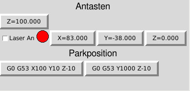

22 Jan 2021 20:23 - 22 Jan 2021 20:26 #196270
by chris@cnc
Replied by chris@cnc on topic pyVCP button to control generic digital out
not sure what do you want do with motion but i think you want enter some straight postion or switch on or off somthing.
I do also some off this and here my exmaple.
First button is for touching tool. I use a old style dial indicator and touch always 100mm top of the surface.
Second is for laser switch on and after find X and Y i set position. In my case not zero mounted.
And "Parkpositon" is drive to front or rearside.

<!-- Antasten-->
<label>
<text> "Antasten" </text>
<font>("Helvetica",14)</font>
</label>
<hbox>
<relief>RAISED</relief>
<button>
<halpin>"MDI-z100"</halpin>
<text>"Z=100.000"</text>
<bd>4</bd>
</button>
</hbox>
<hbox>
<checkbutton>
<halpin>"laser-an"</halpin>
<text>"Laser An"</text>
</checkbutton>
<led>
<halpin>"status-laser"</halpin>
<size>25</size>
<on_color>"green"</on_color>
<off_color>"red"</off_color>
</led>
<button>
<halpin>"MDI-x0"</halpin>
<text>"X=83.000"</text>
<bd>4</bd>
</button>
<button>
<halpin>"MDI-y0"</halpin>
<text>"Y=-38.000"</text>
<bd>4</bd>
</button>
<button>
<halpin>"MDI-z0"</halpin>
<text>"Z=0.000"</text>
<bd>4</bd>
</button>
</hbox>
<!-- Parkposition-->
<label>
<text> "Parkposition" </text>
</label>
<hbox>
<button>
<halpin>"Park-1"</halpin>
<text>"G0 G53 X100 Y10 Z-10"</text>
<bd>4</bd>
</button>
<button>
<halpin>"Park-2"</halpin>
<text>"G0 G53 Y1000 Z-10"</text>
<bd>4</bd>
</button>
</hbox>
</pyvcp>
