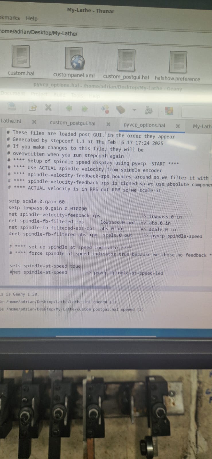

I have an old lathe that I run using linuxcnc with gmoccapy as the display.
I am trying to get the speed display working but it wont start and gives the error 'pyvcp_options.hal:16: Pin 'pyvcp.spindle-speed' does not exist'
If I '#' out that line and another one that gives the error 'pyvcp_options.hal:24: Pin 'pyvcp.spindle-at-speed-led' does not exist' then it starts and works as needed but I don't have the speed displayed.

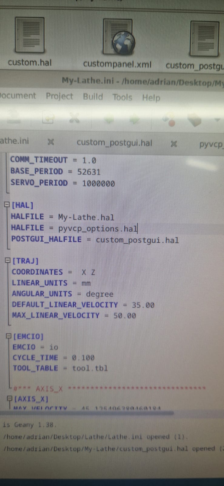

Gui related pins (ie gmoccapy and pyvcp related pins) do not exist until the gui has loaded. So you need to put those hal connections into the postgui halfile.

Thank you for the quick reply, I do appreciate it.
The gui does load for about half a second and then closes with the error. I have put the connections in the custom_postgui file but I'm getting the same result.

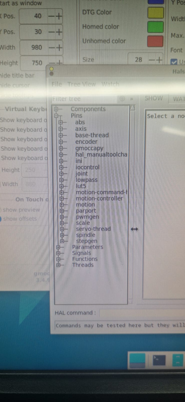

For troubleshooting, comment out the hal lines that connect pyvcp pins (ie those line that create errors) then start your config and use the 'Show hal configuration' tool to check if the pyvcp component has actually loaded and if it has what pins have been created.

Replied by Reddiamonduk on topic Error starting gmoccapy with spindle speed display.
If I comment out those 2 lines it starts fine and works as expected but the spindle speed and at speed led do not work.

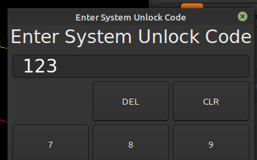

in gmoccapy, click on the settings button in the lower right:
You might have to put in the default code to enter the settings:
Once you are on the settings page click on the halshow button in the lower right:

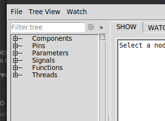

Once the halshow tool opens you can expand the 'pins' in the left hand panel by clicking on the + beside it and check for 'pyvcp'

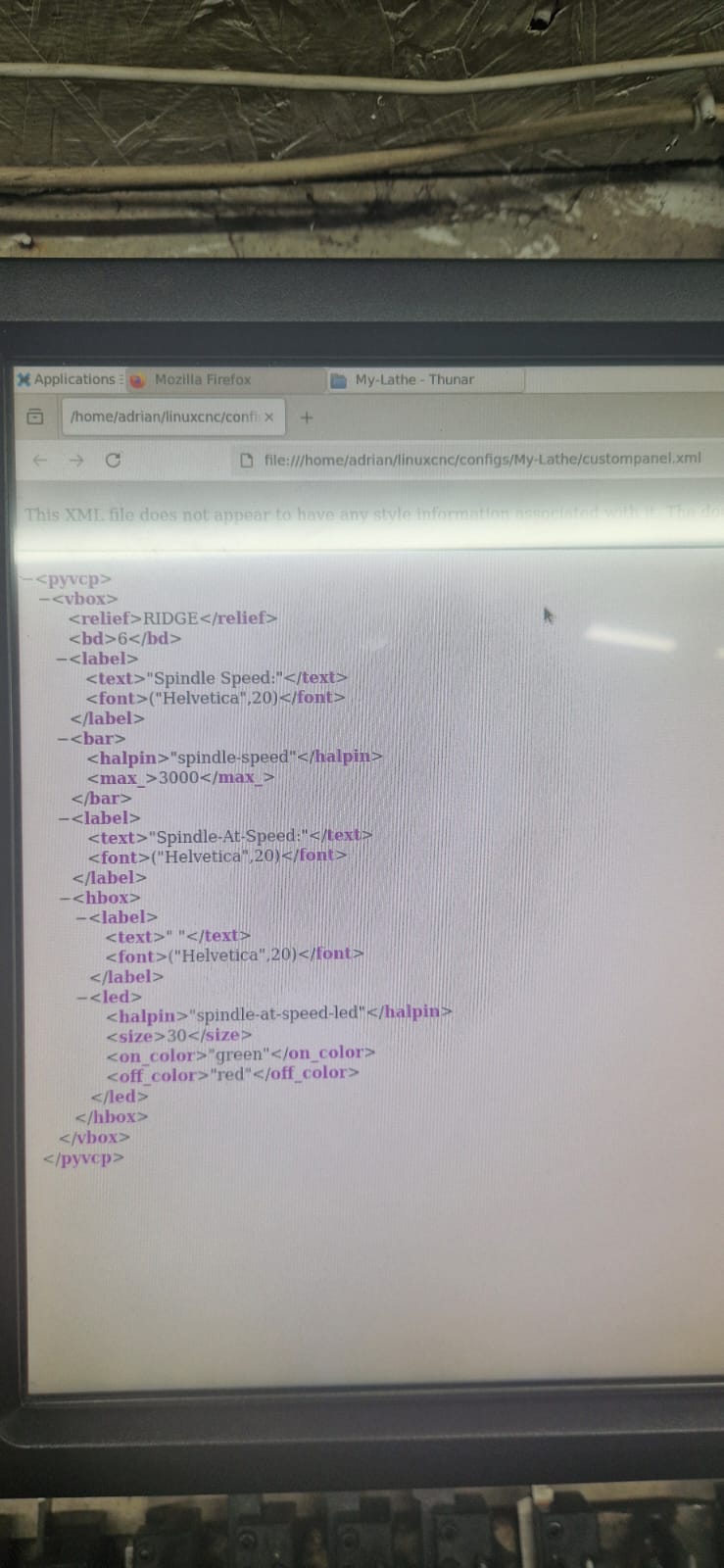

Oh, I just realized, 'pyvcp' panels are for the AXIS GUI.
Gmoccapy uses 'GladeVCP'
