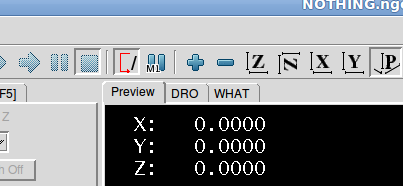

18 Jul 2011 18:21 - 18 Jul 2011 19:15 #11615
by piasdom
File to Edit to add backplot tabs was created by piasdom
Last edit: 18 Jul 2011 19:15 by piasdom.

well i found i edited the axis.tcl file to add the tab.
is this the wrong file since John said ini file ?

19 Jul 2011 13:46 #11646
by piasdom
Replied by piasdom on topic Re:File to Edit to add backplot tabs
cool, thanks. did all dat and i get unable to open file (simp,slot or iquad)
on either tab.just have the three. files are in those folders. can open file with
np. error is while opening this file /home/mill/emc2/configs/Axis/auto.ngc
ini
USER_COMMAND_FILE = tkapp.py
TKAPP = ngcgui_app.tcl
NGCGUI = ngcgui.tcl
NGCGUI_FONT = Courier -10 normal
NGCGUI_PREAMBLE = /home/mill/nc_files/in_std.ngc
NGCGUI_SUBFILE = /home/mill/nc_files/slot.ngc
NGCGUI_SUBFILE = /home/mill/nc_files/simp.ngc
NGCGUI_SUBFILE = /home/mill/nc_files/iquad.ngc
NGCGUI_OPTIONS = nonew noremove nonew
don't know why i can't find this(and others) in searching.
i do search before asking.
ini
NGCGUI = ngcgui.tcl

19 Jul 2011 13:58 - 19 Jul 2011 13:59 #11647
by BigJohnT
Replied by BigJohnT on topic Re:File to Edit to add backplot tabs
I'd say you have your path wrong... I'm guessing that it is /home/mill/emc2/nc_files/slot.ngc
The search function on this forum sucks and I never use it anymore. I use instead Google site search like this
Open up google and use this in the search bar.
stuff I'm searching for site:http://www.linuxcnc.org
This has the advantage of also searching the wiki site and other EMC resources.
John
