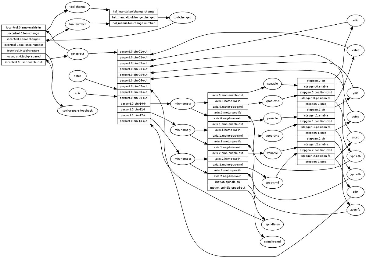

I'm learning some python and I needed a quick hack to get a visual map on hal nets, so I made this little python script that reads input from "halcmd show" and outputs a graphviz file. Maybe you will find it useful.
You need to:
1) install graphviz, using "sudo apt-get install graphviz"
2) download the hal_sigs_graphviz.py attachment in a directory of your choice.
3) make a shell script inside the same dir, with the following lines in it and run it:
Attached is an example of what I get when running it with my (stepconf generated) hal configuration I use on my first cnc router. Tables are components and circles are nets.
I will probably add more features like colors and some fine tuning on how graphviz outputs the image, when I find some time to learn more about this excellent application. But it's probably good enough for a quick visualization as it is now.
You need to:
Code:
halcmd -s show pin | grep "==" > pin.out
halcmd -s show sig | grep -v "^$" > sig.out
python hal_sigs_graphviz.py > gv.in

Forum does not let me attach a .py file, so I renamed it as .txt. You need to rename it back as a .py
I also had to resize the image file. image missing http://www.linuxcnc.org/media/kunena/attachments/legacy/images/gv_resized.png

Okay, okay, I did! It's definitely more useful for looking at small sections of the HAL.
The whole thing is a little too much for the tool, but if there's a subset that you're trying to understand better, it's definitely useful.
Thanks for writing it -- I found it because I was setting out to do the exact same thing, also using graphviz, but decided I should look around to see what was already available. You saved me a bunch of work!
