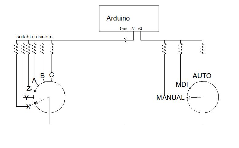

Hi I have a question about saving inputs.
I have an Arduino connected
and intend to use a rotary selector switch
with resistors,
is it possible to take an analog signal to
for example axis select.
1 volt = x axis, 2 volt = y axis, and so on.
Is there anyone who have a hal example
I would be happy.
with resistors,
I would be happy.

I use Jeff Eplers configuration for arduino.
What I was thinking is to connect one analog signal
from the Rotary selector switch and let the hal file
read the float value and change the signal halui.joint.0.select,
to halui.joint.1.select. and so on.
And maybe one analog signal for manual,mdi,auto mode.
If it is possible, it would save many iputs.
I know it is possible to write your own configuration for arduino
but I'm not good at programming.
So I thought there might be a way to do it in the hal file.

HAL does not use analogue voltage signals much, then mostly in the area of drive control.
Afraid I think my initial reaction stands, makes little sense to implement an switched analogue signal and then convert it, when what you want is a digital one, which is easily achieved.
You can implement the switching within HAL, using something like the multiswitch component or just have a plain mechanical switch.
The advantage of switching within a component, is that you can connect all the halui........ pins to it directly and the position of the 'switch' determines which is triggered.
Manual, MDI, Auto mode can similarly be toggled in HAL using physical or HAL switches
See this for example
www.linuxcnc.org/index.php/english/forum...t-playing-nice#29216
To get this working, you may need to wet your feet in the programming sea, but I still don't know overall what you are trying to achieve or what part the arduino plays
regards

- ericson
- Posts: 23
04 Apr 2013 02:55 #32244
by ericson
Replied by ericson on topic analog axis select
Thanks for the examples they will be useful.
I complicate it because I've run out of inputs
and would like rotary switches on my machine panel
but should probably reconsider.
look at the picture to see how I thought
Thanks for the replies.

Hi
Your picture is fine, as far as it goes.
The only proper way to use an arduino and save on inputs is to have a component that receives the return from the arduino and sets the appropriate pin, connected via HAL, to HIGH.
The arduino will do the ADC (Analogue to Digital Conversion) easily enough into a 10bit ADC
You would need to experiment to determine what value range each pole on the switch resulted in.
The below give an idea of the code required, they compile, but I have not tested the logic.
They may inspire you to get your feet wet on the programming front
ADCsend.pde (arduino script)
ADCreceive.comp (userspace hal component)
regards

- jorgea
- Posts: 1
05 Aug 2013 05:16 #37403
by jorgea
Replied by jorgea on topic analog axis select
Have you fixed this problem?
- Posts: 23527
- Thank you received: 5005
06 Aug 2013 19:12 #37434
Replied by andypugh on topic analog axis select
I only just spotted this thread.
I thought that the Arduino interface from Jeff already handle analogue input, so shouldn't it be possible to just use a wcomp component in HAL for each desired voltage range to set the associated HAL pin?
