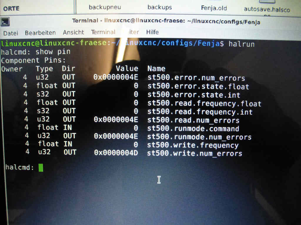

THIS SIR! Thank you. I tested the handwheel XHC-WH04b after compile with the console which worked. I did not notice that I had to switch to the config directory for the VFD because of the mb2hal.ini file to start the whole thing with the console.
Now i can see the error`s after using show pin.Now i hope i can sort this out to get this VFD work with Linuxcnc 2.8.

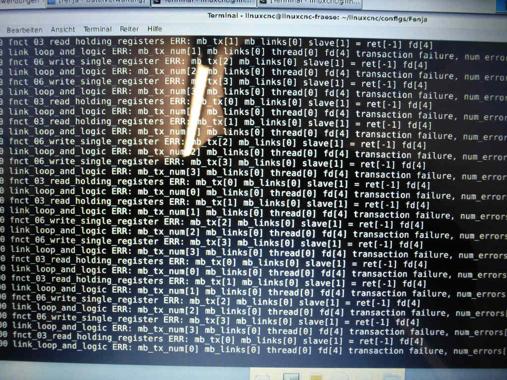

I'm currently still stuck. I can display the VFD pins in the terminal, so linuxcnc can theoretically access the VFD. The problem is that when loading the mb2hal.ini the VFD hangs in a loop.The config and hal file are still being processed. Would be good if someone could give me a hint where I have to start or what I have to change for Linuxcnc 2.8

Looks like a comunication error. It could be a physical problem, with the wiring or termination, a configuration problem with in the drive, or wrong settings in Linuxcnc. (really just about any thing.)
First thing to do is research you drive's manual to see how to configure it for modbus control (most drives require you to set several parameters to enable it), and find out what it's port settings are/should be (baud rate, slave id, parity bits, stop bits, data bits, register addresses...). Then you need to make sure that you've setup Mb2hal to use those exact same settings.

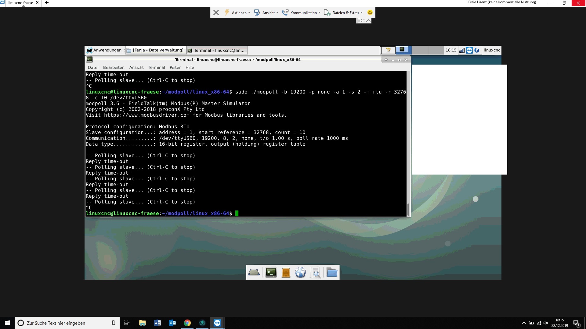

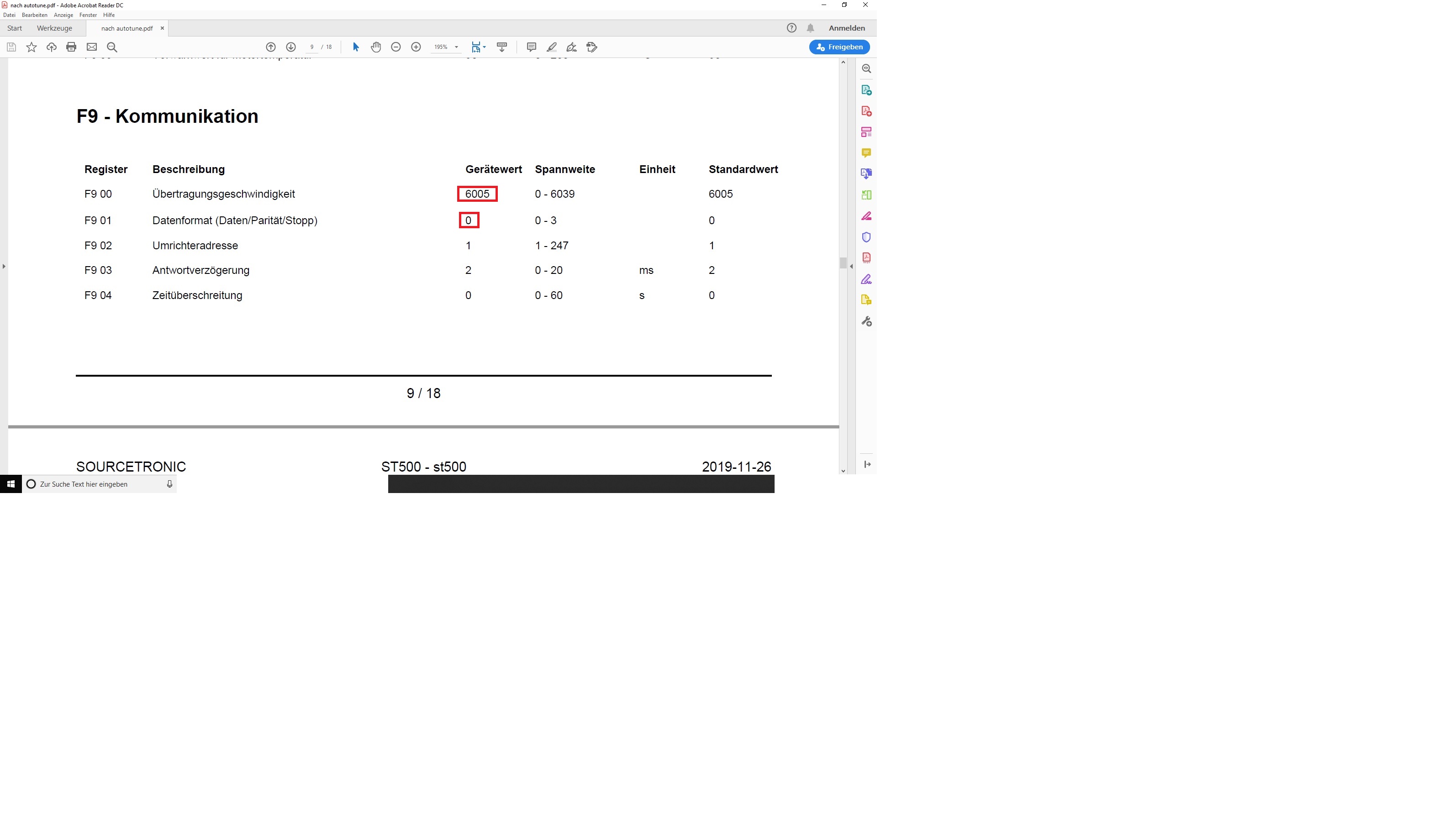

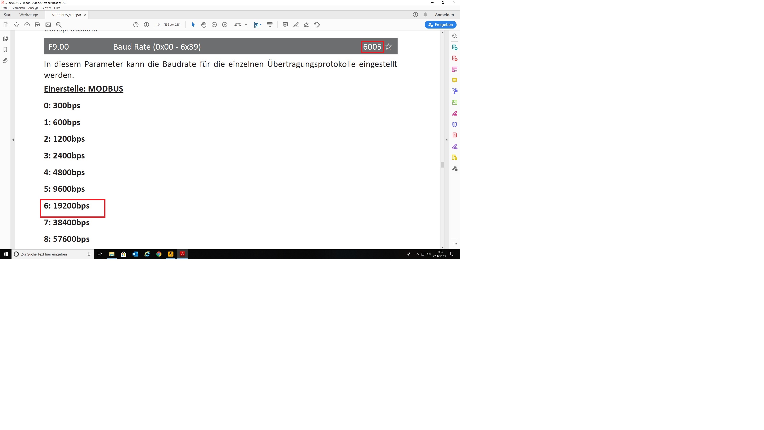

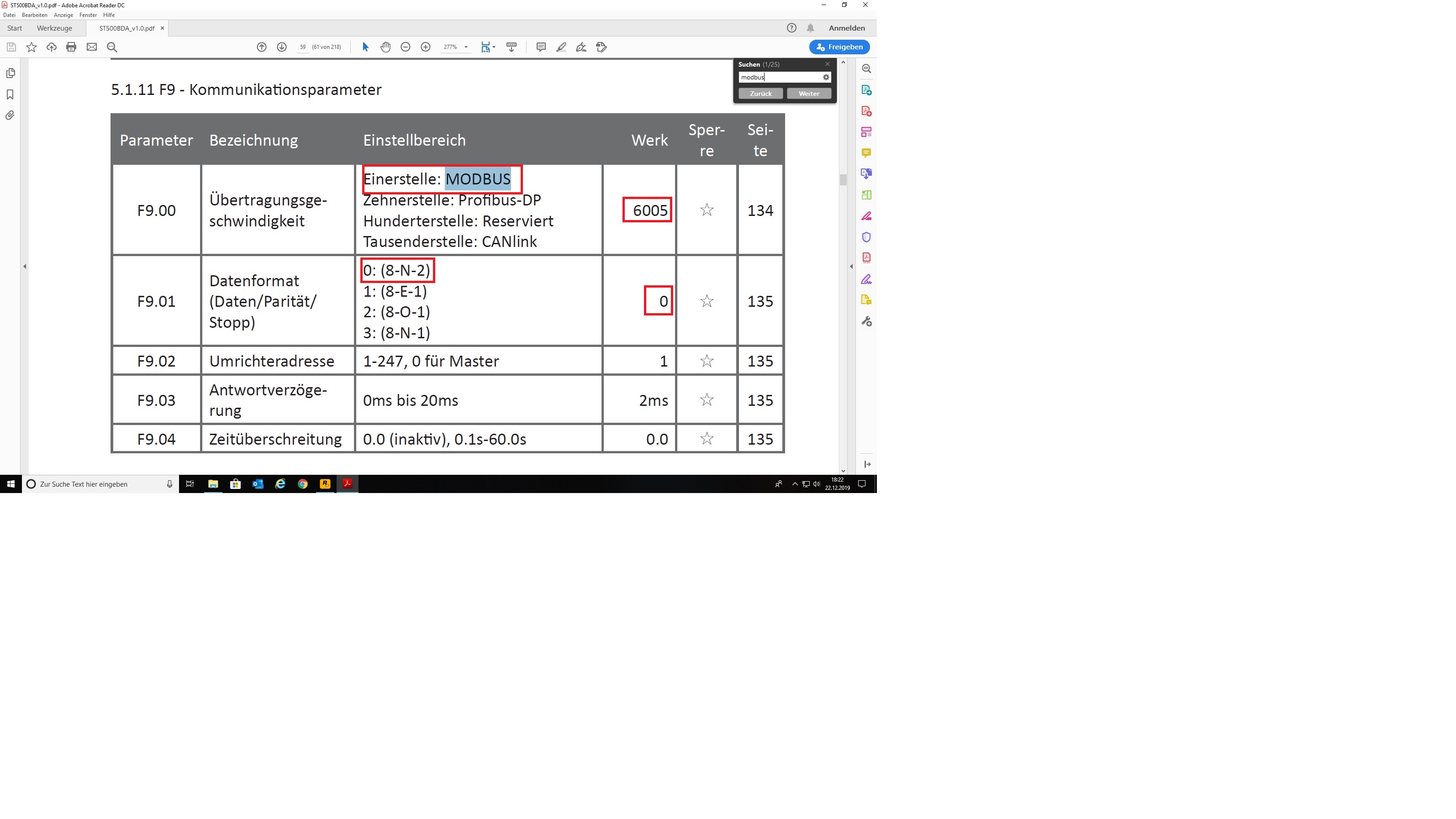

I tested the settings with Modpoll and I am a little confused about my VFD. My VFD is not responding to Modpoll. In the pictures I marked the setting from the manual for Modbus and the current setting for Modbus on the VFD. A screenshot is from Modpoll. Maybe some have a Powtran or Sourcetronic and can send me a setup that works with Modbus for comparison.I can use the USB cable from the manufacturer to make settings from a PC with software purchased from the manufacturer. So the cable should drop out as an error.As soon as I have solved this problem, I will report how the setup in the HAL continued. Merry Christmas

You are running on wrong speed use 6006 ( modbus is on last digit)
Mike
P. S.
2 ms wait could be a bit short to. If you get some tines errors try to increase that time
Mike
P. S.
