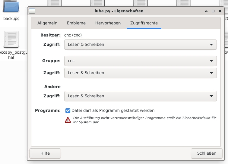

Hello, I see the post is a few years old, I'm still trying to get help here.
Our Emco is currently being rebuilt and that's how we came up with the lubrication cycle.
I tried to enter the lube.py into the hal according to the instructions above and only got the error
i have done the file path in the .hal
to
loadusr -W /home/cnc/Schreibtisch/EMCO_120_CNC/lube.py
I have done make it executeable and given all rights
and in the last section then will be the dbug information
Please what have i done wrong,
ps:Please excuse my bad English, it is not my native language
thank you and have a nice day and greetings from austria

Code:
Debug file information:
Note: Using POSIX realtime
./EMCO_120_CNC.hal:13: execv(/home/cnc/Schreibtisch/EMCO_120_CNC/lube.py): No such file or directory
./EMCO_120_CNC.hal:13: waitpid failed /home/cnc/Schreibtisch/EMCO_120_CNC/lube.py lube
./EMCO_120_CNC.hal:13: /home/cnc/Schreibtisch/EMCO_120_CNC/lube.py exited without becoming ready
15801
Stopping realtime threads
Unloading hal components
