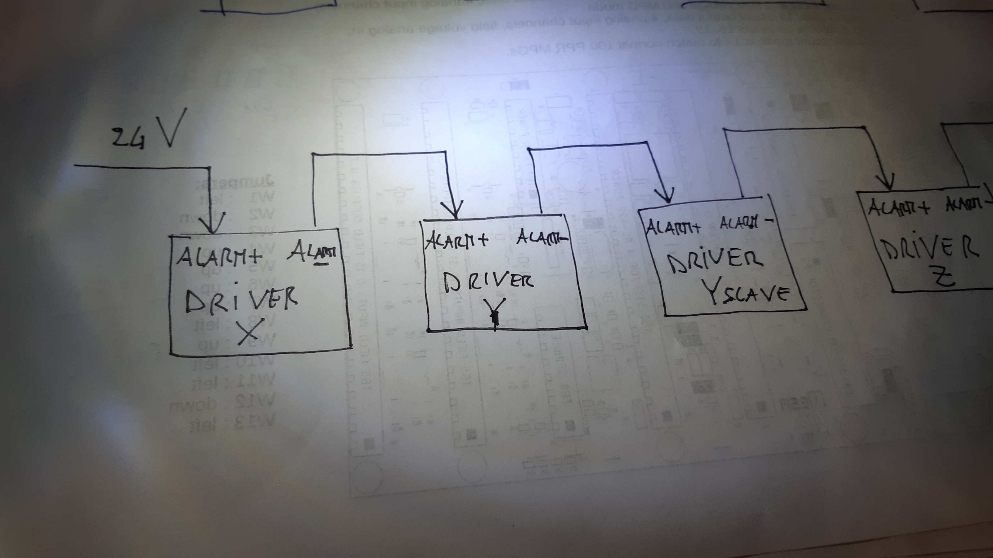

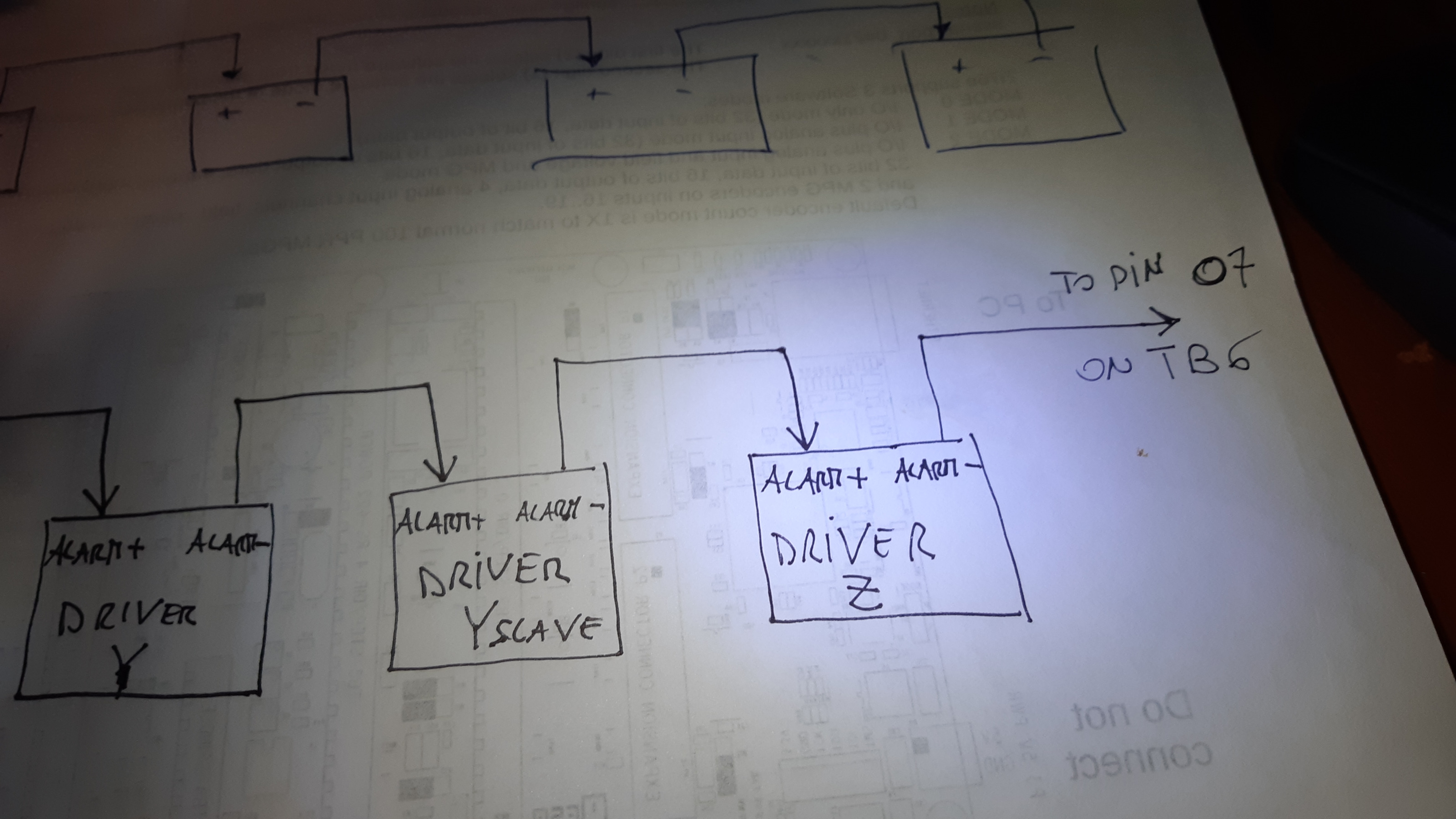

Good evening everybody
I have some question about the alarm set on my drivers HSC86A.
This type of driver has an alarm circuit that can be activated if something goes wrong.
From my pics you can see how I wired together all my drivers, so basically I have a 24V input and all the driver are in series and on output at the end of last driver that goes into a pin 07 on TB6.
I saw that you can use this type of signal axis.N.amp−fault−in IN BIT and I think that I understood how to set one of this signal in case I have 3 output returning to three pin.
But my case is different.
Can anyone direct me in the right direction?
Thanks in advance for any help.

It depends on how you want to have this handled really. You could just wire your serial fault signal to a single axis.N.amp−fault−in pin or to all of them in the first case your machine will stop indicating a fault in the axis you happend to attach the signal to in the latter the machine will stop with an indication that all axis have a fault.
Or you could bring the signal into your estop chain and maybe trigger a custom error warning. This also depends on what GUI you use.

Amp fault should be separate for each joint/axis so you know what axis faulted, if there are free inputs and it looks like you do.
I have them separate and they work perfectly on rare occasions they trip, the mesage is shown on screen and drives are disabled to prevent damage.

Thanks very much
I'm thinking to spend another meter of cable wire to separate them.
