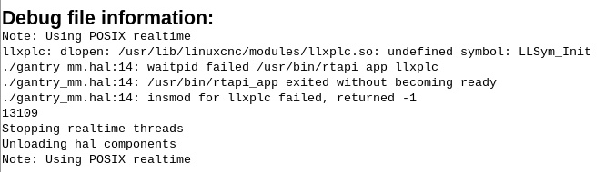

10 Mar 2021 17:54 - 10 Mar 2021 18:11 #201669
by udoS
Replied by udoS on topic halcompile shared lib
as you see in llxplc.comp line 68 - 86 is commented out.
Like this Lcnc starts fine and timer tiks.
else I get an error at startup of Lcnc
I was reading this
www.forum.linuxcnc.org/24-hal-components...my-hal-comp?start=10
but did not get any further.
attached the error window;
I was reading this

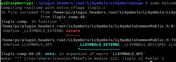

10 Mar 2021 18:45 #201680
by udoS
here it comes

10 Mar 2021 19:15 #201689
by db1981
Replied by db1981 on topic halcompile shared lib
linking work, include works, i not shure how the LL? libs got linked.
try an "LLSYMBOLS_API" in front of the function call LLsym_init(),
like in line 65.
all public functions got an LLSYMBOLS_API prefixed in the header file.
like in line 65.
- udoS
- Posts: 216
- Thank you received: 25
10 Mar 2021 19:54 - 10 Mar 2021 19:56 #201691
by udoS
attached the errors
One thing I like to mention: as you can see in the llxplc3.comp these calls are working fine for the uspace module.
by the way... thanks for looking into it. I'm really stuck with this.
best regards
udo

- db1981
- Posts: 790
- Thank you received: 276
10 Mar 2021 20:30 #201704
by db1981
oh, there's a macro.
okay, then coding seems right, my belly thinks it's an execution / startup thing....
for testing put the code line 69-86 in a if construction triggerd by an hal bit, and check if linuxcnc starts. after linuxcnc is fully running set the bit and check for crash....
i gues the rt's code is running before the all other modules finished initializing.
