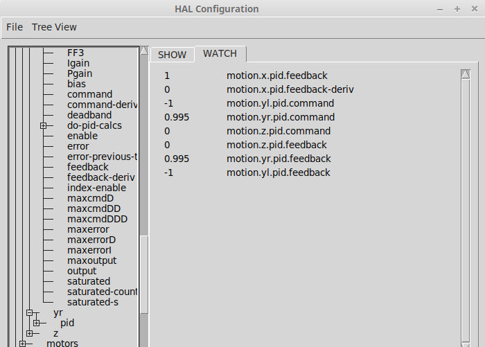

26 May 2021 08:13 #210315
by Stormholt
Replied by Stormholt on topic RT component millkins_xyz never becomes ready
if i understand your question correctly, then no
using a skew value of -0.005 and using g53 g0 x1, y1, z-1
x feedback is 1 (because y subtracts and z adds)
yr(right) is 0.995 (corrected by z as it should be
yl(left) is -1 (not corrected)
26 May 2021 08:28 #210319
Replied by andypugh on topic RT component millkins_xyz never becomes ready
I think you are using signal names? Those are specific to your config and so are not telling us very much.
Have you looked at the kins file itself? It is pretty easy to see what it does, but for a dual-motor gantry you need to put the right numbers in the joint outputs. (and return "Both" in KinematicsType)

26 May 2021 08:51 #210321
by Stormholt
Indeed they are specific to my config, however they are pins from a PID component that doesn't do anything in regards to pid.
Im sorry, i dont understand what is you mean by "kins file" and whether millkins output the position into two joints.
using trivkins i did use the kinstype BOTH, and i understand that is not supported with millkin_xyz, but it should be modified to do so.
