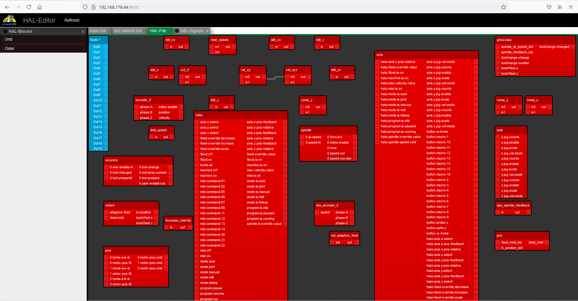

Hi together,
in this Thread i want to show some work in progress and collect some ideas to deal with unsolved issues.
There are some current Threads about HAL visualisation like halviewer but for users wich are new to lcnc it´s not very easy to deal with HAL.
For that reason and for easy debugging a graphical representation of the complete HAL environment would be very nice.
Current Features:
  • Show HAL Component Instances
  • Connect Component Instances with Drag and Drop
  • Show all available HAL Components with description
  • Add Instances of  Components to HAL with Drag and Drop (multiple instances not supported)
  • Show HAL Values of Signals
Planned Features:
  • Generate and edit HAL Files
Now the Repo is available on Github: github.com/dev-git-usr/HAL-Editor
But pay attention - it´s only a proof of concept, it may crash your LCNC instance -> don´t use in production environment.
Ideas and feedback is also very welcome.

11 Jul 2021 11:25 - 11 Jul 2021 11:28 #214244 by mic
Replied by mic on topic UI for HAL development
It´s going on in small steps as you can see in the Video:
www.dropbox.com/s/fid4uskzyyuoulf/HAL-Editor_small.mp4?dl=0
now it´s possible to view Manuals, add and remove Components to HAL an connect them by Signals...
At the moment i have some trouble adding multiple instances of a Component like "loadrt and2 count=3" - HAL does not support adding an instance if another instance of a component does already exist.
Question to some experienced HAL-Guys: Is there a possibility to deal with adding Components at Runtime?
Could I use a workaround like removing the Component and adding the needed count of Instances and connect the previous existing ones again or are there some pitfalls?
Thank you very much.
