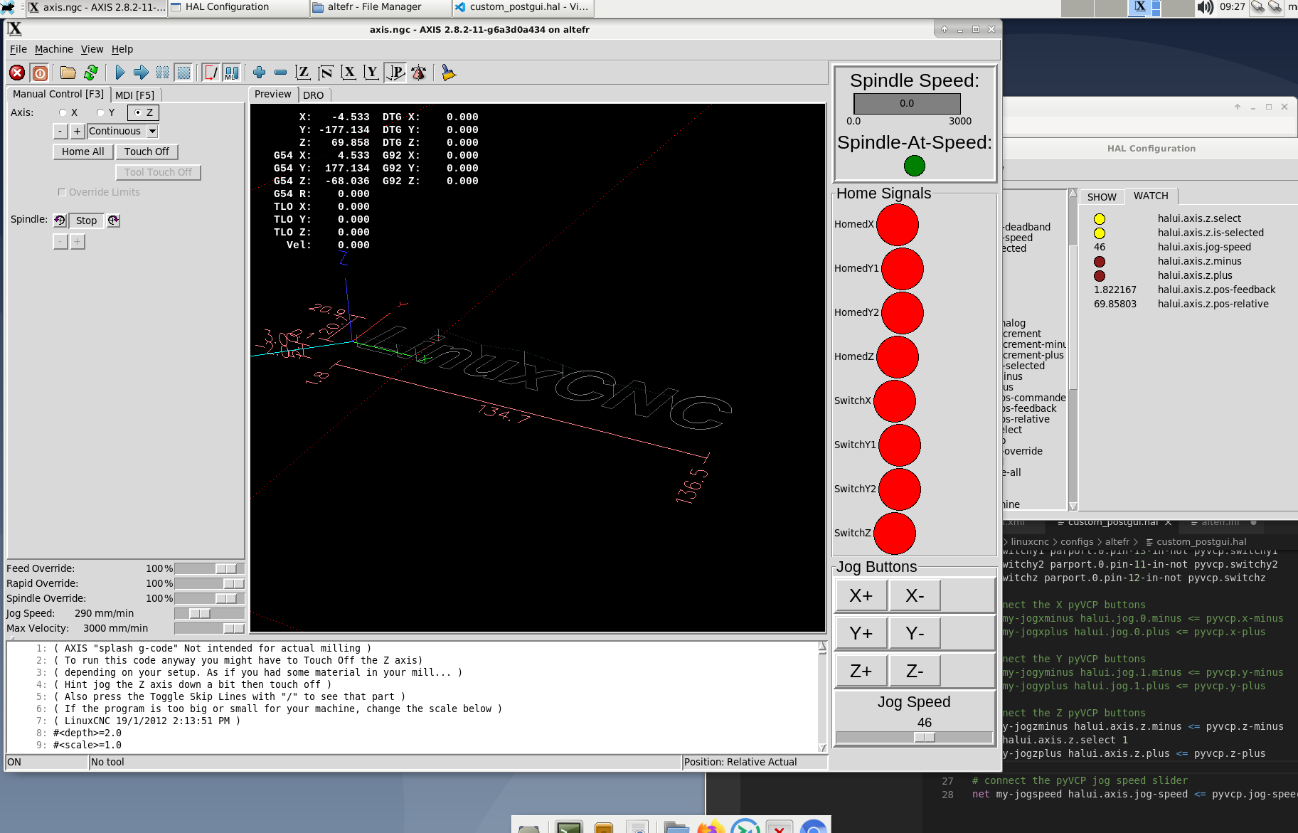

Hi all,
a bit background: I did set up 2 machines with LinuxCNC both are running great. Awesome software. Now I want to get a bit deeper into LinuxCNC and try to set up an Axis User Interface. Following this example linuxcnc.org/docs/2.4/html/hal_pyvcp_examples.html#r1_3_1
When I used Stepconf, I didn´t know what HalUI was and didn´t check the checkbox. I added it manuall and tried to add it in the INI as well as the hal file as described here linuxcnc.org/docs/2.6/html/gui/halui.html
I am using Axis as my gui.
Now my problem is: I see in the halconfig that halui was loaded, but non of the pins is connected to any of the pins in axis. In fact the pins from the first example halui.jog.0.minus is not existing at all. I used hallui.joint.0.minus but it is not working. If I watch the hallui pins, non of those pins has any reaction if I click on any Axis button.
What am I doing wrong?

Ok, so I am having really trouble understanding that. I thought any GUI which runs ontop of linucCNC is sending it's commands to the HAL. From there the HAL takes over and sends it to the hardware.
For example, if I use Axis as the GUI and look at the Z Jog button. I should be able to find this button somewhere in the HAL Configuration.
If I look in the HAL Configuration I see that there is a section axis and axisui. If I follow those trees to the Z axis and watch all signals I don't see the jog button. So how is LinuxCNC moving the axis if I click on the Z Jog button? I see that the axis is moving, because the machine is moving, but I don't see the signal flow on the computer.
Then I tried to add a Jog button using a custom pycvp and connected this button to the halui. I see that the connection works, but the axis is not moving.
This is my postgui.hal file.
# connect the Z pyVCP buttons
net my-jogzminus halui.axis.z.minus <= pyvcp.z-minus
net my-jogzplus halui.axis.z.plus <= pyvcp.z-plus
What I don't understand: If I click the jog button on my panel, the signal gets in the halui.axis.z.* I see that this works when I watch the signals on the hal configuration. But how does LinuxCNC know that halui.axis.z.minus means that the z axis should move down. Do I need to configurate that??

I am sorry, I still can´t get it to work. I have a float from my custom panel connected to halui.axis.jog-speed. Furthermore I set halui.axis.z.select 1 and connected the two buttons to halui.axis.z.plus and minus. I see in the Hal Configuration that all signals are working, but the machine is still not moving. It works fine when I use the jog buttons on the Axis GUI.
Here is the configuration in the postgui.hal
setp halui.axis.z.select 1
# connect the pyVCP jog speed slider
net my-jogspeed halui.axis.jog-speed <= pyvcp.jog-speed-f

Is the machine homed?
Before homing you can only jog in joint mode (ie, using the halui.joint.jog... pins)
If Axis is showing joint numbers rather than axis letters during your test then that will be the issue.
(If you want to jog in both modes, thenis valid syntax to drive both pins.
net my-jogzplus halui.axis.z.plus halui.joint.2.plus <= pyvcp.z-plus

My machine is not homed. But it shouldn't be necessary to home the machine, since I can use the axis button to drive the machine Z axis. (I only test the Z axis at the moment )
I tried already what you said with connecting halui.joint.2.plus <= pyvcp.z-plus without the addition of halui.axis.z.plus. It didn't work.
Now, I just tried exactly your suggestion net my-jogzplus halui.axis.z.plus halui.joint.2.plus <= pyvcp.z-plus and I see the pins in Hal Configuration act as they are supposed to be, but the machine does not move.
In the documentation it says halui need to find the nml find specified in the INI. Neither in the INI nor in the config folder I see anything like an NML file. Could that be the issue?

The Axis GUI swaps from joint to axis automatically. That might be the difference.My machine is not homed. But it shouldn't be necessary to home the machine, since I can use the axis button to drive the machine Z axis. (I only test the Z axis at the moment )
As well as operating the joint / axis jog+ you might also need to set the halui.joint.jog-speed pin too.
