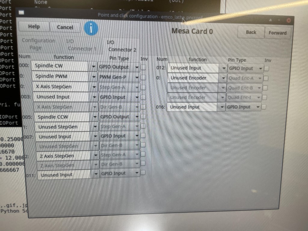

Hello All,
I'm struggling in my early journey to learning linuxcnc. I recently purchased an emco lathe conversion with a simple c11 breakout board ( manual here)
I'm not sure the next steps I need to take. Pncconf shows me two connectors, each have an 'unused pwm' signal. I'm guessing I pick the connector 1 item & then two unused inputs for the forward and reverse functions for the vfd. Does it matter which 'pin' I pick?
From all I read, pncconf only gets you so far and you need to dip into HAL hand editing. I watched a few videos but it isn't clear to me what items I need to edit. What is my next step?
So far I have I flashed my mesa board with 7i92_C11Gx2D.bit file successfully, and have been able to get both axes, x and z moving under there own power.
Thank you to all willing to help.
Dan

You need this so that the PWM step/dir outputs etc appear on the correct pins to drive the C11 board.
There are a couple specific firmwares for the C11. You probably want "7i92_C11Gx2.bit"

The spindle control looks like it ought to be working, assuming that the C11 is connected to the same pins as the PWM module.
There is the skeleton of a spindle PID but that seems not to be included in the loop at the moment (which is fine)
If you MDI "M3 S1000" and look at the PWM duty cycle and enable in halshow do you see what you would expect?

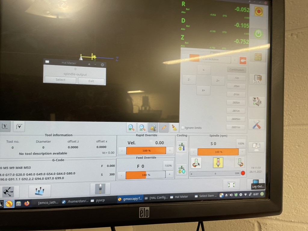

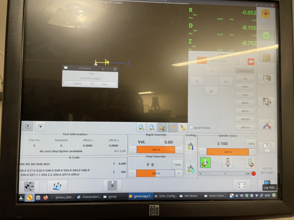

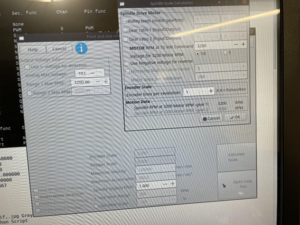

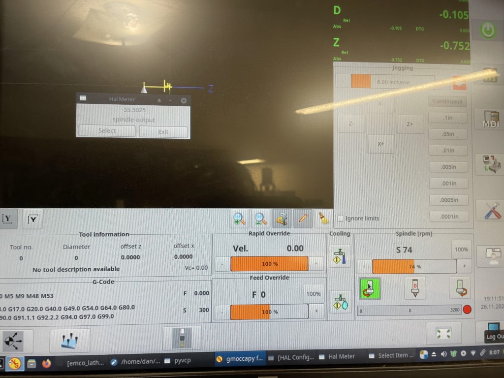

Hi Andy,
I was able to look at this some more tonight.Some developments so far - I was able to 'wire up' a couple more outputs via pncconf and got the spindle fwd and rev functioning. From gmoccapy gui I can start and stop the spindle. However I don't have spindle speed control
A couple things first - I was looking at how my vfd was wired to the c11 breakout boards 0-10v terminals. Originally the c11's 0-10v pin was connected to vfd "Ai1" (Analog input 1), and the c11's ground (next to 0-10v) to vfd 10v terminal. That didn't make sense to me so I switched the ground from the c11 to be connected to the ground on the vfd. After the change, no success after a test and adjusting the spindle percentage slider.I did however experience at some points an 'UU' error on the vfd. Research tells me this is under voltage error on the input (odd?)I also decided to put a multi meter across the ground and 0-10v terminals on the c11 bob. Turn the spindle on in gmoccapy, I'm reading around .144vdc regardless of on/off. Pretty sure I should be getting alot more voltage - this leads me to believe the pinouts on the mesa aren't connected to the c11 correctly virtually (more likely) or via hardware (unlikely?).
Now, on the hal meter side. I'll confess, I don't totally understand what parameters I should be monitoring to show fault or function. I snapped a couple pictures of and posted here.

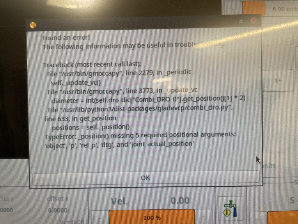

-2 potentially unrelated items to getting the spindle functioning:
1. Image 5 appears when I start linuxcnc for the first time using my profile. I don't recall if it happens immediately or only once I start jogging axes / spindle

27 Nov 2021 21:29 #227777
Replied by andypugh on topic Emco lathe - c11 breakout + 7i92 help with spindle setup
In the pictures I see that the spindle speed is showing -100.
Try starting the spindle in the other direction.
You probably want to link to the absolute speed output from motion.
( spindle.0.speed-out-abs ) and then switch the VFD direction separately (if you even plan to support reverse rotation)
