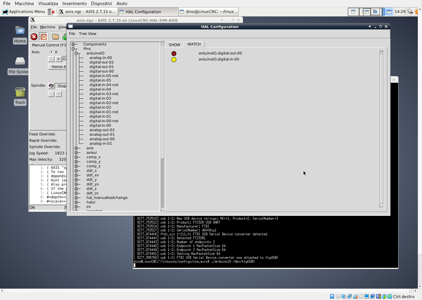

Hello,
in this days I have hacked the Jeff Epler's Arduino HAL (emergent.unpythonic.net/01198594294) and rewrited all the Python and firmware code to have a new HAL that can read (for now) max 32 digital bits in, 32 analog values in, 32 digital bits out and 32 analog values out.
If someone wanna test it i'll be happy to know his opinion
All the code can be found on my github github.com/DinoMesina/arduinoIO
Dino

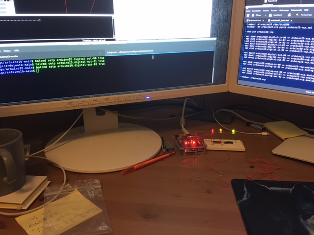

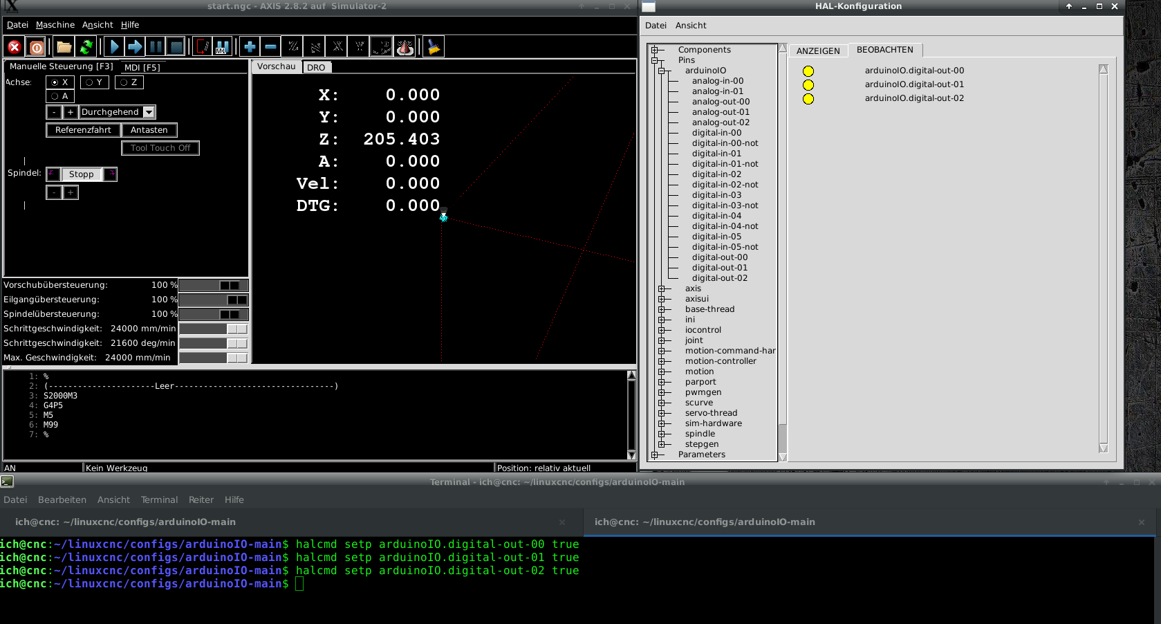

Nice, i will test it later, but may take some time...
Can the output pins also be set by hal pins?

I achieved this by hacking a little ModBus server on a PIC microcontroller and read the signals with the MB2HAL component.
I am currently thinking of using a STM32 board for that to also connect an encoder...
