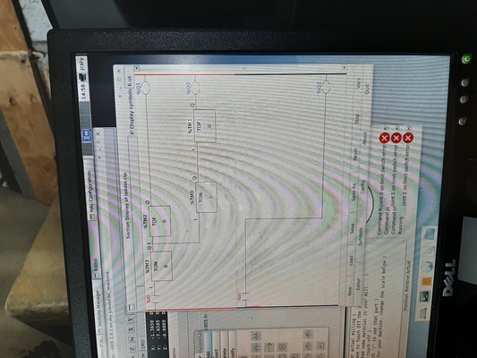

10 Jan 2023 13:25 - 10 Jan 2023 13:28 #261443
by hunterlong
Replied by hunterlong on topic Temporarily Disable Signal to Servo Amp
Cool, well just correct me if anything I say is nonsensical. I'm a noob
The way my tool change works now is I have in my *.ini file
[EMCIO]
EMCIO = io
CYCLE_TIME = 0.100
TOOL_TABLE = tool.tbl
TOOL_CHANGE_QUILL_UP = 1
TOOL_CHANGE_POSITION = 0 0 0.300
So when I get an M6T1 command the z-axis moves up to 0.300". Then there is a button on the machine I push wired up to classic logic. Q2 is the z-axis lock bar, Q1 lowers the pin to the drawbar, and Q0 extends the pin that releases the drawbar/tool.
I was thinking I would could just wire Q1 to pid.N.enable bit in as well so that while the drawbar is being pushed down the pid for the z axis is disabled as well.
-Hunter
[EMCIO]
EMCIO = io
CYCLE_TIME = 0.100
-Hunter
Last edit: 10 Jan 2023 13:28 by hunterlong. Reason: Image didn't work

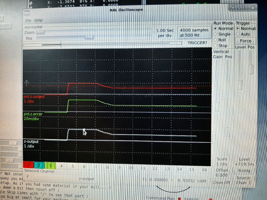

- hunterlong
- Posts: 23
11 Jan 2023 01:13 #261518
by hunterlong
Awesome! Now I just need to figure out the details. I have a vague notion of how to wire these things up in HAL. Off to read some tutorials!I included an oscilloscope display during a tool change that didn't fault the amp. The pid is definitely fighting that drawbar pushing down with 2klbs of force!
