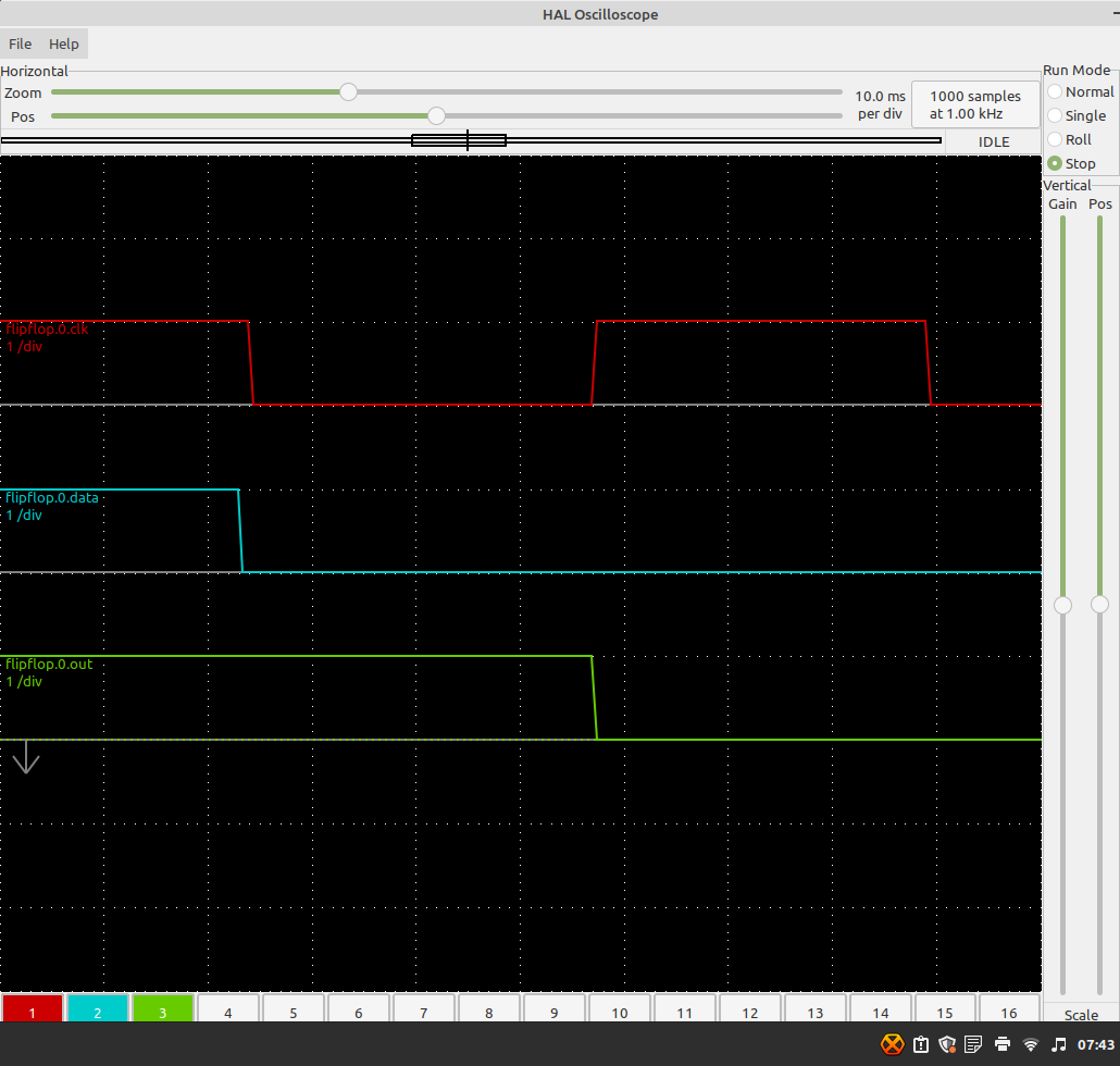

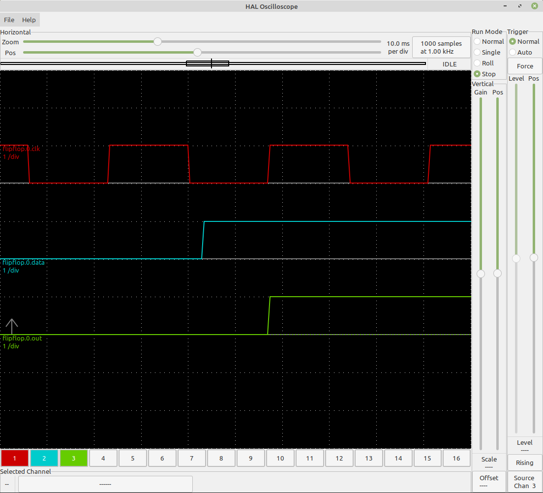

Have you tried plotting the flip flop input and output signals with halscope?

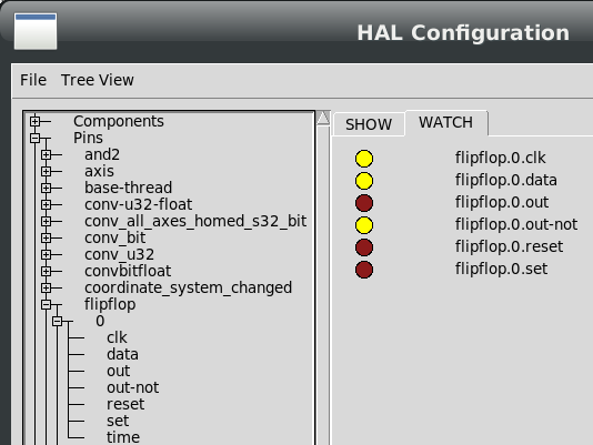

Thanks so much for looking into this for me! I was able to reproduce what you did above (as I'd expect to be able to).
If I use halcmd to unlink the is_g5x_index_1 clock input from the flipflop, and then manually set the value of the clock input, the flipflop works as expected, only for it to not function again when I reconnect 'is_g5x_index_1'.
My understanding is that it shouldn't be possible for the flipflop to be in the state shown in the screenshot where both the data and clock inputs are high, but the output is low.
Again, I'm not sure what could cause this. I was able to form the connection to connect the clock input so there should be no issues with the number format. I can see the changes in the clock input in Halshow, it just has no effect on the output.

- Posts: 18100
- Thank you received: 5326
31 Jul 2023 14:10 - 31 Jul 2023 14:47 #276633
Replied by PCW on topic Cannot set output of FLIPFLOP using data and clock inputs
