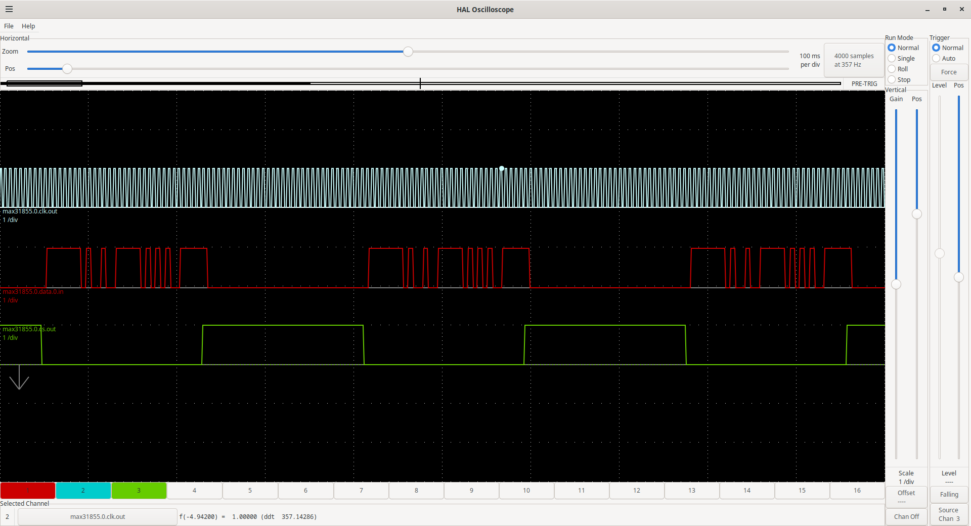

01 Sep 2023 16:51 #279591
by travis036
i happened to think to use halscope to view what LinuxCNC is receiving from the MAX31855 board. the data changes with each scope cycle, suggesting it is outputting data, but also dumping the data from a (possible incorrect) fault code. maybe due to my cheap boards.
ground signal tested out fine, though i still have only one wire from the board to ground. i will upgrade if i can't figure out why it is receiving data and dumping it in the trash.
Replied by travis036 on topic MAX31855 component: fails to return temperature and faults "7"

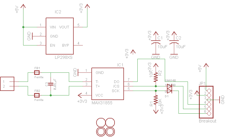

i have the 7i80HD-25 Pullups set to on, at 5V... what are the chances that when the machine is not running that the unprotected data pin is getting fried by the pullup? i checked the schematic, and the data pin of the max31855 board does not have protection from 5v like the CS and CLK pins do. i think tomorrow i will disable the pullups and try a new, unmolested MAX31855 board, just to rule it out. other than my stepper driver signals, the I/O is most all run through a SSerial board, so i don't think disabling the pullups will harm anything.
