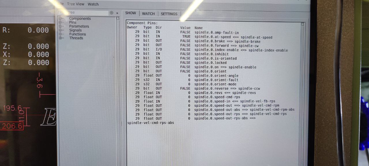

15 Sep 2023 11:12 #280827
by AlexMagToast
Replied by AlexMagToast on topic M4 doesn't work
Here are the results in the attachment:

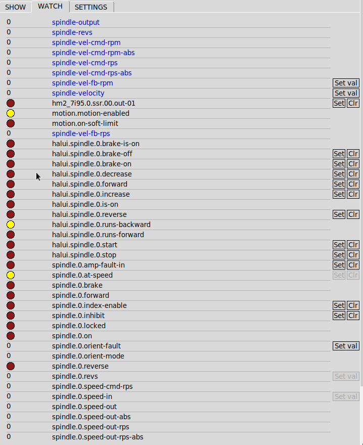

- Posts: 4818
- Thank you received: 2176
15 Sep 2023 15:10 - 15 Sep 2023 15:24 #280855
Replied by Aciera on topic M4 doesn't work
Maybe have a look at these pins in halscope when issuing M4 S...:
halui.spindle.0.forward
halui.spindle.0.reverse
halui.spindle.0.stop
Also commenting the lines that use the above pins and try MDI command M4 S... may give you some clue as to what is going on.

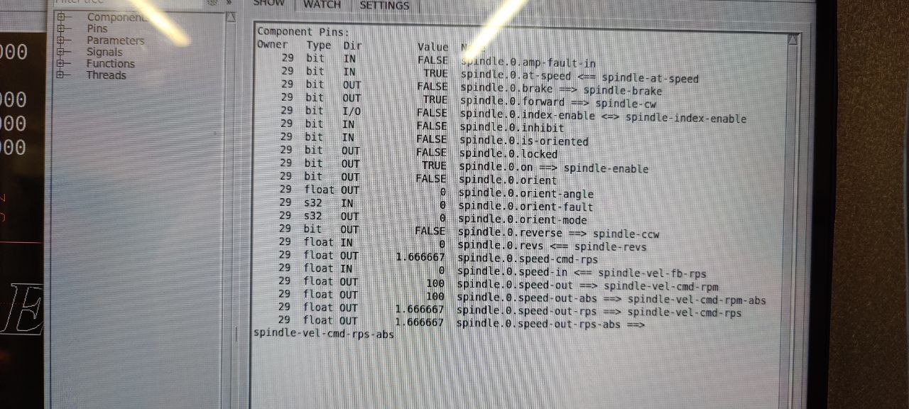

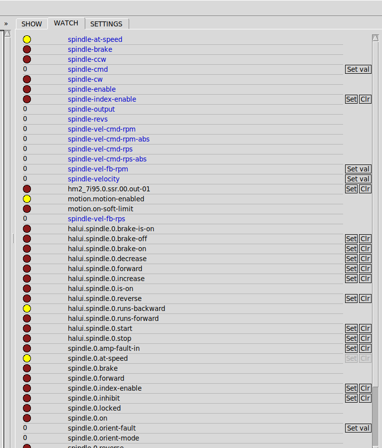

- AlexMagToast
- Posts: 94
- Thank you received: 72
15 Sep 2023 15:43 #280858
by AlexMagToast
Thanks for your suggestions.
@Aciera even with the lines fully commented out, nothing changes in the behaviour. so : no work.
@PCW how do i run this command?
i selected every spindle pin in halshow and append a screenshot here, this is after M4 S100 was issued.
now i have also upgraded to Linuxcnc 2.10.0. pre0, but the issue remains.
Again thanks for your help, guys!

- Posts: 18100
- Thank you received: 5326
15 Sep 2023 15:48 #280859
Replied by PCW on topic M4 doesn't work
Run / start linuxcnc and issue a m4 s100
then in a terminal window, type
halcmd show all | grep spindle > spindle.txt
and post spindle.txt here
