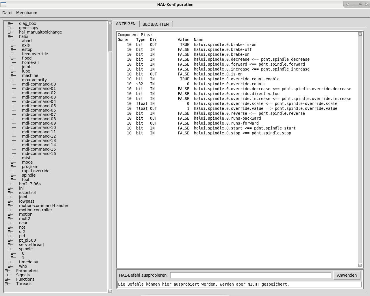

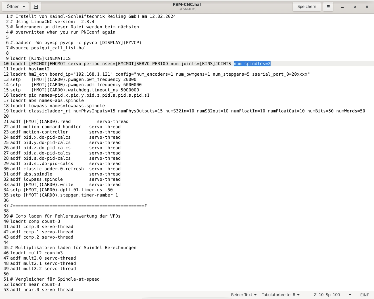

Hello Guys,
i try to get a 2. Spindle ( not 2 Axis ) and i define in the HAL with num_spindles=2 ( see picture ).
In the halui is only one spindle, spindle.0
in "spindle" i found spindle.0 and spindle.1 ... so far so good.
If i try to connect pins with spindle.1. i got a message "unknown pin"
I read the documentation about spindles, but i found only something with the different numbers, but nothing how i can get a 2. spindle.
Have anyone an idea to get it?
thank you so much in advance
best regards
Reinhard

- Posts: 18093
- Thank you received: 5325
19 Feb 2024 16:56 #293771
Replied by PCW on topic 2. Spindle how is to do, to get it?
I wonder if halui needs to be told how many spindles are present?

20 Feb 2024 08:12 - 20 Feb 2024 08:15 #293827
by TimP
Replied by TimP on topic 2. Spindle how is to do, to get it?
what i have done
num_spindles=2 in hal
SPINDLES = 2 in [TRAJ] section of ini file
[SPINDLE_0] in ini file with max min speeds
[SPINDLE_1]
that's it i have two spindles in HALUI

20 Feb 2024 14:13 #293842
by CNC_Tux
Replied by CNC_Tux on topic 2. Spindle how is to do, to get it?
Hello Tim,
thank you so much, thats it ... i have two spindles in the halui, and if i use in MDI for example with s300 $1 its working with speed 300.
In the Documentation i didnt found something about the [TRAJ] section.
A other question .... its possible to build a Spindle with a Mesa 7i96S with Step and Dir signal?
Have you a solution as well for me ?
