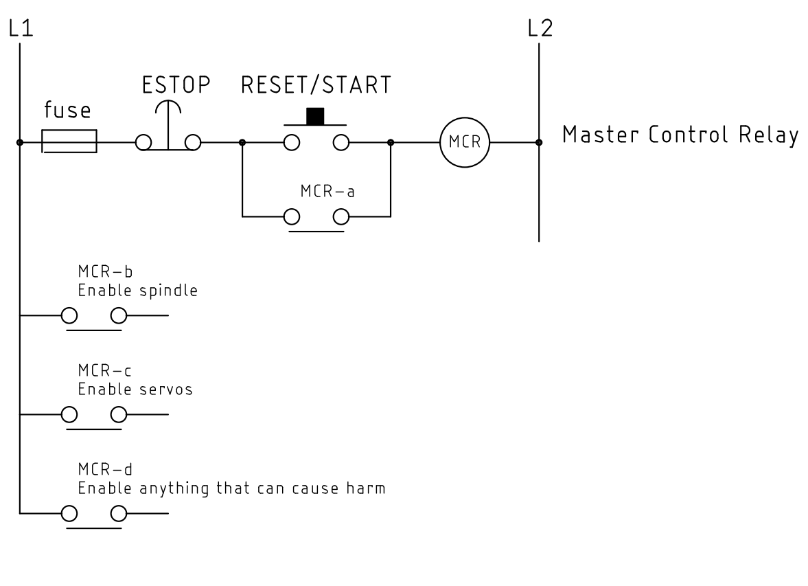

Let me be clear ,I am only trying to raise awareness that screen estops are not allowed.
This discussion is not about machine safety relays, devices, … etc. So, let’s not mix-up things and muddy the discussion.
This awareness message is strictly about machine estop/reset only, which require very simple relay circuit. If you cannot read electrical diagrams just google start/stop circuit and you will find several examples showing realistic picture and wiring diagram for non electrical inclined.
To build an estop/reset circuit you need: red mushroom shaped push button, a push button and a relay wired as follows:

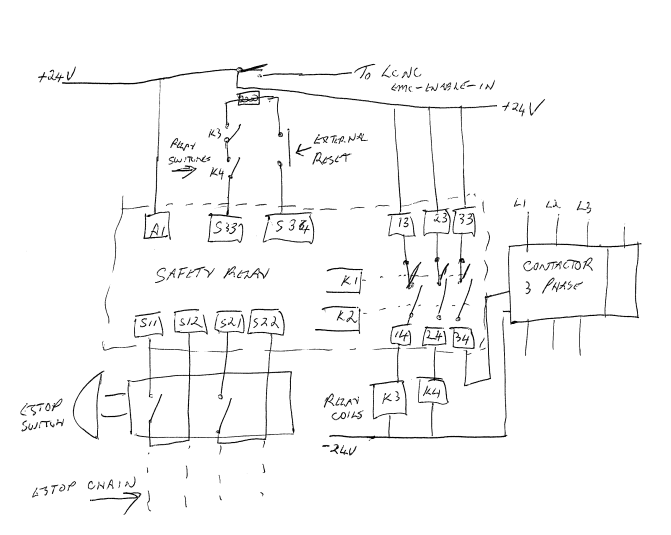

25 Aug 2024 23:33 #308635 by rodw
Replied by rodw on topic Is software Estop allowed
Not really good enough. Everything needs dual redundancy.
Note that the estop button has two redunant circuits
The main contactor needs both K1 & K2 to be triggered
K3 & K4 are seperate force guided relays. Linuxcnc is not updated with a sucessful power on unless both K3 & K4 are triggered.
Force guided relays have a non conductive pin forced between the contacts to ensure contacts cannot be welded together.
Additional safety switches eg. door switches, guards etc are placed in the S33/S34 loop with the reset button.
With such a wiring layout, it is permissable to use  linuxcnc's software power button as a reset latch. In this case, use iocontrol.0.user-request-enable as it receives a pulse to repliciate the external reset button.
BUt the safety relay cost me $250 AUD and another $100 or so for the force guided relays.
