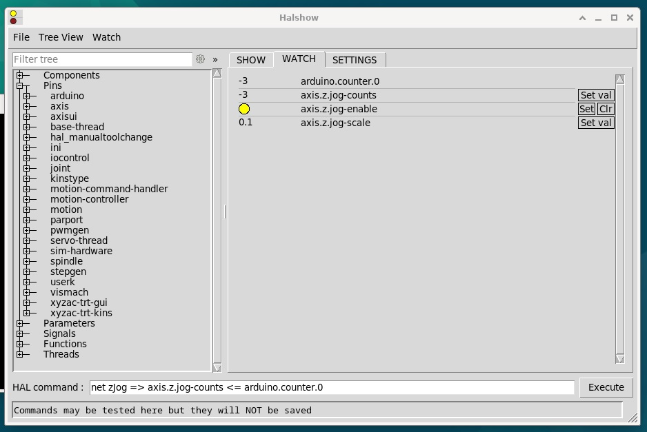

Hello, I'm currently trying to create a handwheel with the Arduino. Now I'm having a problem with the HAL.
I added in my CNC.hal :
loadusr arduino-connector
net zJog => axis.z.jog-counts <= arduino.counter.0
axis.z.jog-enable = 1
axis.z.jog-scale = 0.1
When I start my CNC I get the error "Pin 'arduino.counter.0' does not exist". When I try this commands in "Halshow" it works fine.
Can someone help me with this?

Trying change first line in HAL to this:
loadusr -Wn arduino arduino-connector

27 Feb 2025 07:35 #322775
by d12k6
Replied by d12k6 on topic HAL with ArduinoConnector
Thank you it works
