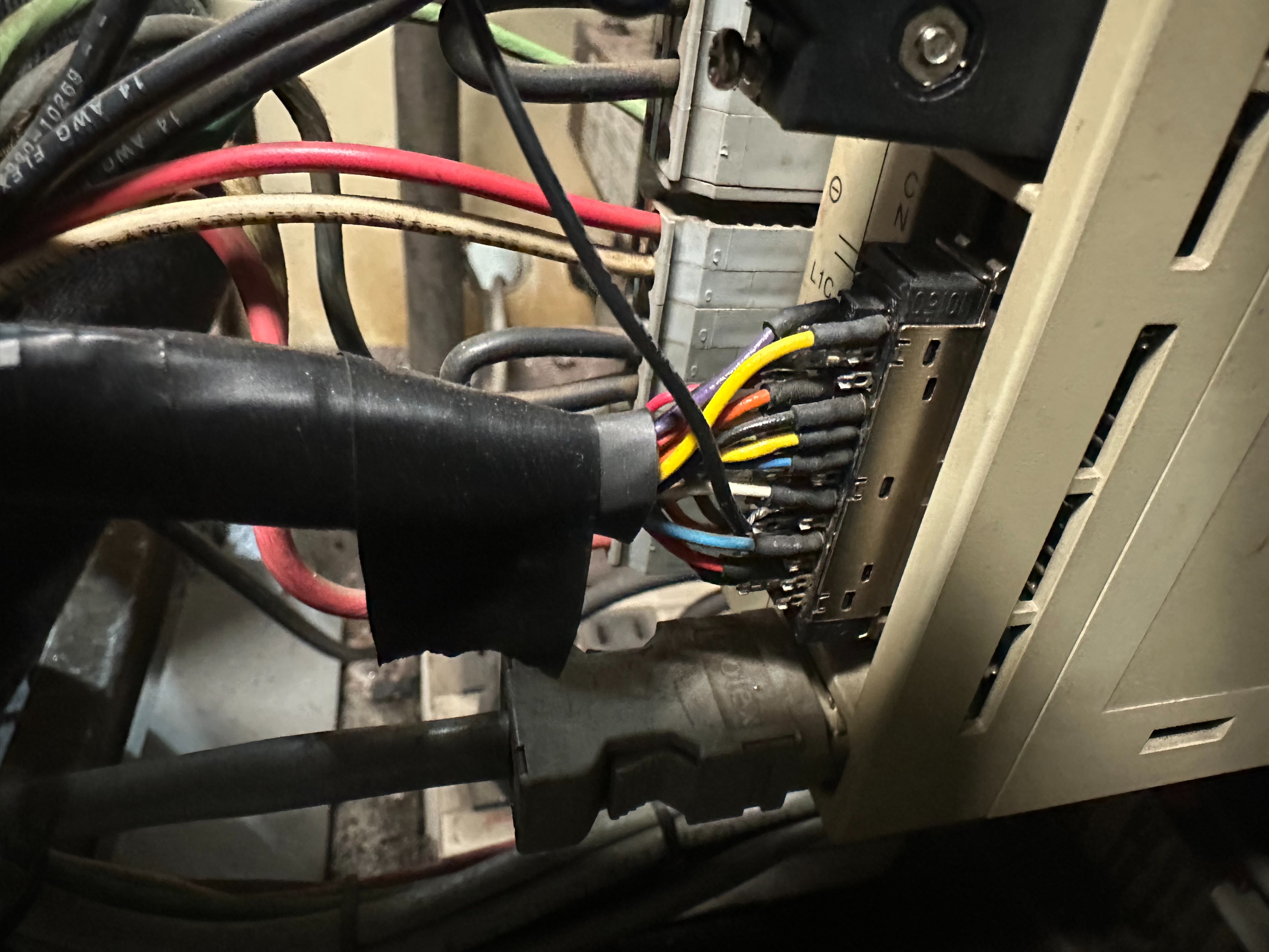

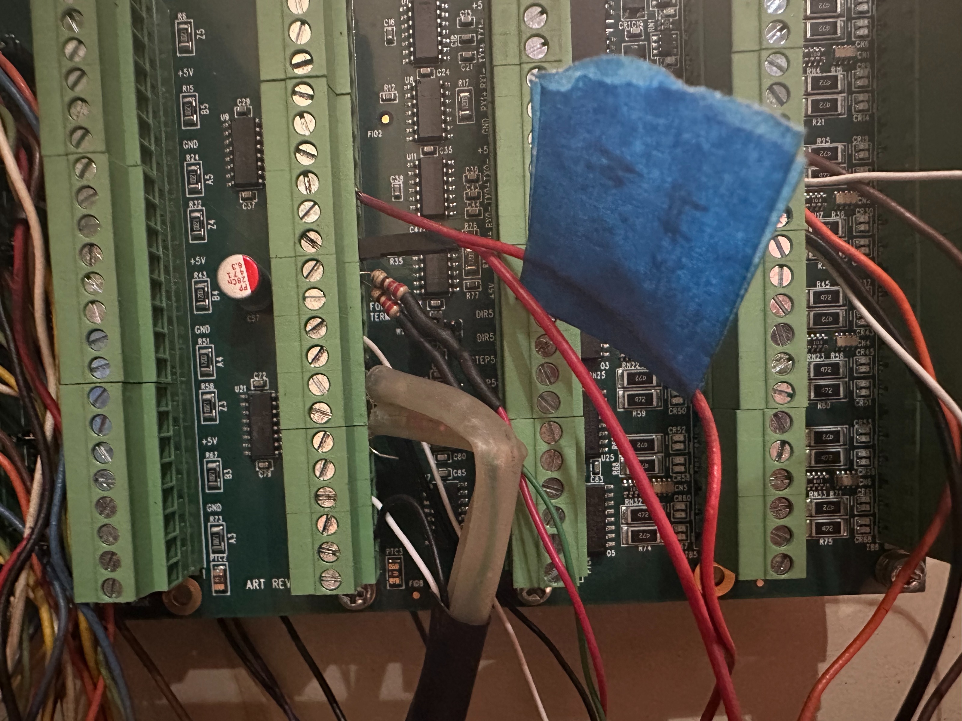

We are working on a retrofit of an older Fryer lathe. We are using a Mesa 7i95 board and are trying to connect our SGDH-10AE Yaskawa drivers to the board in position control mode. We have managed to make the axes move in what seems like position control, but when changing the jog speed in AXIS, it also changes where the motion stops. I believe that I have made a mistake, or many, in trying to set up our HAL code. We generated the HAL code from Pnfconf and then made adjustments to try to change the Stepgen to position control mode. I was hoping that we could get some help in looking at our Hal and Ini files to see where we may have gone wrong. Or if someone has successfully implemented it, we could look at their files to see if we can figure it out.

8 months 1 week ago #343543 by tommylight
Replied by tommylight on topic Trying to set up position control mode
I suspect interference, so pictures of the wiring from Mesa to drives might help.

8 months 1 week ago #343548 by jblanscett
Replied by jblanscett on topic Trying to set up position control mode
Yes, we are the same team. I have attached photos. We have also looked at the signals from an oscilloscope and are getting nice clear step waves.

8 months 1 week ago #343560 by PCW
Replied by PCW on topic Trying to set up position control mode
The wiring does not look right to me, Don't those drives have differential inputs?
If they are differential, the 7I95 Step/Dir connections are wrong.

8 months 1 week ago - 8 months 1 week ago #343596 by jblanscett
Hi PCW,
I hope this is what you are talking about. We have our pn200 setting set at 5. Let me know if there is anything else I'm missing. Thank you for your time.

8 months 1 week ago - 8 months 1 week ago #343605 by PCW
Do you have the step/dir pinout information for the drive?
It does look like it may be single ended from the pictures of the
step/dir modes.
Also in your .ini file, you have the PID P term set to 0.
This should be 1000 (for a 1 ms servo thread period)
A 0 P term will cause position drift

8 months 1 week ago #343621 by PCW
1. A 0 P term will not work as it will drift it must be 1/servo_period
(1000 for a 1 ms servo thread period)
2. It looks like the step/dir inputs are differential so:
Drive        7I95
7   PULS    Step+
8  /PULS    Step-
11 SIGN     Dir
12 /SIGN    Dir-
