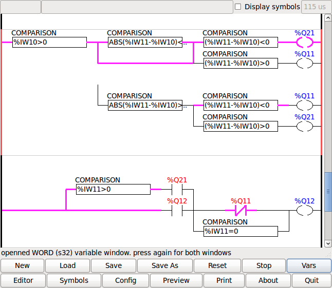

OK, i brake it on two rungs.
But now i have to use modulus (to find shortest direction of rotation).
Integrator Manual V2.5
30.6.6 COMPARE
"ˆ (exponent),% (modulus),& (and),| (or),. -"
But how can i use modulus?
I tried, but it's all not working:
%(%IW11-%IW10)<=10 "Unknown term"
(%(%IW11-%IW10))<=10 "Missing Parenthesis"
(%IW11-%IW10)%<=10 "Unknown term"
((%IW11-%IW10)%)<=10 "Unknown term"
30.6.6 COMPARE
Last edit: 28 Dec 2012 22:46 by machete.

28 Dec 2012 23:53 - 29 Dec 2012 00:00 #28125
by BigJohnT
Replied by BigJohnT on topic Compare expressions in Classic Ladder?
That is a classic example of the "last one wins" rule for PLC's. Read the
opening paragraph
for Classicladder.
Also the second comparison on the first line will always evaluate to true with the rung wrapped around it.
John
John
Last edit: 29 Dec 2012 00:00 by BigJohnT.
