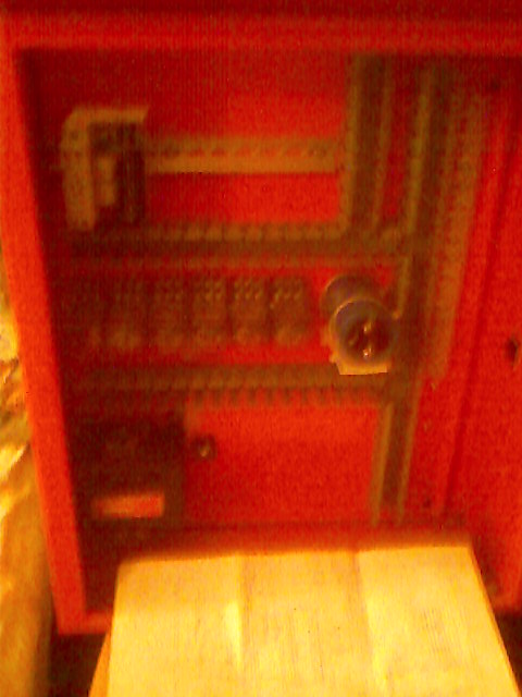

and my control cabinet in progress, missing the controller as I have not mounted it just yet, and needs wiring as I have not ran it yet...
www.flickr.com/photos/39552455@N05/5104219300/
