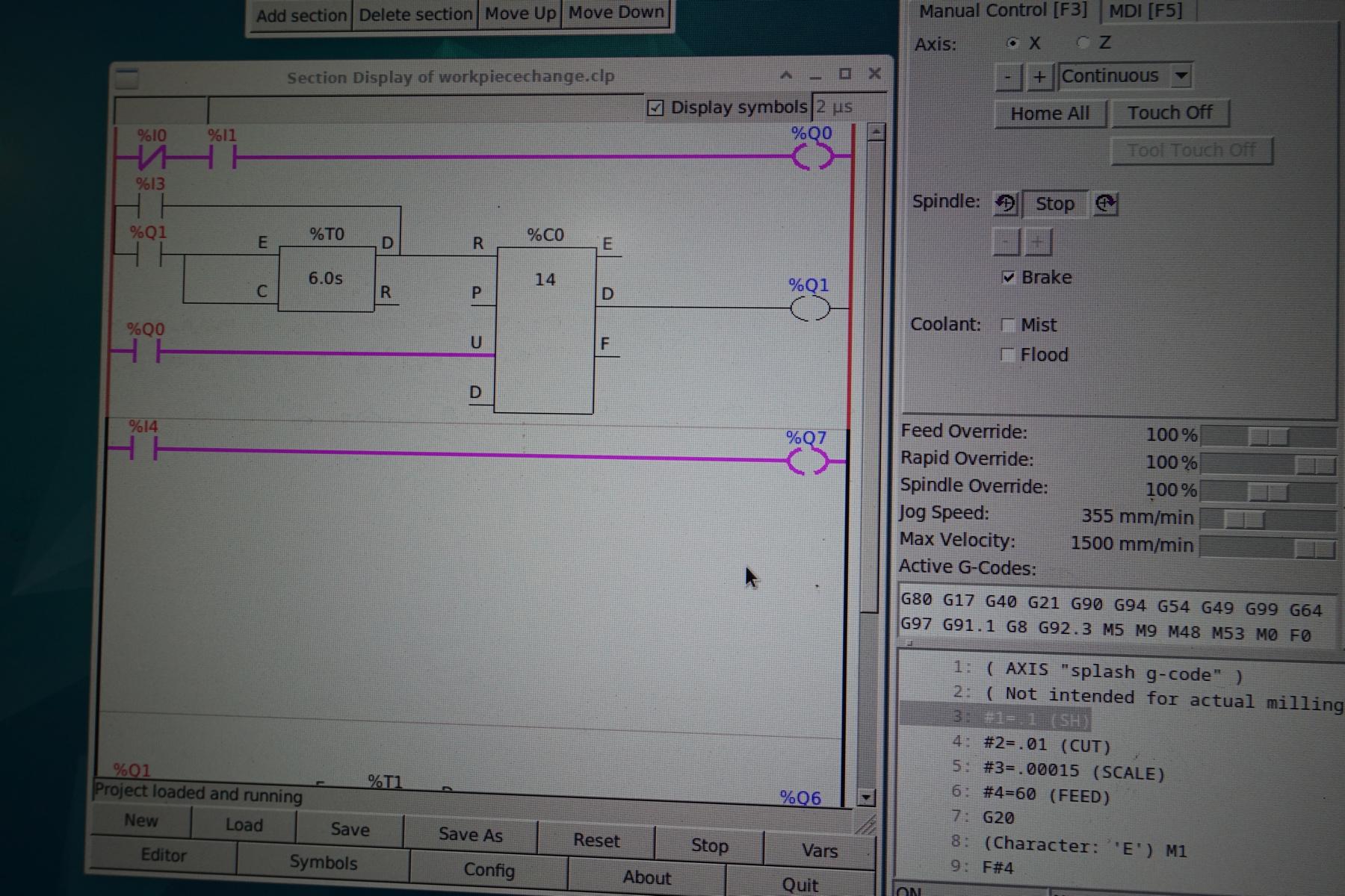

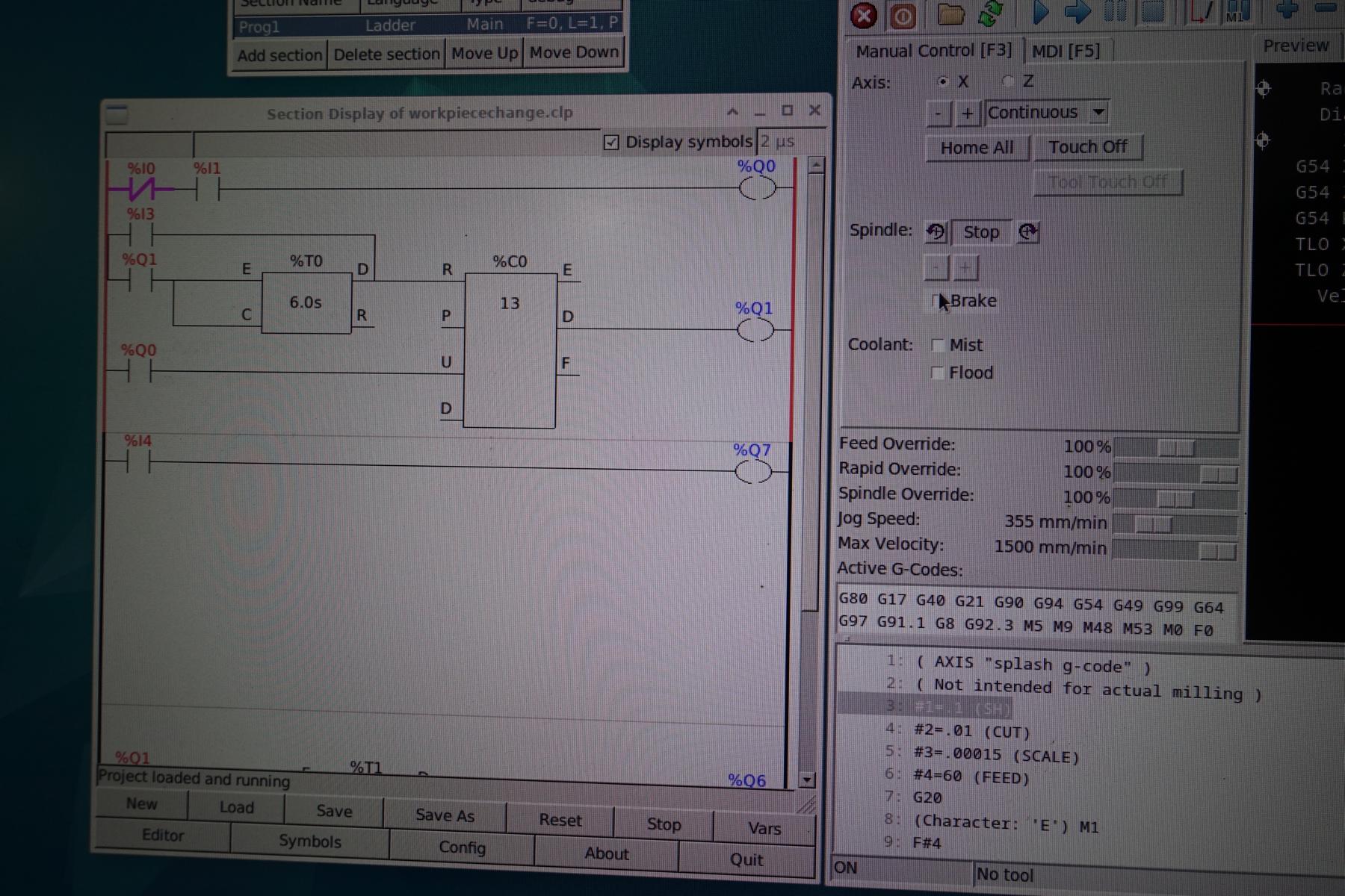

02 Oct 2024 17:09 - 02 Oct 2024 17:11 #311190
by timo
Replied by timo on topic Linking multiple signals/pins together
Recent test:
7i95
The input-04 is just any that was not yet used in the *.hal.
The out-07 was as well one that was not yet used.
I can switch off the brake with the mouse on the Axis screen
As soon as the Input 4 on my mesa card gets activated, the %I4 is active and coil %Q7 is activated.
The %Q7 is linked with the halui and does the same as a checking the box on Axis screen with my mouse.
Greetings Timo
