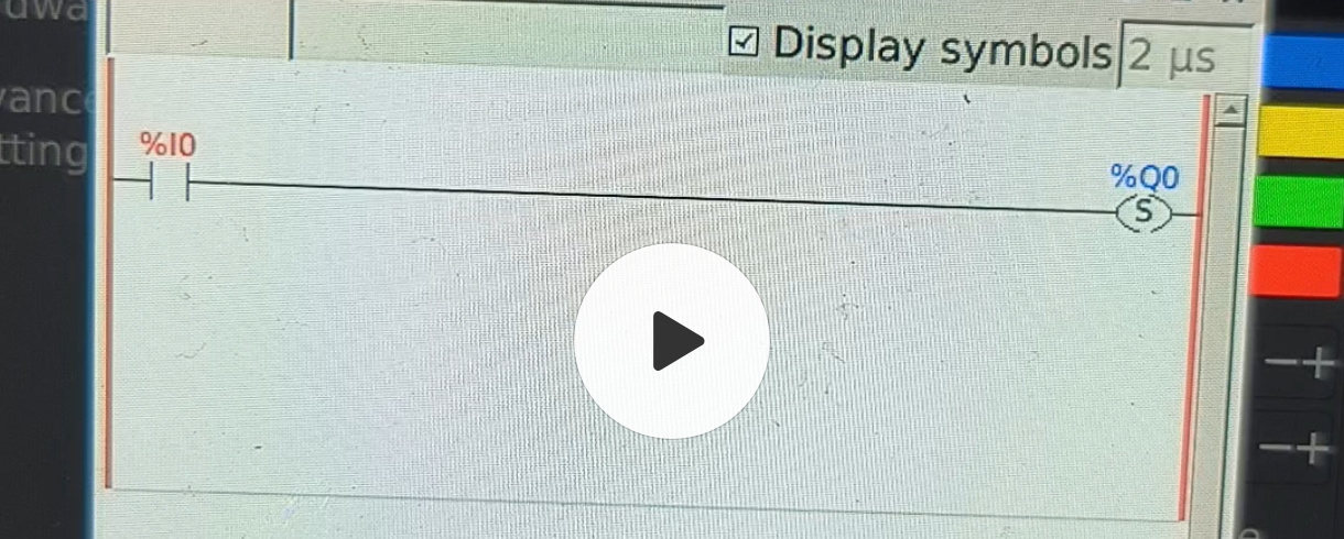

  Hello everyone. Can anyone tell me why the set coil works like a regular relay, and does not remain on when the input signal disappears?
I tried sending %B0 to the internal relay. The result is the same.

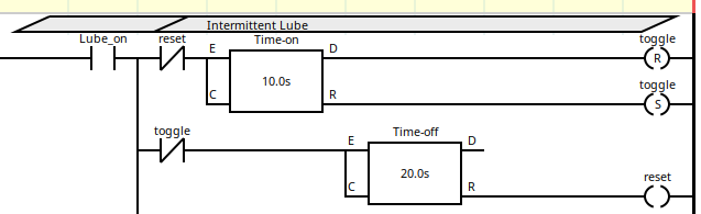

1 year 6 days ago - 1 year 6 days ago #337495 by Aciera
Replied by Aciera on topic Coil Set and Reset.
It been a long time since I have used classicladder but I think you need to link the set coil to a contact like in this example:
So you would connect your '%Q0' Output to the 'toggle' contact. (Like  'reset' in the example above but without the 'Time-off' block.)
Last edit: 1 year 6 days ago by Aciera.

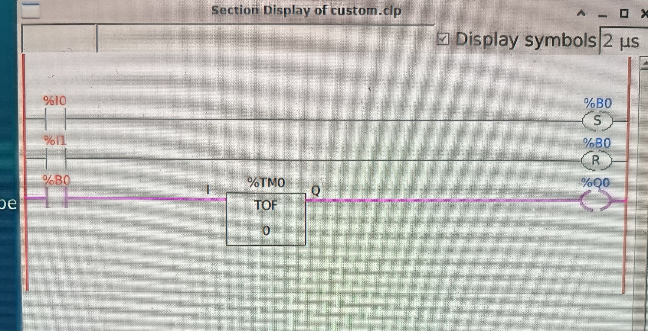

1 year 6 days ago #337555 by Yaroslav
Replied by Yaroslav on topic Coil Set and Reset.
I made a diagram. Here's how it works. When power is applied to the set input, the coil turns on and remains on, but it does not glow red, but its additional contacts glow. Accordingly, powering the reset input turns it off.
