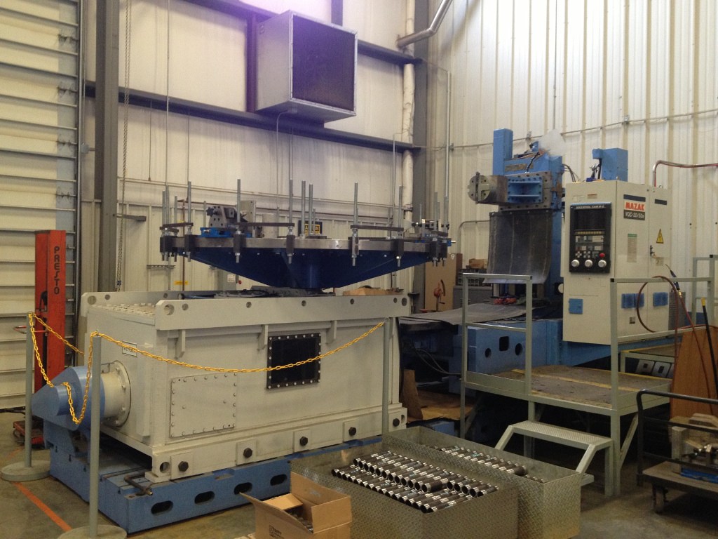

I hope to make this thread my general progress page, mixed with questions and answers specific to Lathes on LinuxCNC. I posted earlier regarding the sizing of the axis motors in this thread, just for reference:
Mazak Dino Retrofit
This is the Franken-Dino: (Sorry, pictures seem to be causing a "Fatal server error". I'll try tomorrow)
It was converted an unknown number of years ago to plane the surface of 5-meter diameter "bullwheels" used for aerial rope-ways. The planed surfaces are used for braking, so they don't need to be very smooth or precise. Actually, they need to be somewhat rough.
I thought I could help some other machine designers out there by giving some details since this place has helped me already. Many of the parts here are used simply because we already had them, or have experience using them. Initially I wansn't using EMC in favour of a commercial controller and software. However, when my distributor pulled the old bait-and-switch I backed out and, well, here I am.

At this point I have the old control cabinet removed and the new sexier cabinet is being built by our company professionals. The PC is up an running and I have been spending my time getting linux to be happy with the touchscreen and the hardware. I have a basic setup using the generic MOTENC included and I am at the point where I might need some help with finishing touches to the I/O stuff.

The retrofit has been complete for a number of months, but we were waiting on the material to be turned. As of now we have turned two pieces. Works exceptionally.
