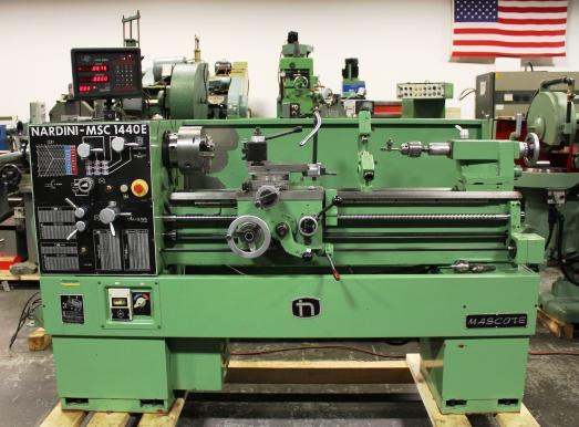

Well starting the 2nd piece for my shop. I will be picking up a nardeli ms1440 s lathe that needs work. So going to do a cnc conversion. Just wondering if I should use steppers or servos, leaning to steppers right now due to cost. I will also need to but a vfd, 2 ballscrews, new gibbs on the x axis (missing) a new chuck (missing) and a tool holder. Any config ideas would be great.

I assume it is similar to this?
I have a similar, but slightly smaller geared head screw-cutting, removable gap bed manual lathe from Warco.
They are all essentially Colchester / Harrison knock offs made in China (this one is even called a Mascot). The exact finish quality is largely down to which company badges them.
Some like Warco employ their own QC inspectors in China, others just get the finished lump and may even charge extra to take it all apart, clean all the crap out, lap parts and fit decent bearings etc.
I have seen a company in China selling CNC converted versions of these lathes.
They were all servo powered and I would think with the weight of everything, that is the way to go.
Needless to say, I cannot find a link to them at present, they used to advertise on ebay.
My lathe is a very good solid manual lathe and I decided to keep it as it is.
I often find it much quicker to just forget about CNC and do things the old fashioned manual way.

That is almost it. Mine is the s model 5hp single speed. The condition I am getting it is non running parts removed so cnc is going to be easier them finding all the parts and making it a manual again.

I would think that it looks a bit big for steppers, especially on the Z where built-as-CNC lathes tend to have a surprisingly big motor.
The new hybrid closed-loop steppers might be an option, I think that they run faster and so allow a bigger drive ratio.
www.zappautomation.co.uk/electrical-prod...-stepper-system.html
Has some information. I would be looking at the direct mains input variant, I think.
Well, actually, for a one-off _I_ would probably be shopping at the fa-parts ebay shop for second-hand matched servos and drives
stores.ebay.co.uk/faparts/ (I have never used them, I just know that they have some tempting stock)

What motors are those?
For the length of the machine the Z motion seems a little slower than desirable, but it is better for the rapids to be slow than for the cutting force to be too small.
Has the machine made any test-cuts yet?
