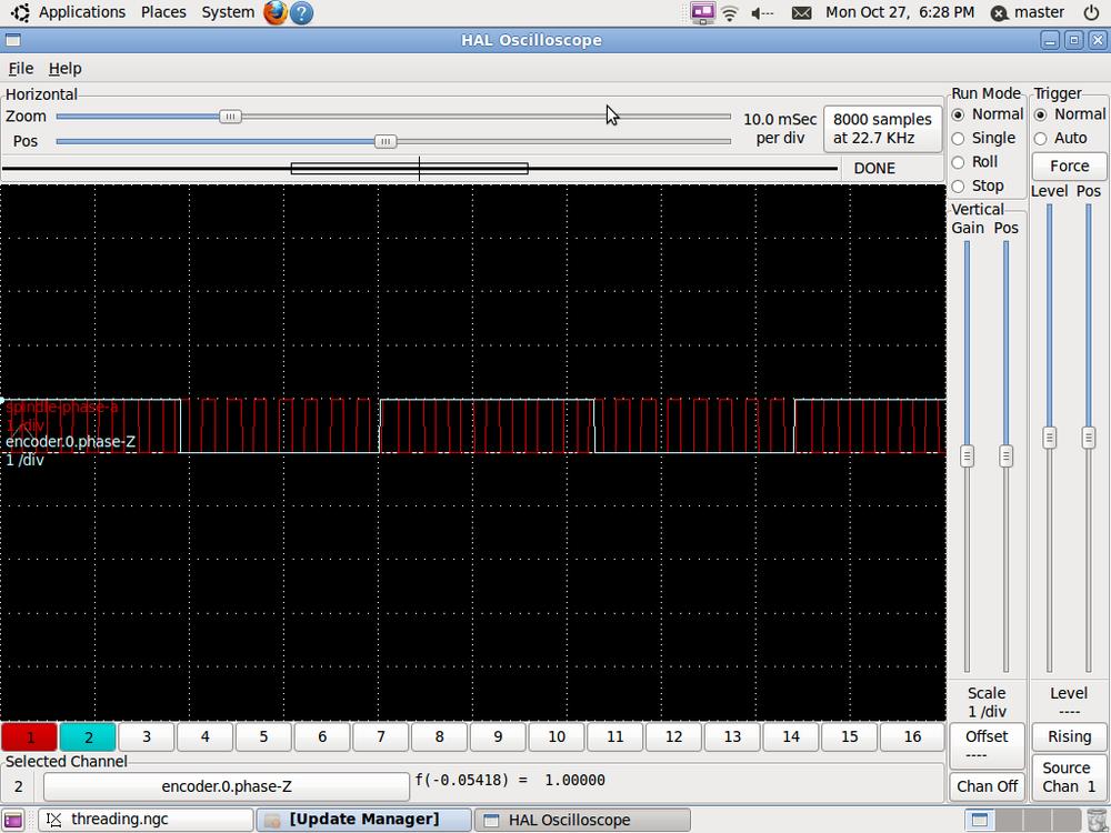

I am having an issue with the synchronized motion using G76 and G33. I have the speed connected for manual control. When issuing G76 and G33 commands I note that changing the speed has no effect on the Z axis speed. Does LinuxCNC monitor the shaft encoder for synchronized movement or assume the stated spindle speed? If the shaft encoder is monitored, why don't I see Z axis speed change with shaft speed?

I built a low resolution shaft encoder. Here is a screen from HAL scope.
I am using manual speed control because I haven't gotten the VFD hooked up yet.
I don't want to change speed during the cutting of a thread. I only did that to test the system during an air cut. It should have compensated the feed rate, but the feed rate was unaffected.

About maxing out - I don't think so. When I have the spindle speed turned up high LinuxCNC won't take a pass. I assume that this is because it cannot make the pass at the maximum Z travel speed (though I am guessing). That leads me to think it IS monitoring the spindle speed and matching the Z speed (actually following the surface I know). However, when I have the speed set low enough to take passes I can change the spindle speed around and the Z feed rate does not change. It does not even change between passes. If it is 83 (mm) it remains at 83.
As you can see from the HAL Scope capture I posted, LinuxCNC clearly sees both A phase and Z phase. I know this works for other people, so I am pretty sure the mistake is in something I have done. I just can't figure out what.

Is "counter_mode" set to true?
If you stop the spindle, does the movement stop (it should).
Attach your HAL and INI files, we can have a look for anything obvious.
Replied by andypugh on topic spindle sync trouble

I got to step 2 and stopped the spindle in the middle of a thread run. As I approached 0 the Z speed dropped off and stopped. I ran the speed up and down in the very low ranges and the Z speed (feedrate) followed the surface. Without a readout I just had the spindle speed too high before. I had assumed incorrectly that when the machine took a run at the threads it meant that it could match the feedrate to the spindle speed. It couldn't keep up at that speed. Andy had considered that possibility earlier. He was right! It works perfectly but at a lower speed than I had "eyeballed" with my manual speed control tied across the VFD.
SOLVED (thank you Andy Pugh)

It is possible that your encoder scale is wrong, which might explain the miss-match.
It is definitely worth opening a halmeter (in the "machine" menu) and looking at motion.spindle-revs to make sure that it increases by exactly 1.0 as you rotate the spindle by hand with the VFD turned off.
