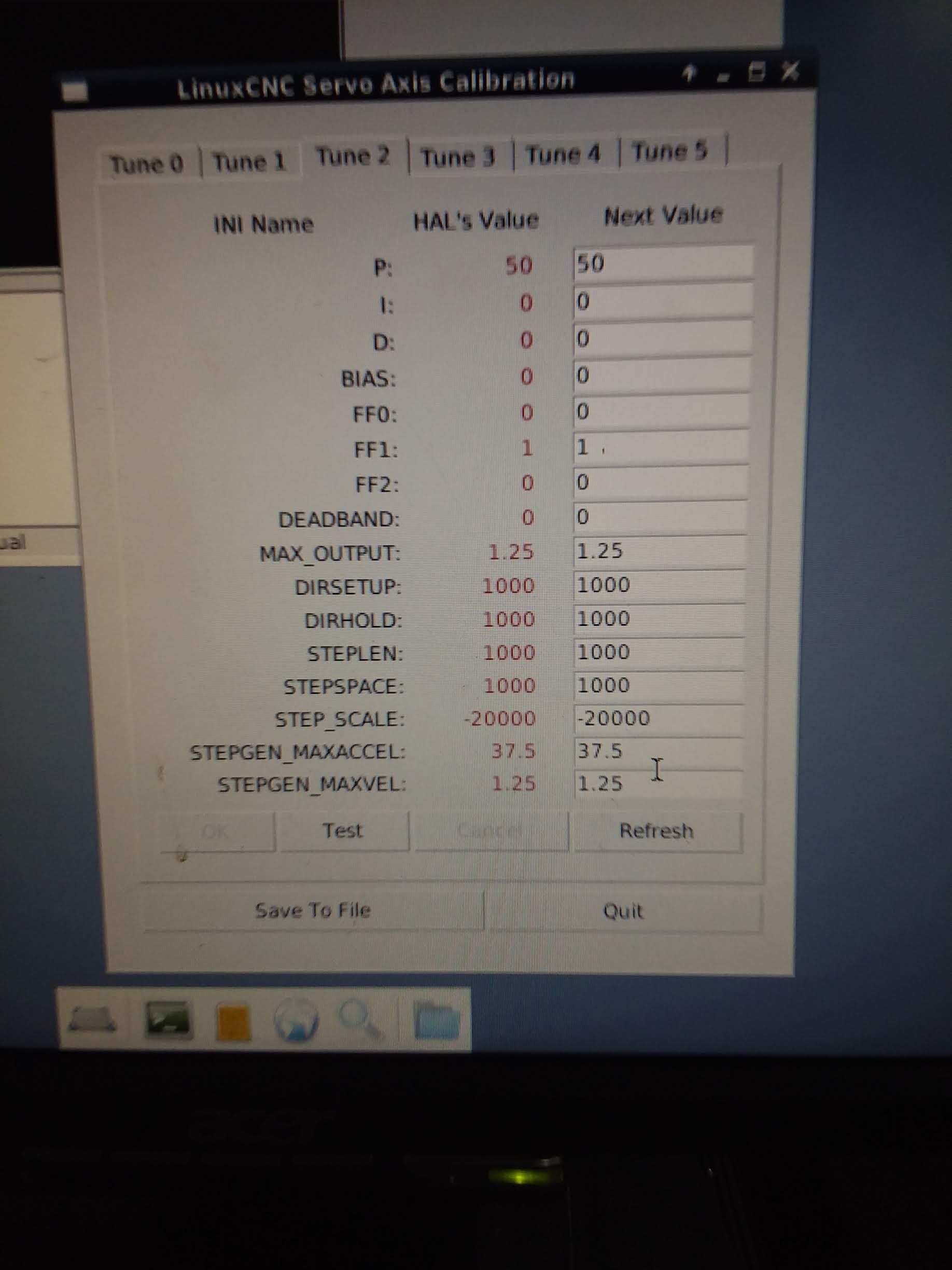

Hi all,
So after reading a bunch I am stuck. My Z axis seems to be off exactly the same every time. Using a dial indicator I go to move .500, and it will only move .490. Then when it goes back to 0 it has moved an extra .001, every time. It keeps moving along. So it shifts as it repeats the same path. It will always travel .490", but it will always gain a .001 on one end and lose it on the other. I imagine its an step tuning issue. Any direction someone can point me in would be great. I do not know where I need to go to fix this.
I did not build this machine nor am I that experienced in linuxcnc past reading the manual, I purchased it to get a home shop running, and am using it as my learning tool so I can build my own machines. I am currently a novice learning as I go. Thanks for the understanding. Thank you.

Is the error proportional? Is 0.25" actually 0.245? 0.75 = 0.735?
If so then it looks like a simple scaling error. 5 TPI leadscrew and 5mm leadscrew are about the right error to account for this.
(0.5" / 5.08" * 5mm = 0.492..)
Replied by andypugh on topic Z axis is off by .010" over 1/2"
So after reading a bunch I am stuck. My Z axis seems to be off exactly the same every time. Using a dial indicator I go to move .500, and it will only move .490. .

Yes the error is proportional. I moved it a 1/4'' and it was off .005. Moved it a half inch and it was off almost exactly .492. and .75 was mor like .738 ish, but I have a half thousandth of backlash. Not sure if it is accounted for.
How would I fix this? What menu would I go in? Or where about's in the manual? I uploaded a picture of the servo tune. I think the acceleration might be to much? And it's missing a step as well?
Thank you.

30 Jan 2019 01:02 #125234
Replied by PCW on topic Z axis is off by .010" over 1/2"
You could try setting your step_scale to -20320
Also you acceleration is very quick (1.25/37.5 = 1/30 second to full speed)
you might need to reduce this also
Yes, -20000 sounds like an assumed 5tpi on a metric machine and 20x microstepping (or gear ratio)
It is far more likely that ball screws are 5mm pitch, so that -20320 is the number.
Though, it has to be said, that 5tpi ball screws exist, I had exactly the opposite problem when I changed the ball screw on my milling machine Y axis. There is a very compact 16mm ball screw with a 5tpi pitch from Gten.

Thank you all for the advice, I finally got back to the machine and presto, -20320 was the magic number. I ended up lowering the acceleration to 19 and that also solved the missing step issue.
Now what is happening is that it moves .002 further than commanded everytime I move. So from 0 to .250 it moves .252. Then from 0 to .750 it moves .752. What could be causing this? I do have .0005" of back lash. could that be causing this?
