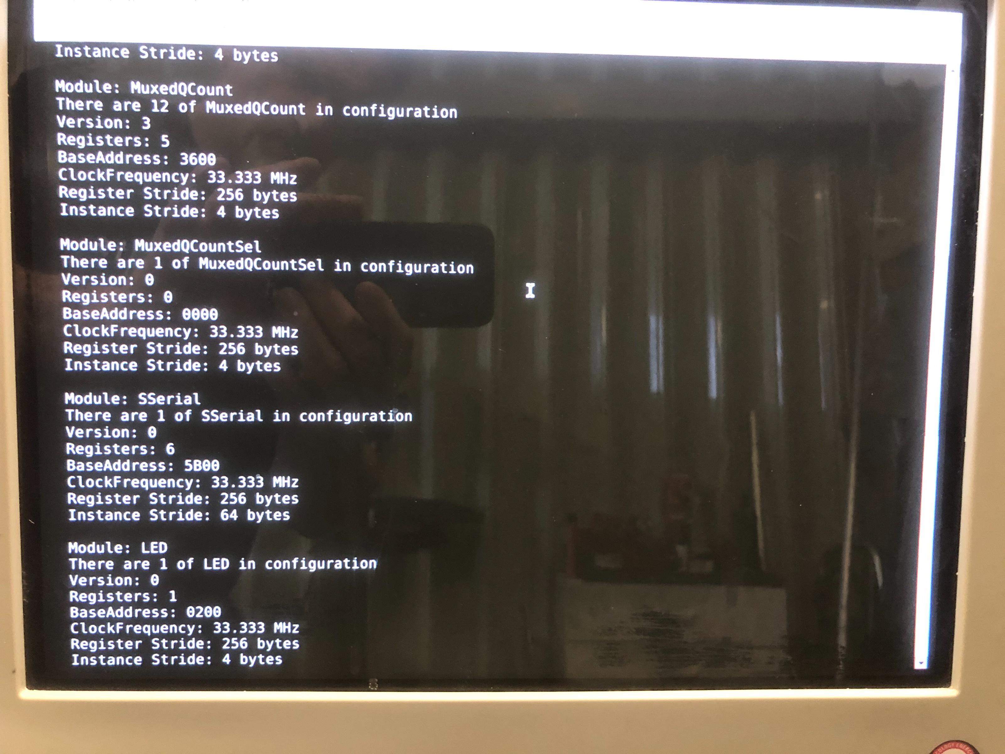

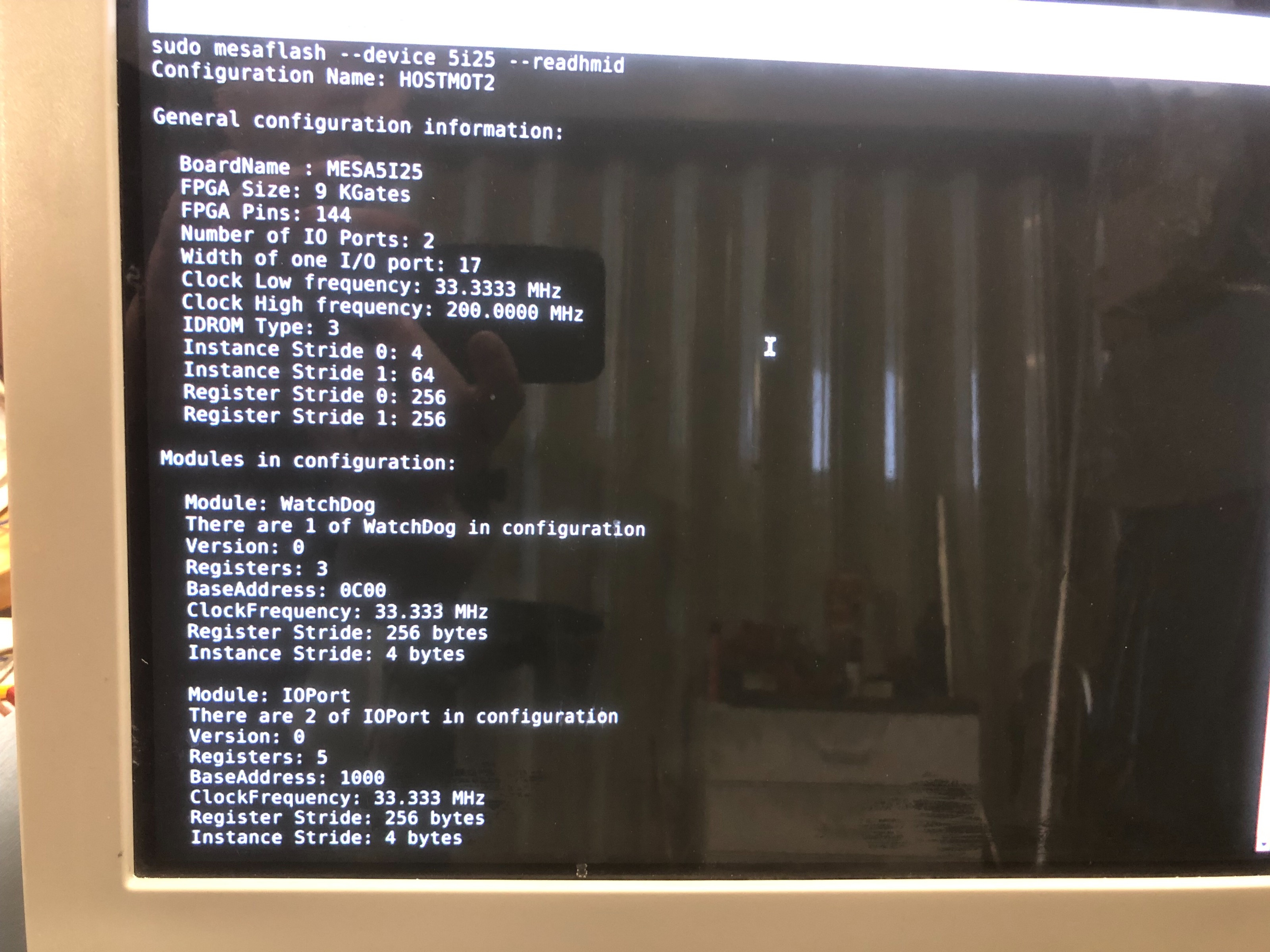

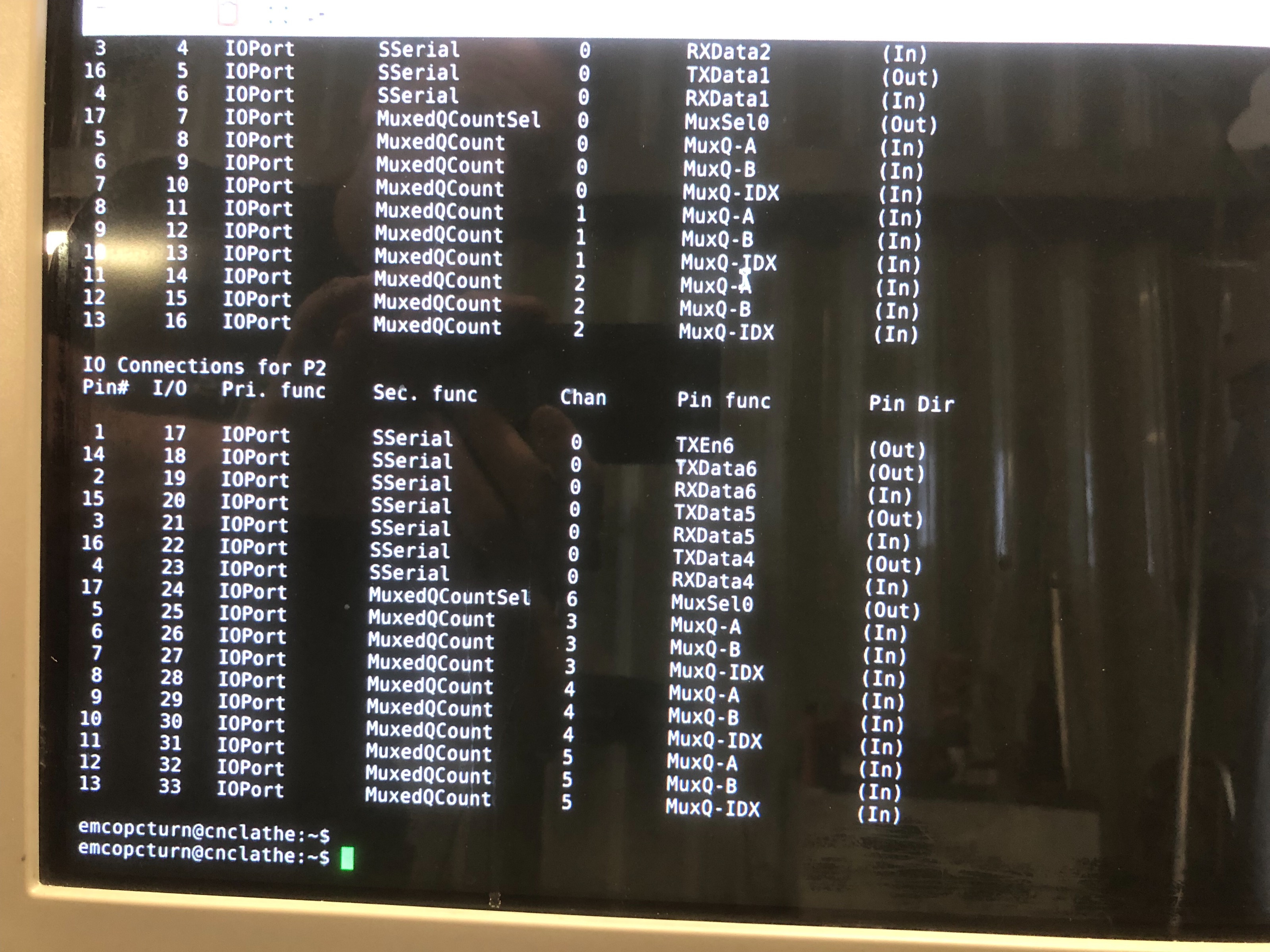

What have you set the step length to?
It sounds like it may be that the pin allocation is not what you think it is.
Mesaflash should be able to help you confirm the pin allocation of the installed firmware.
sudo mesaflash --device 5i25 --readhmid
