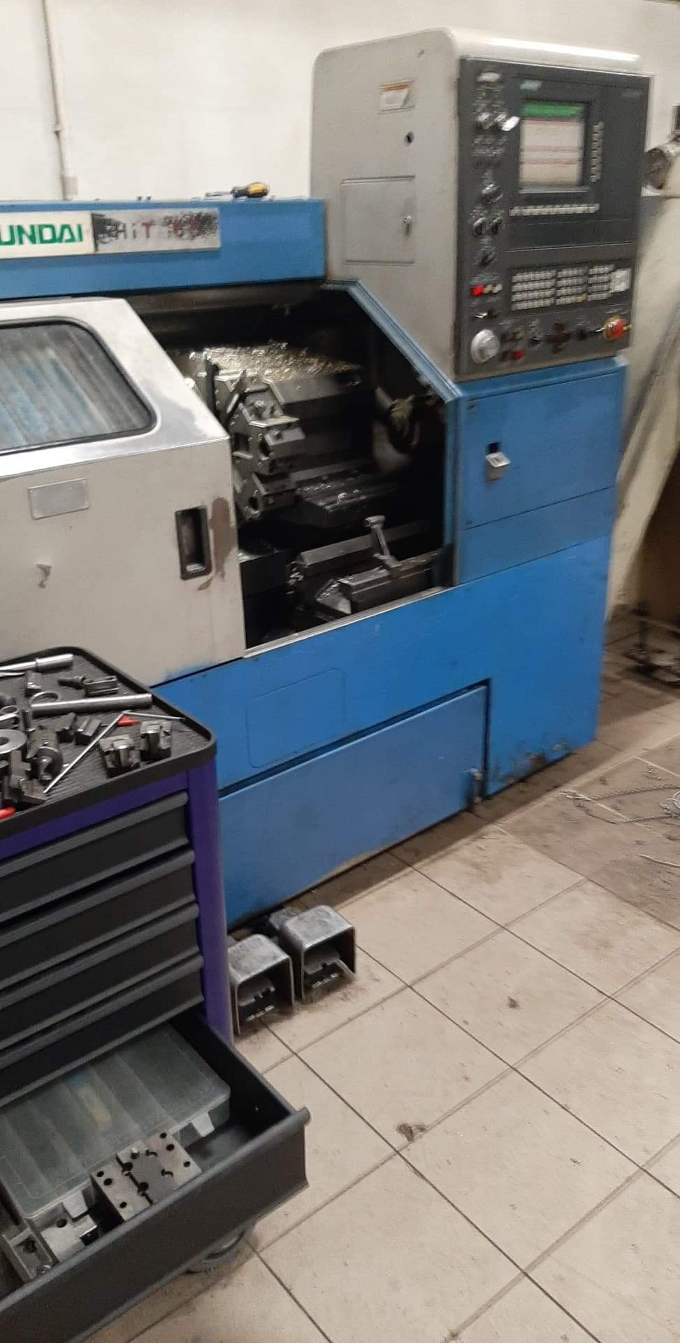

Hyundai 18s hit sinumerik 840c
- Torus13
- Posts: 12
27 Oct 2020 23:09 #187484
by Torus13
Replied by Torus13 on topic Hyundai 18s hit sinumerik 840c

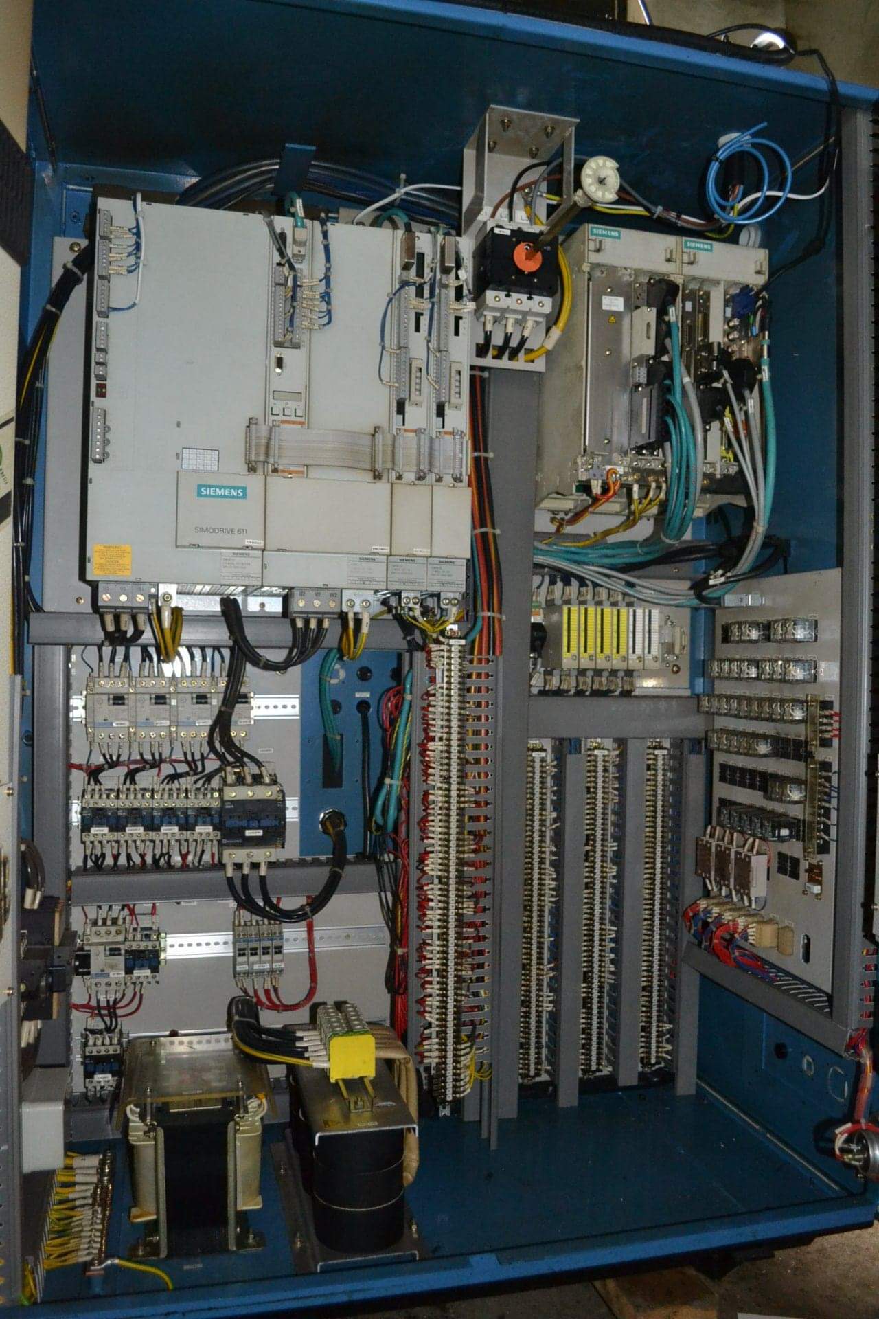

Tomorrow i will make more photos
- aleksamc
- Posts: 569
- Thank you received: 67
28 Oct 2020 04:44 - 28 Oct 2020 04:44 #187499
by aleksamc
Replied by aleksamc on topic Hyundai 18s hit sinumerik 840c

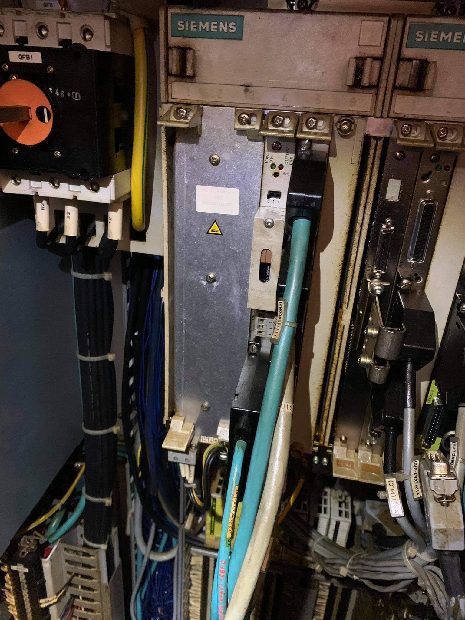

Make good photo of face of machine servodrives (that place where wires are).
And reference to manual or (as better make scan of wiring diagram).
Simovert (Servodrives) as you can see also use Profibus interface to comunicate with Simumeric. When you disconnect it from CNC board, probably they will go in fault. You will also need to reconfigure them.

I suppose that you need to live old drives, more over if they are in good condition. They should be only reconfigured.

Right now we try to revive old drivers we found out that :
6FC5114-0AB01-0AA1 VER J 5VDC 15VDC -15VDC POWER SUPPLY ASCOM
this power supply is broken later we see what is wrong with z axis if we revive it it will stay with old siemens and someday i may retrofit it right now i want to buy working mill to expand my workshop.
