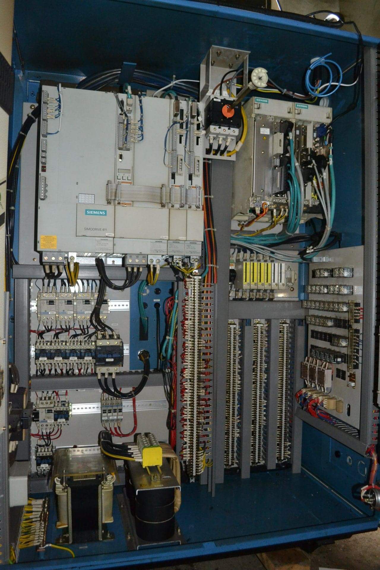

- Torus13
- Posts: 12
27 Oct 2020 09:30 #187396
by Torus13
Replied by Torus13 on topic Hyundai 18s hit sinumerik 840c
Look like this is photo of cabine and servos used
- Posts: 4819
- Thank you received: 2177
27 Oct 2020 10:43 - 27 Oct 2020 10:49 #187398
Replied by Aciera on topic Hyundai 18s hit sinumerik 840c
So looks like those drives take a 10V Signal that would certainly be possible with a Mesa board do you know what kind of encoders are used?

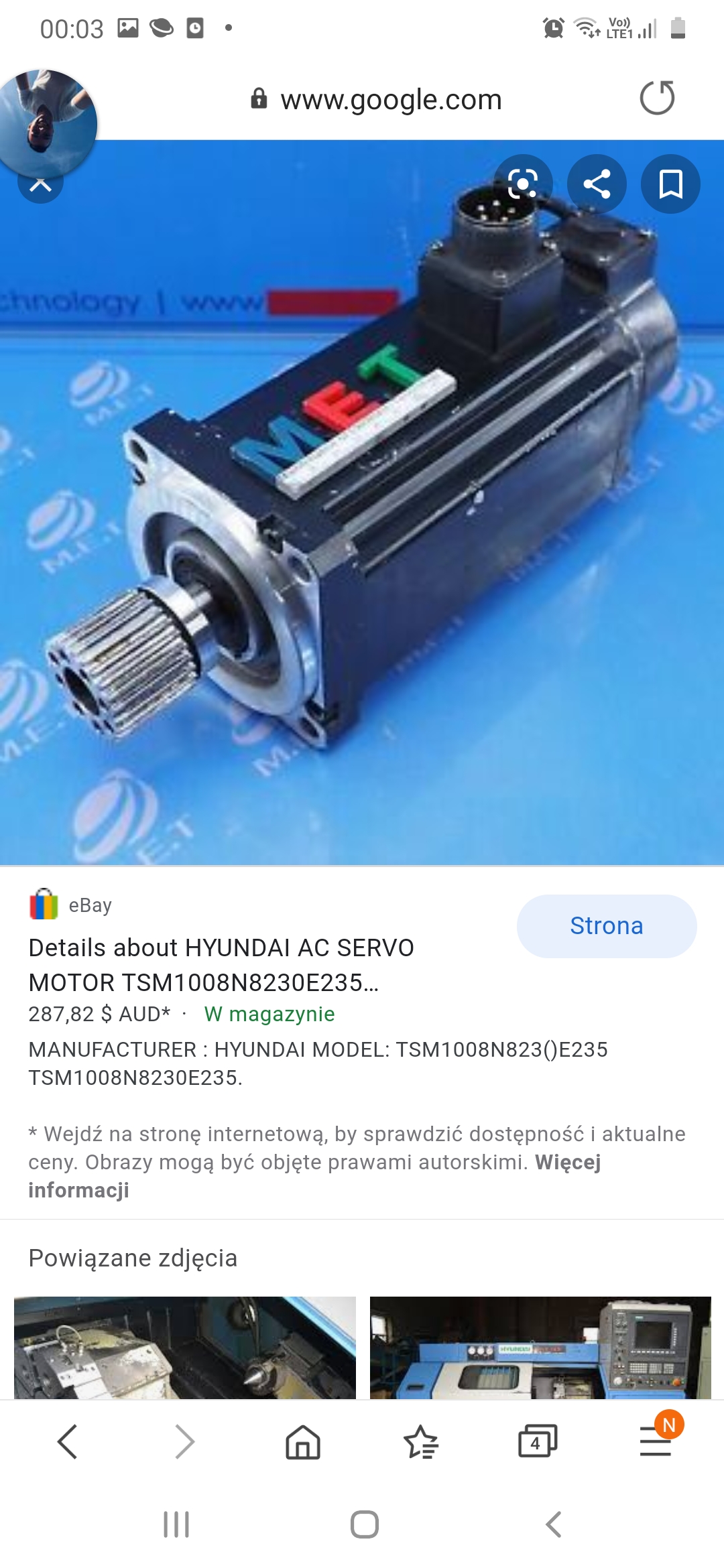

- Torus13
- Posts: 12
27 Oct 2020 11:10 #187399
by Torus13
I cant find them where they may be placed on back of motors?

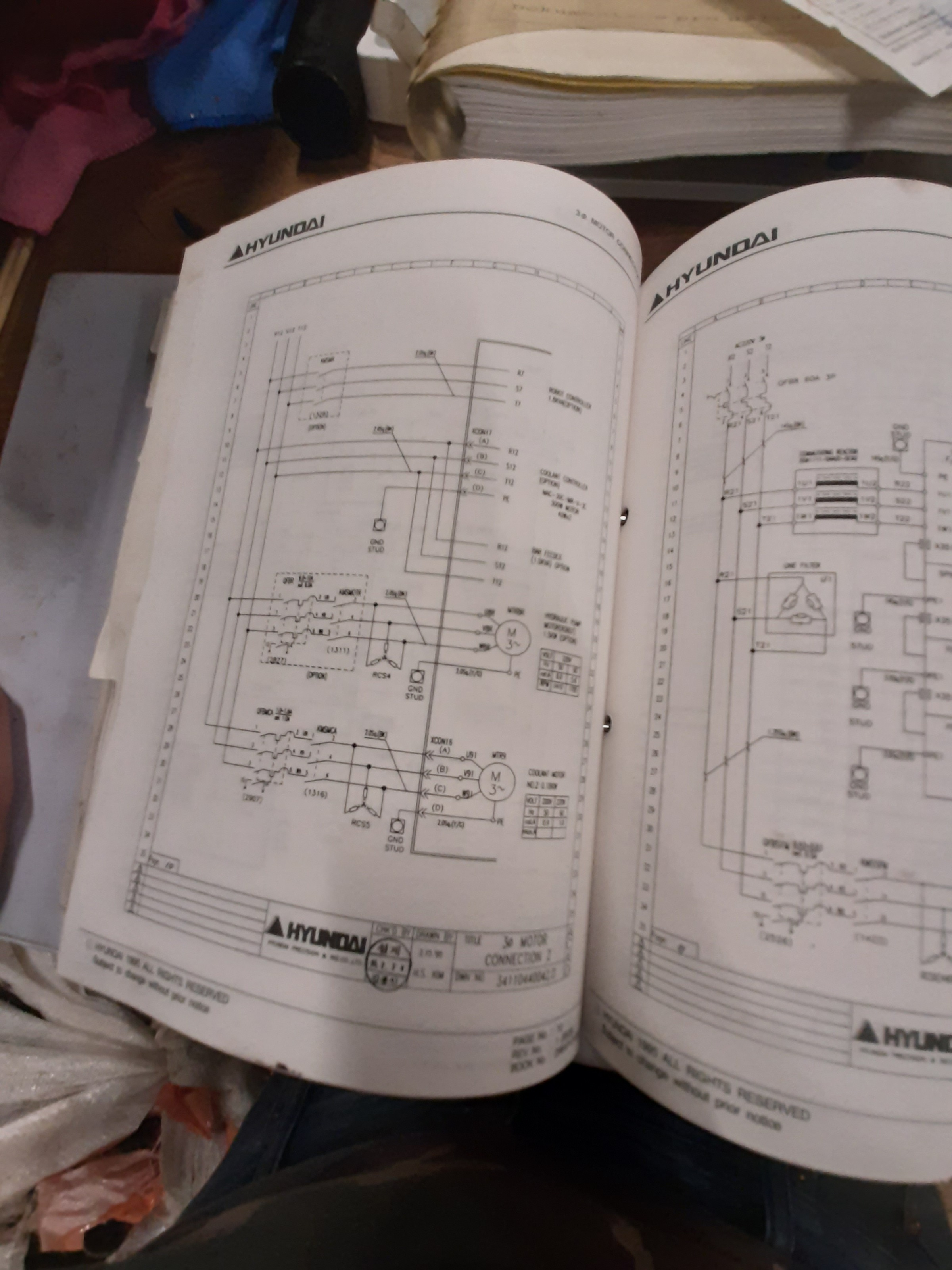

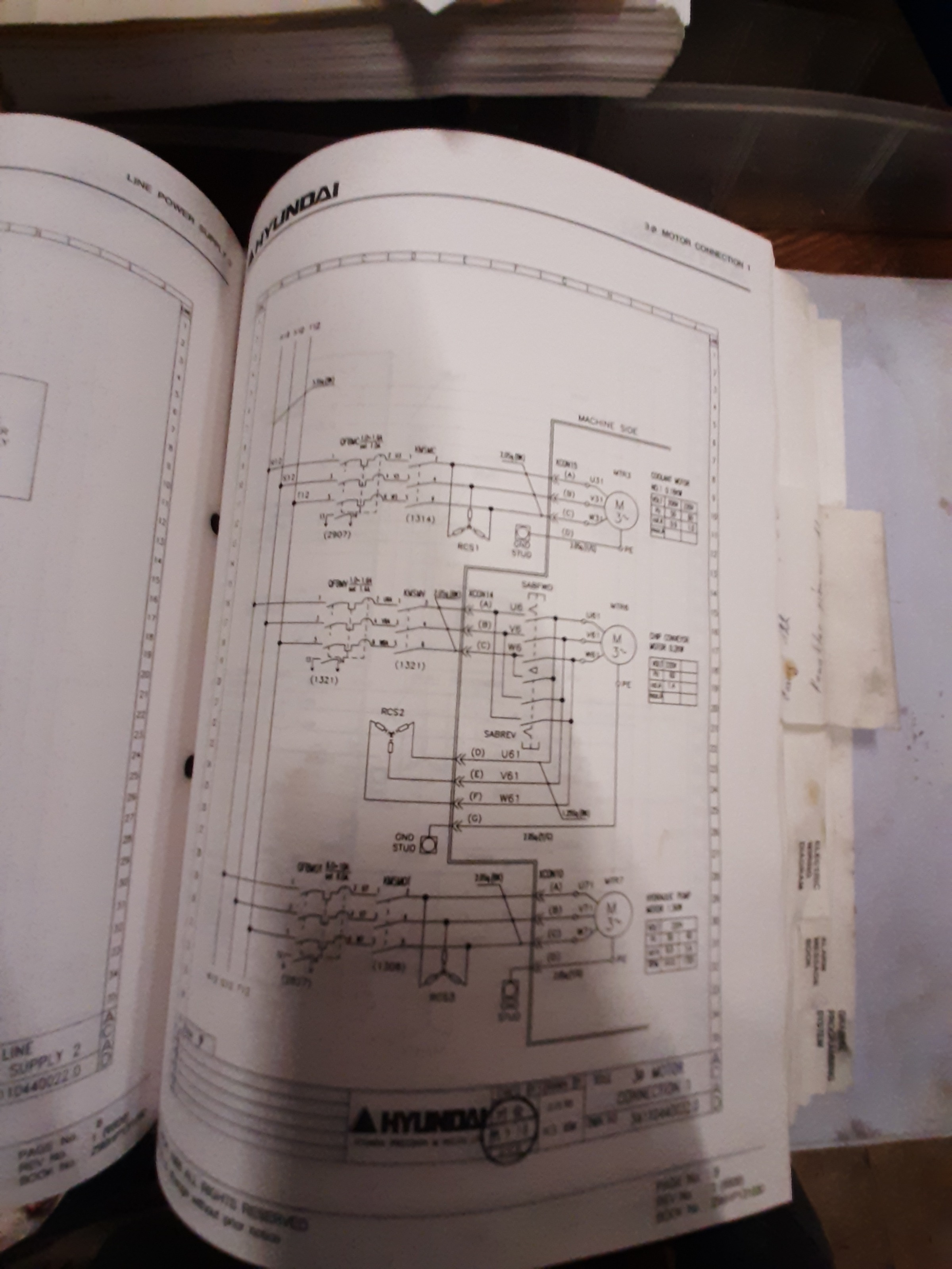

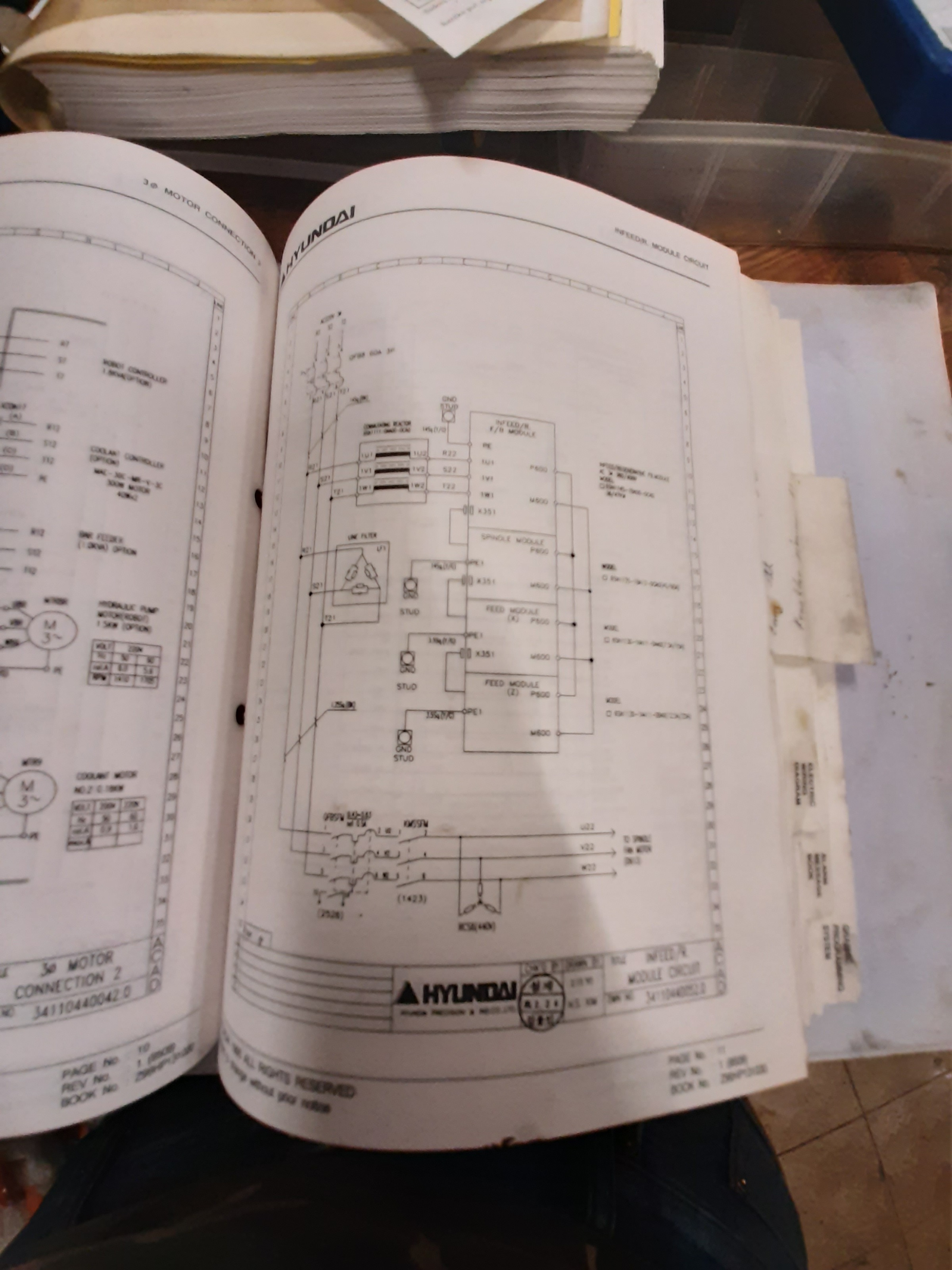

Probably. I guess they feed into the drives but I'm not sure. Do you have schematics for the wiring of the machine?

- Torus13
- Posts: 12
27 Oct 2020 12:36 #187407
by Torus13
Those ones?
