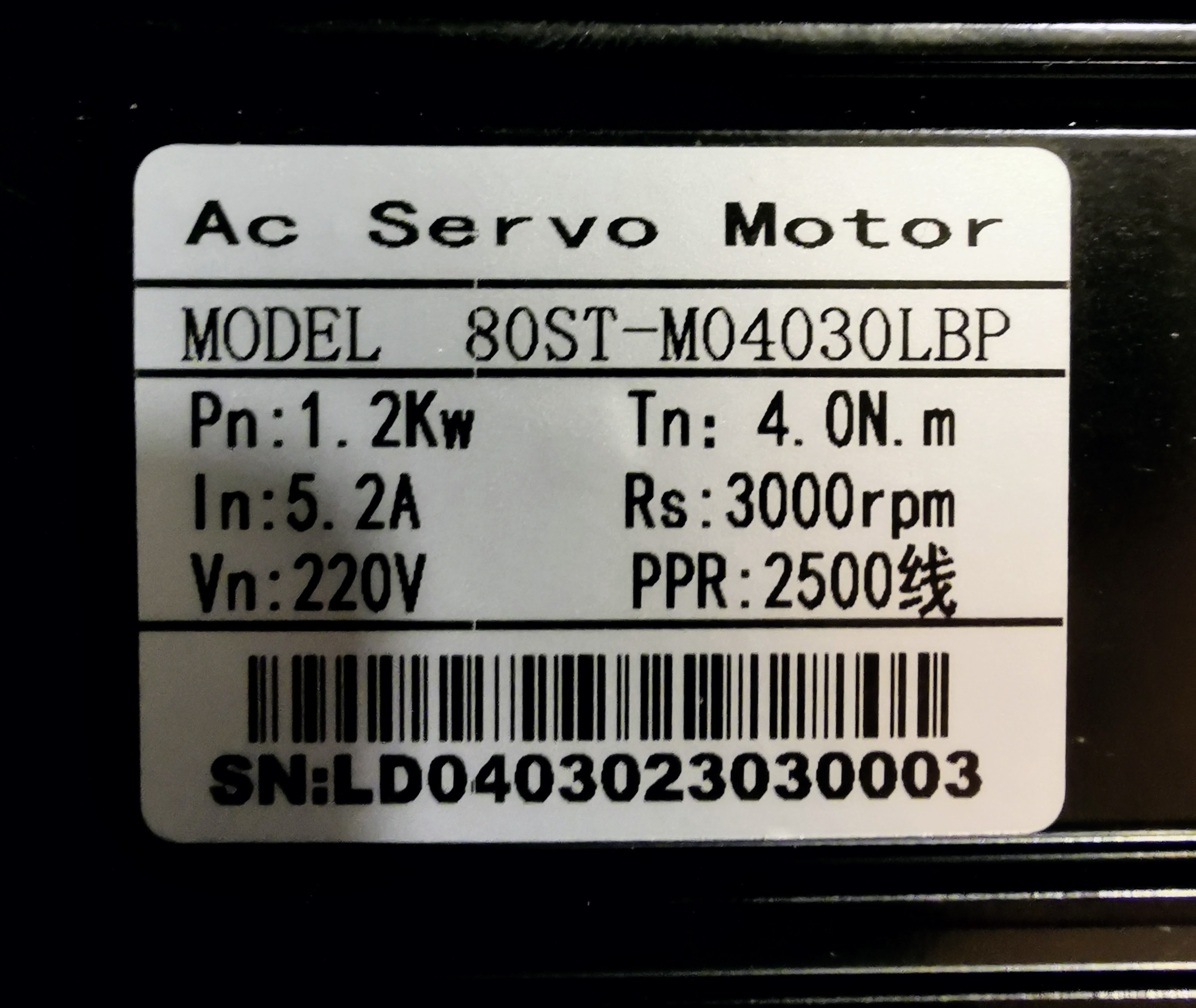

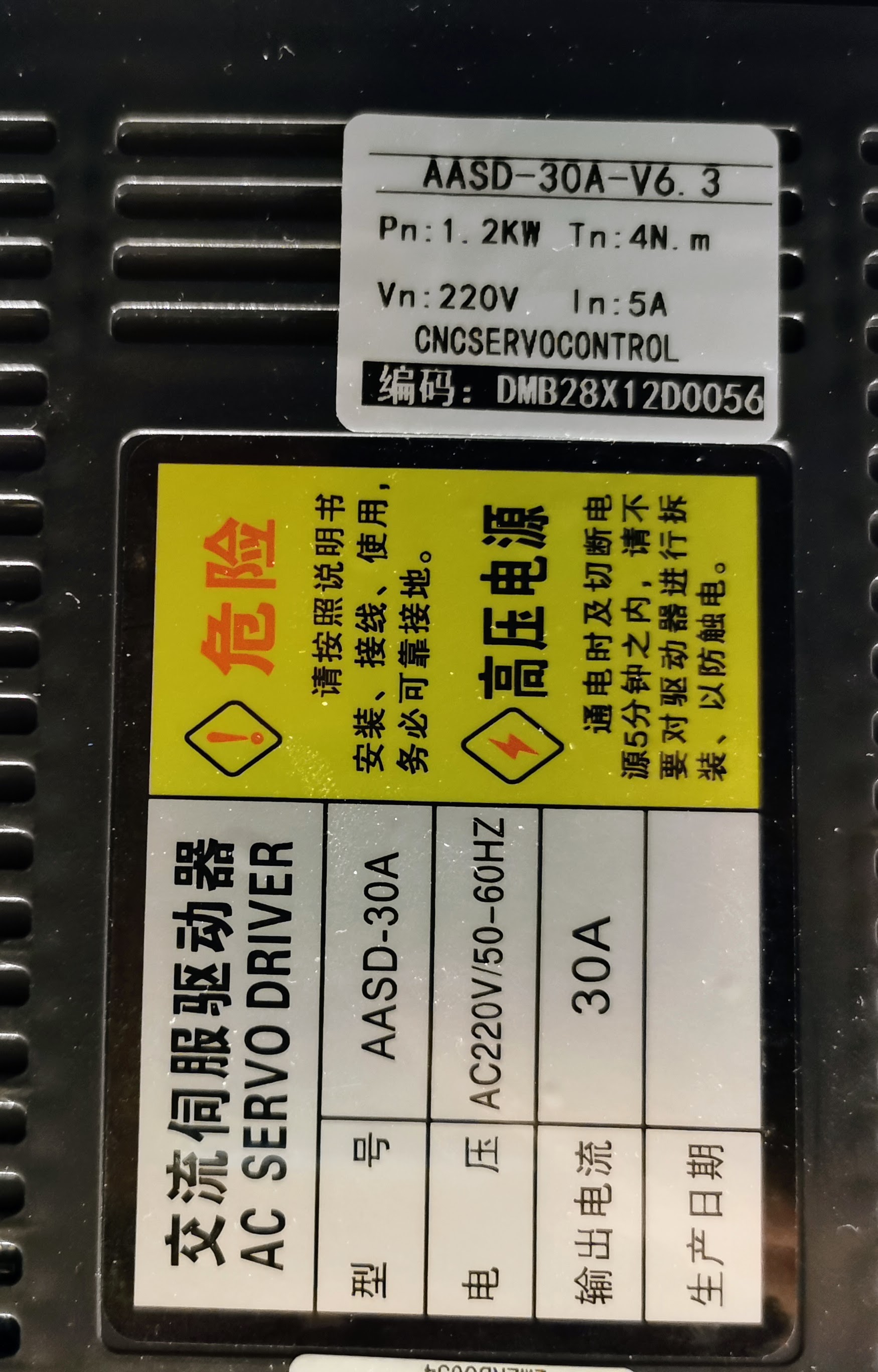

Hello everyone,
I recently decided to change the spindle on my milling machine and also switch to a servo motor. However, I'm facing an issue: at low speeds, the motor doesn't seem to deliver its full 1.2 kW of power. It can practically be stopped with bare hands, which makes tasks like threading impossible. Is such behavior normal for a servo motor? I've tried searching for a solution online and on this forum but haven't had much luck.
Additional details:
Additional details:
- the spindle is controlled by a MESA 7I95 in step mode (Pn002=2);
- Pn098 = 20;
- the motor also has a strange behavior in maintaining speed - it fluctuates within quite large ranges, both when controlled by MESA and when using the driver's internal control Fn002.
- I tryed to play with Pn259 + Pn257 but without big success.
Links to videos:
photos.app.goo.gl/PPnikUve9ojGVg2q6
photos.app.goo.gl/xt18cd4i8q22xdtWA
Thank you for your help!

Is there a tuning utility for the drive? Sounds like it is not tuned and/or has a low torque limit setting

4Nm is quite a small torque. Maybe try setting a torque wrench to that level to calibrate your hands and see if the motor is genereating a similar torque at low speeds.
However, looking at this tapping torque calculator, 4Nm should be enough for M16(!) in Aluminium, so it sounds like you probably are low on torque.
A servo motor should make rated torque at 0 rpm. That's prety much their job.
