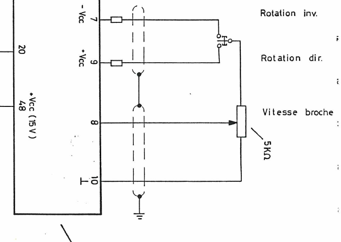

Not so good for the Lenze 490 DC speed controller :-( Its potentiometer rails are at +-15VDC.
Maybe the Lenze has a trimpot?
Otherwise looks like something I need to add to a helper circuit board...

You could also do it with a floating 15V power supply and ground either the +15 or -15 end of the PS with the OPTOs or a relay

Looks like I need switch both legs of the wiper pot (Vcc+ > Vcc- ), but how???
This has to be an idiom.
26 Aug 2012 23:55 #23676 by PCW
If you want to use the exiting (non floating) power supply you need a double pole double through switch/relay
But there are a lot of funny side effects (full speed backwards when disabled is one)
With a floating 15V supply you use a double pole double throw switch or relay to reverse the output (always the ANALOG- and ANALOG out)
this is a standard reversing switch but will only work with a floating supply

I'm too stupid to figure this out. In the floating circuit, where do I put the other half of the dpdt switch to reverse the sense of the wiper control at the zero-crossing???
thx
_jC
The best solution I can find is a using triple-pole switch. I suppose there is a simular solution for the non-floating case. Can't for the life of me see a double pole switch solution.
Still too stupid to see it. I will reflect upon this.
Need to see what is in the comat relays, and if they can be wired in this way
