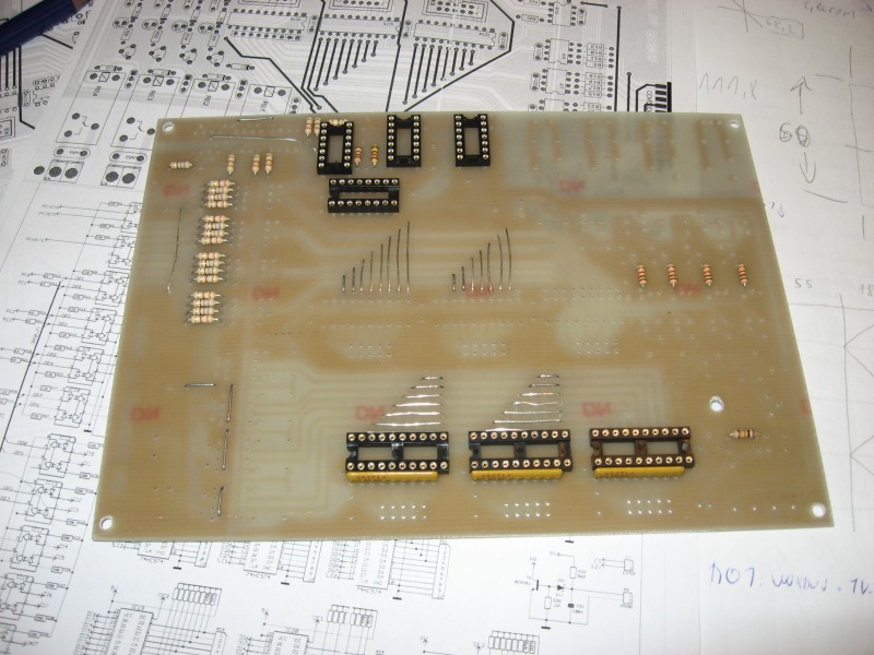

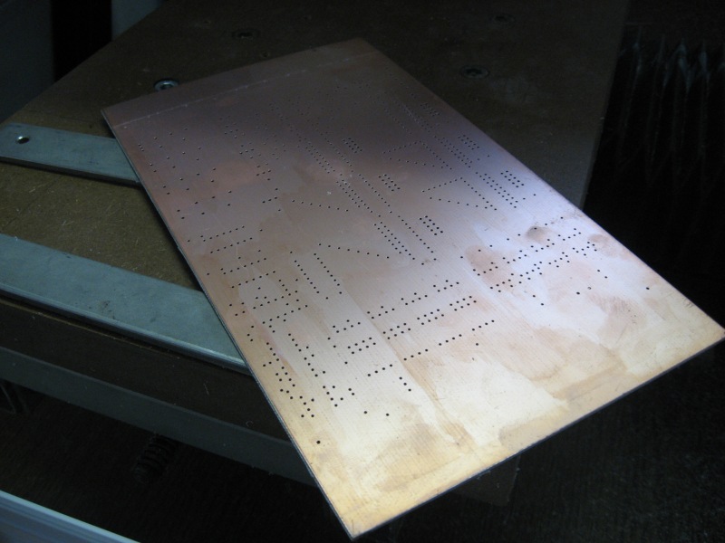

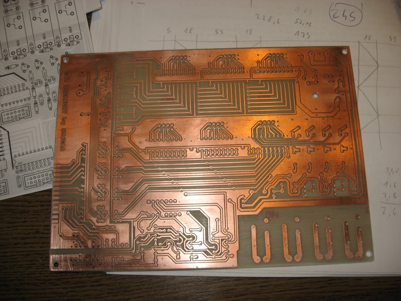

Cool. How did you etch the board?
John
John
- eslavko
- Posts: 267
- Thank you received: 4
26 Mar 2010 11:54 #2453
by eslavko
Replied by eslavko on topic Re:Simple EPP IO board
BigJohnT wrote:
Just google for toner transfer method for making PCB.
I simple therm....
I print image with laser printer onto "special" paper (.. onto stuff I found in my mailbox as advertisments)
I laminate that with modified office laminator onto cooper clad.
.. soak in hot watter few minutes
.. pell off paper
.. etch.. (I use 1/3 H2O, 1/3 HCL, 1/3 H2O2) in smallest possible quantity. (just to cover PCB while etching)
John
I simple therm....
.. pell off paper

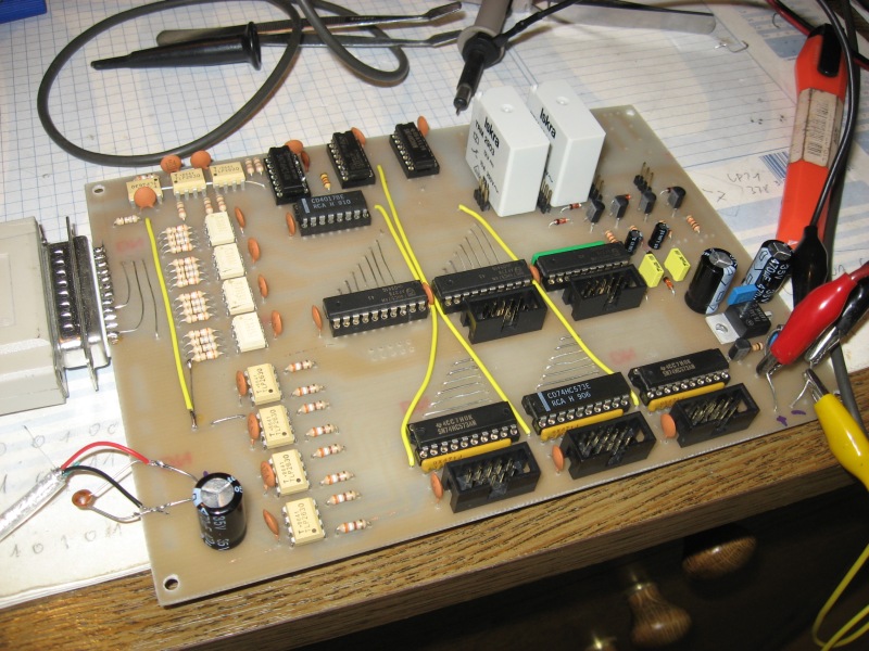

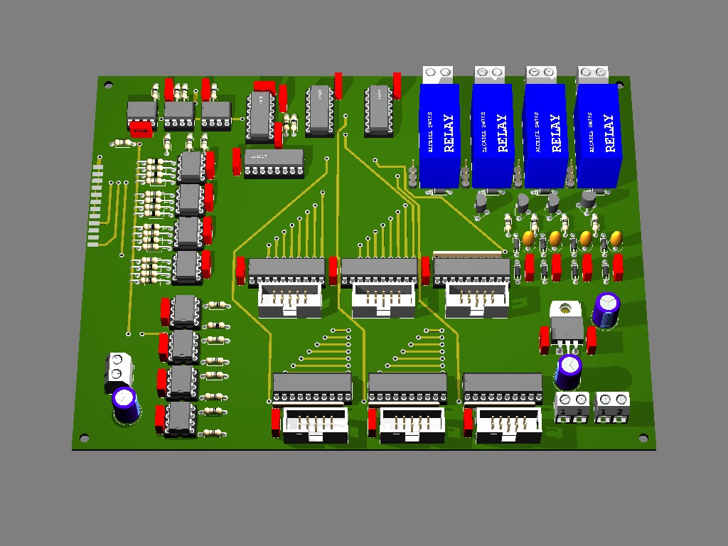

.... as usual 1'st board has few mistakes. So here is new schematic and board layout. Now the Board is tested. It's works as should be. Now need the time/knowledge to write driver.
For now I just rumbled in emc sources and get very confused... C is realy not my language
