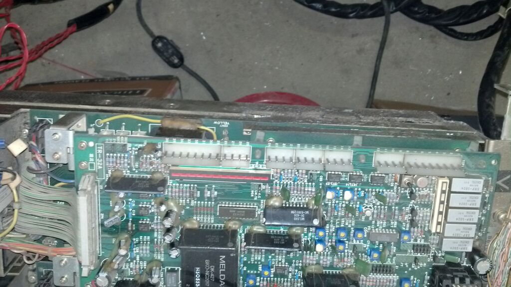

Hello,
I am putting together a micromachining center using Mitsubishi DC permanent magnet servo motors and meldar (mitsubishi) drives in a linuxcnc system, starting with four axes. To avoid loading the server up with lots of pictures, the link to info is at forum.linuxcnc.org/forum/38-general-linu...-hardware-components
I am about to order General Mechatronics GM6 card www.generalmechatronics.com/en/productdi...-motion-control-card and it looks like I would need optoisolators www.generalmechatronics.com/en/productdi...xis-optical-isolator in order to hook up the resolvers.
Is this correct? I have them all in my shopping cart, but would not order the isolators if I don't need them.
Thanks for any help.
I'm learning as I go, so please excuse my ignorance.

Thanks. I emailed them yesterday and received a reply this morning (NY time).
"In general, it is not necessary if your servo driver electronics are already isolated. So one isolation is important between the control electronics and the power electronics."
I now have something else to research, if the answer is not obvious. I had assumed that I would be using PWM, since that is how I have programmed robots in the past, and I saw the letters PWM in another (Japanese) manual that seemed to use the same drive. GM doesn't support PWM, only voltage or current reference.
I probably just "misspoke" when I mentioned PWM to them. Do you know if CNC's used PWM around 1987? Can you tell from the pics of the drive what kind of input it might use? Some parts of my main machine installation manual mentions voltage input, but is not too technical.

You probably would use the velocity closed-loop in the drive. The motor tachometers produce a voltage proportional to speed, LinuxCNC provides a voltage proportional to the requested speed, the drive attempts to match the two by PWM-modulating the motor voltage.
What is it that made you decide on the GM drives rather than the alternatives?
