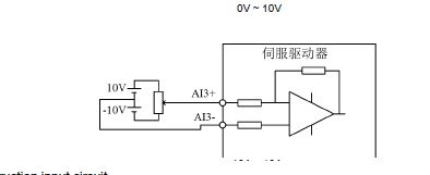

I have 3 Lichuan AC Servo that I was told that they should work with +-10V. They kind of do but not in a correct way.
The +-10V sets the speed so the speed for +5V = speed for -5V, but in the same direction!
The direction is set by a separate pin.
On top of that the servo vibrates a lot when feed with negative voltage, but it runs smoot on positive voltage.
One solution is to build an interface with some opamps that derives the direction and rectifies the output voltage so it's Always positive.
One other solution that I suppose is possible is to do this in a hal-file or something.

Its entirely possible to do this is HAL (using the absolute component),
but its not likely to work very well as the direction signal will not be synchronized
perfectly with the analog output (VFDs often use 0 to 10V + direction but its not a good way to drive servos)
Are you sure there is not some setup option to get true +-10V operation from the drive?

We got the answer from the seller now and it is confirmed that it works like I have decribed and that I have not missad any parameter.
I have never heard about anything like this before and me and my friend that bought the drives feels scewed
If I shall use this drive an external interface that fix the signals feels like the only option.
This is a picture of how the drive is connected. It certanly looks like you should be able to use +-10V, but the fact that there is an input pin that can set direction talks for itself I think
Dear Bengt,
I consult the manufacturer and was told that the AI3 analog input connector (PIN 18, PIN19) cannot control with ±10V,just can control with 0-10V analog voltage signal.
And if you want change the motor direction, use the external DI4 to switch, which you could see the setting parameter according the manual, and i checked the manual and update it, please see now whether it could be helpful to you. And if you found anything which is fault, you also could let us know, I will check for you with Lichuan manufacturerer.
HelenI have never heard about anything like this before and me and my friend that bought the drives feels scewed

There is no need to build any extra circuitry, you can (as PCW said) do it all in HAL.
You need to use the HAL abs component
This will take the +/- 10V signal as input and output 0-10V on the abs.0.out pin and direction on abs.0.is-negative

So, is there any timing issues going via HAL?
If the speed/torque isn't continuous through zero or there is a delay switching direction then that is likely to cause poor servo performance or instability.
Cheers
Bengt

No, I don't think so, the direction output will update at the same
time as the voltage output (and, possibly importantly, only when the
voltage output is very small).
External hardware would only be able to change state when the voltage
switched polarity, so would be working on the same sort of timing.
Replied by andypugh on topic Use 0-10V + dir on 7i77 instead of +-10V out
