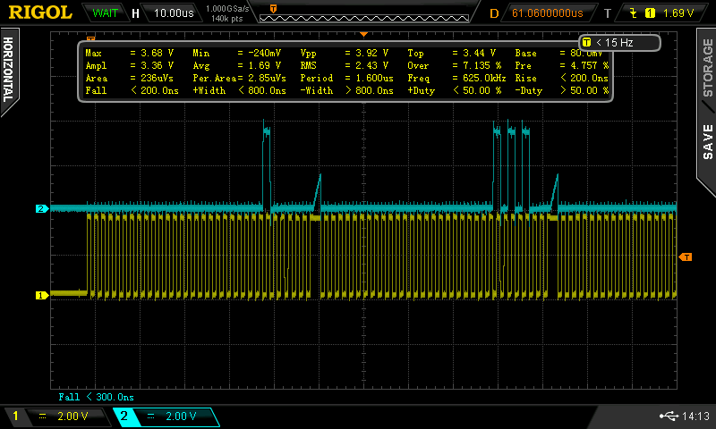

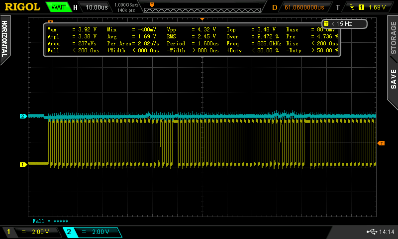

I attach several oscilloscope images:
Blue line shows data from odroid (Connected to PIN 13 of MESA P4 connector) and yellow line is SPICLK signal at PIN11 of P4 connector.
Here blue line is a SPIOUT at PIN 15 and yellow line SPICLK again.

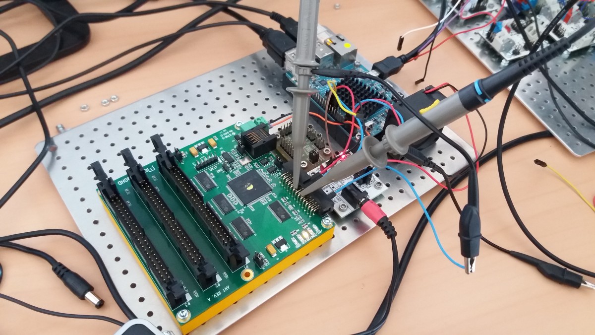

Here is overall look at the test setup:

mesa_test.hal:2: insmod for hm2_spi failed, returned -1I attach several oscilloscope images:

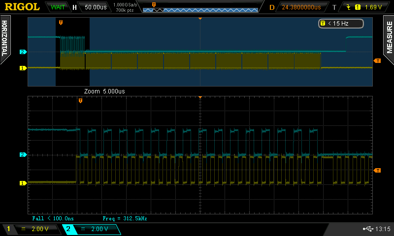

OK, I have the first success with mesa 7i90. I loaded the 7i90_spi_justio.bit bitfile to the FPGA trough
XVC
. Then I tried to initialize linuxcnc hostmot2 driver.
But I got the Invalid cookie error again although 7i90 card respond by some data on SPIOUT as is shown in following figure:

I tried to use mesaflash utility by running this command:
./mesaflash --device 7I90 --spi --addr /dev/spidev0.0 --fallback --write ../7i90/configs/fallback/7i90_spi_fallback.bit
Unexpected cookie at 0000..000c:
00000000 00000000 00000000
No 7I90 board found
But the result is almost the same as in case of hostmot2 driver initialization. The oscilloscope image is exactly the same.

21 Mar 2016 16:43 - 21 Mar 2016 17:00 #71991
Replied by PCW on topic Mesa 7i90 in SPI mode
The low level register information is documented the the regmap file included in the vhdl source zipfile
Unexpected cookie at 0000..000c: is odd also but maybe OK (the cookie is at 0x0100)
Its possible you have a polarity or SI issue if the SPI interface cannot read the cookie correctly
Note, SI issues on the SPI clock are not really clock speed dependent (they are edge rate dependent)
so running at a low clock speed will not help. Any significant ringing or ground bumping will cause trouble
