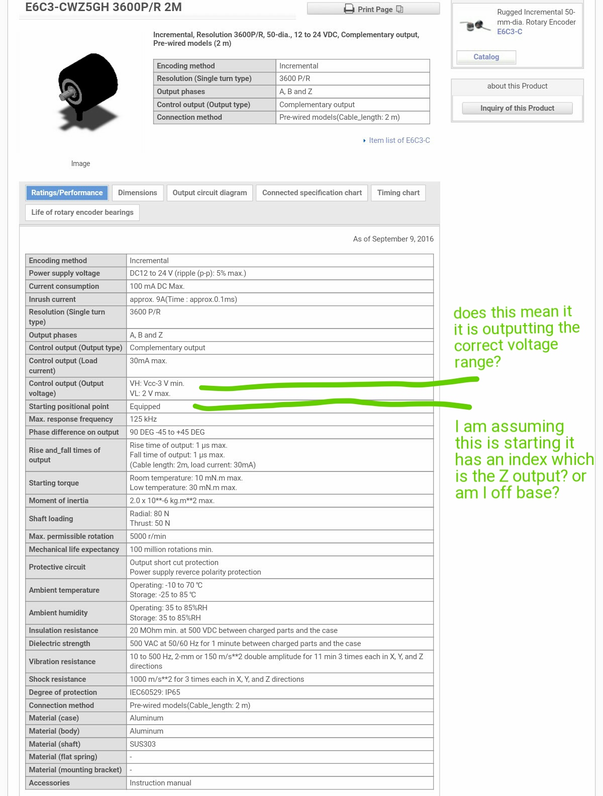

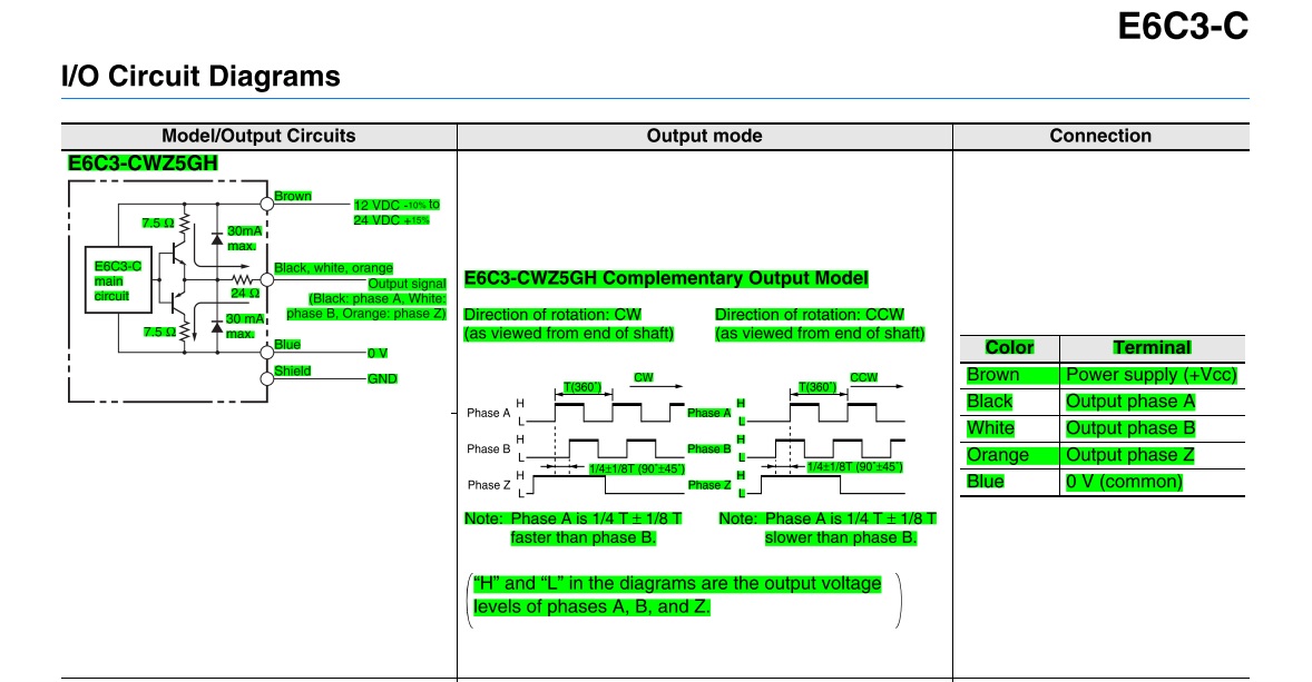

I goofed on the Encoder Purchase I think... it appears to be a Complementary type Encoder..is this typ encoder ok to use with the 7i76?
Link to Encoder Model Specifications: Omron E6C3-CWZ5GH
It has 5 wires:
Brown- Power Supply +Vcc 12vdc to 24vdc
Black- Output Phase A
White- Output Phase B
Orange- Output Phase Z
Blue- 0v Common
there are no wires for the A-, B-, Z-
Any thoughts?
Thanks in advance!
Chris

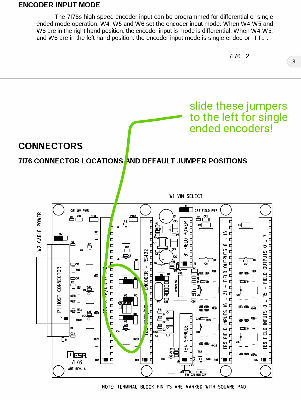

Replied by tommylight on topic Spindle Control 6i25+7i76 and GS3-22P0 VFD RS-485 compatible?
That is a single ended incremental encoder, and as far as i can recal all mesa boards have jumpers for using single ended encoders, so it should be ok, just check the 7i76 manualbto be sure.
On that diagram the Z output does not look like an index, in that case you can not use it for rigid taping, everything else should work.

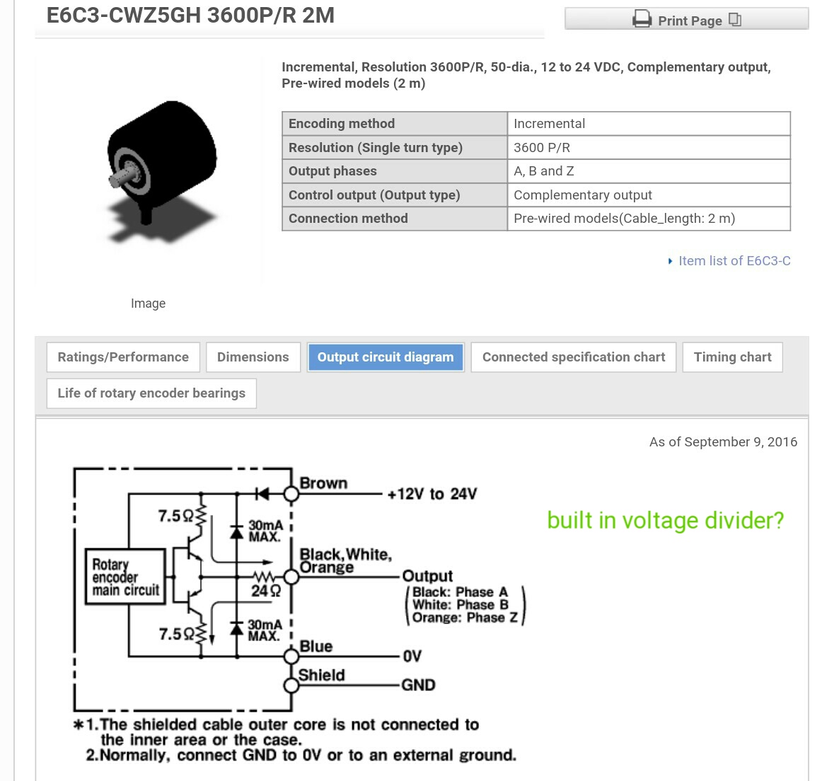

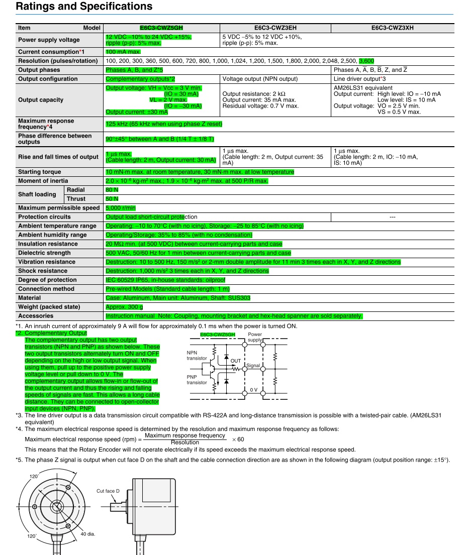

06 Mar 2017 03:33 #89083
by Lcvette
OK it appears there are jumpers w4, w5, w6 to change to single ended encoders, I wasn't aware that's what this was.. so that's solved.. sweet!!
After combing through the specs again a few things jumped out at me. See the images below for reference, I marked them up with notes. I am not an electronics wiz, but from researching voltage dividers, it sort of appears that there are resistors being shown that are very close to achieving what a voltage divider would look like and the resistor sizes are very close to what the calculators are saying would be correct to do it to under 5v. Thoughts? I also saw where it shows the output as follows:
H- 3v min
L- 2v max
So I'm now wondering if the output is already the correct voltage, any thoughts here are great. I will contact omron tomorrow for verification as well.

06 Mar 2017 22:04 #89106
Here we go:
No changes to 7i76, no jumpers to move, just connect A, B, and Z, to the enc A+, enc B+, and Idx+. NOT directly !!!
Nothing in the outputs is 3V, IT IS 3V under the VCC ( in case of 12V it is 9V, in case of 24V it is 21V ) .
That is not a voltage divider, that is a "push-pull" output made of 2 transistors, so it can sink and source to the output.
Please read this before wiring the encoder,
learn.sparkfun.com/tutorials/voltage-dividers
make sure you understand how they should be wired and find some resistors that can be used as follows : You mentioned using 24V power, so to be sure that the current draw will not exceed 10mA and to easier calculate lets say a 2.4Kohm resistor (usual values 2.2 or 3.3 should do), now you need 3 to 5V at the encoder inputs on the 7i76 so that would imply 330 to 470 ohm . To recap, you need one 2.2KOhm and one 330 Ohm resistor for each channel, OR 3.3KOhm and 470Ohm.
On the pictures on that page you have Vin ( that is the output FROM the encoder ), Vout ( that is the input ON the 7i76 ) and the ground wire.
