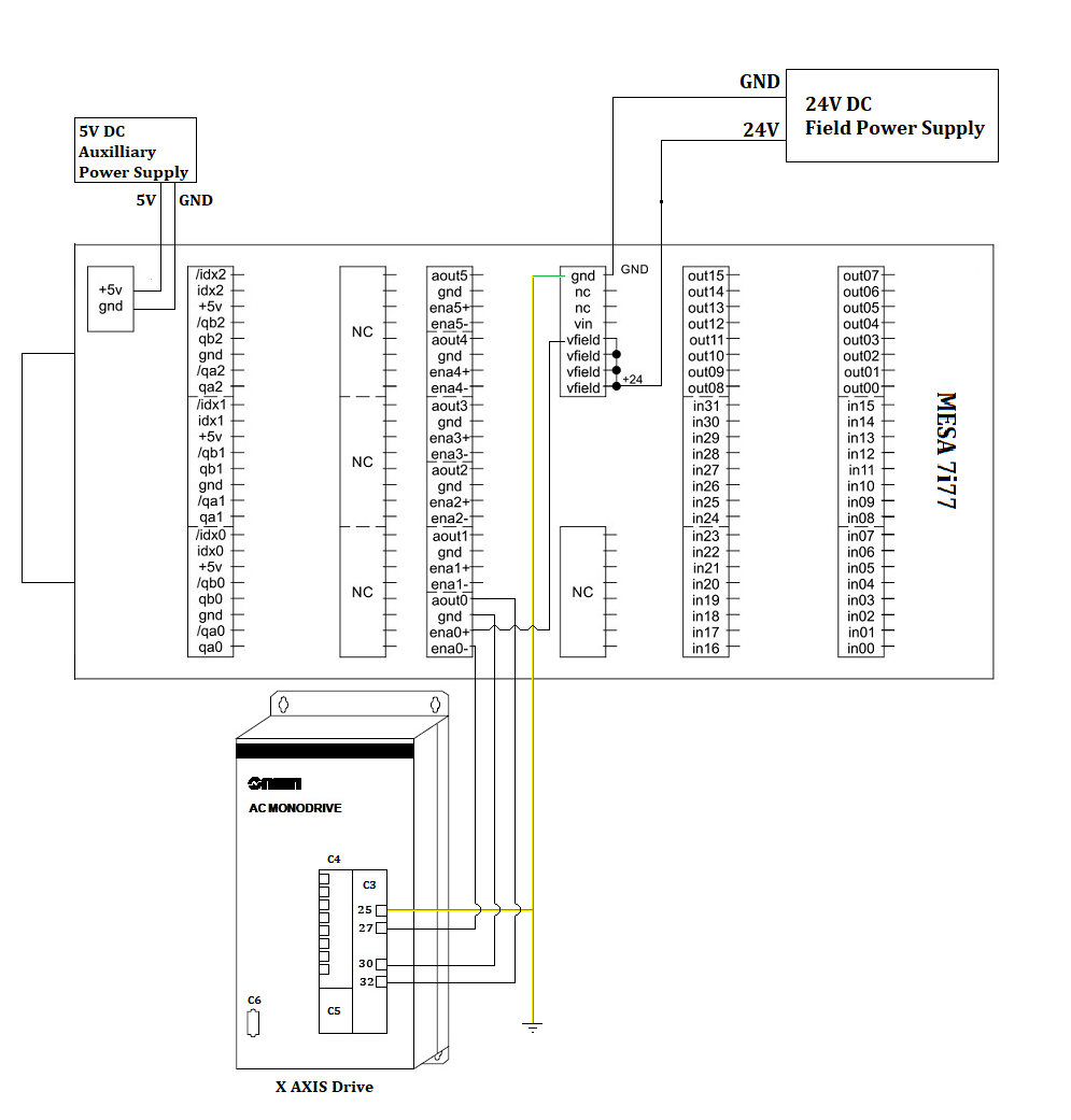

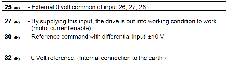

- PanagiotisZ
- Posts: 16
07 Oct 2017 13:18 #100040
by PanagiotisZ
Replied by PanagiotisZ on topic 7i77 axis enable
Hello everyone!
I'm on the process of making wiring drawings between my analog drives to a Mesa 7i77. I'm a bit confused about the connections.
I haven't received the actual card yet due to bureaucratic delays, but time presses and I may have to present my project (diploma thesis) without a connected and working set-up. However, I was requested to include all basic wiring drawings in my writing, at least the way I believe they will have to be done... (drive-to-mesa, switches-to-mesa, encoders-to-mesa etc.).
Following the drive and mesa 7i77 manuals I think my connections will look like in the picture bellow. I m also uploading a second picture that explains the 4 drive input pins I'm using. Can anyone at least verify that I m getting the concept right? Using just a power supply, I connected drive pin 27 to the +24V pole and pin 25 to GND and the drive was enabled, I also made the motor rotate by supplying a small voltage to pins 30 and 32 just to test its function.
Thanks in advance!
Thanks in advance!
