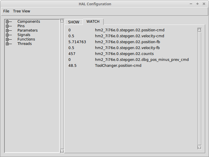

I'm trying to get a 6 position tool changer (Emco Compact 5) to work fully.
I've got the changer rotating but there are many things still not quite right with the whole configuration.
A few background details:
The toolchanger is now rotated by a stepper motor, and it is the rotate past a pawl and reverse to lock type.
The main problem is the velocity of the toolchanger is really slow - minutes to perform a change.
The forums help is always appreciated.
PS - I killed the Beaglebone - so this is why I'm playing with a Mesa card and linuxcnc

I've made the changes and I have the toolchanger moving, although rather slowly. This is what happened on the BBB and I got around it by not using the PID.
with P=1000, I=0, D=0 i get 0.5 for velocity when doing a tool change. Playing with P and increasing it seems to directly impact the velocity but I understand that P should be limited to 1000?
I.E. P=2000 the velocity rises to 1, P=2500 and velocity goes to 1.25
Is there another way of making the velocity go higher?
I've already increased the stepgen max velocity to way above that (250) and stepgen max acceleration is high too (4000) with no apparent effect (if they are too low they do limit).
Ideas?

P has basically nothing to do with velocity (only velocity corrections)
It sounds like you do not have FF1=1
Also, if this is a metric machine, set the PID maxerror to ~0.01

Can you post you hal and ini files? something very basic is broken here

OK what i think is happening is this:
The toolchanger does not provide a motion profile, it just steps the position so the
FF1 term is not doing the expected thing
You might try setting the PID maxerrror to 0 and see what happens

As suggested I changed the PID maxerror in the HAL to 0 (spent some time looking for this in the .ini...)
setp pid.ToolChanger.maxerror .000
That worked - Now its alive! Needs to be tuned though as it overshoots quite a bit.
This might be another reason for me to think about rewriting the toolchanger.comp, but if I get it working enough I may just live with it.
Thanks for your help!
Mike
