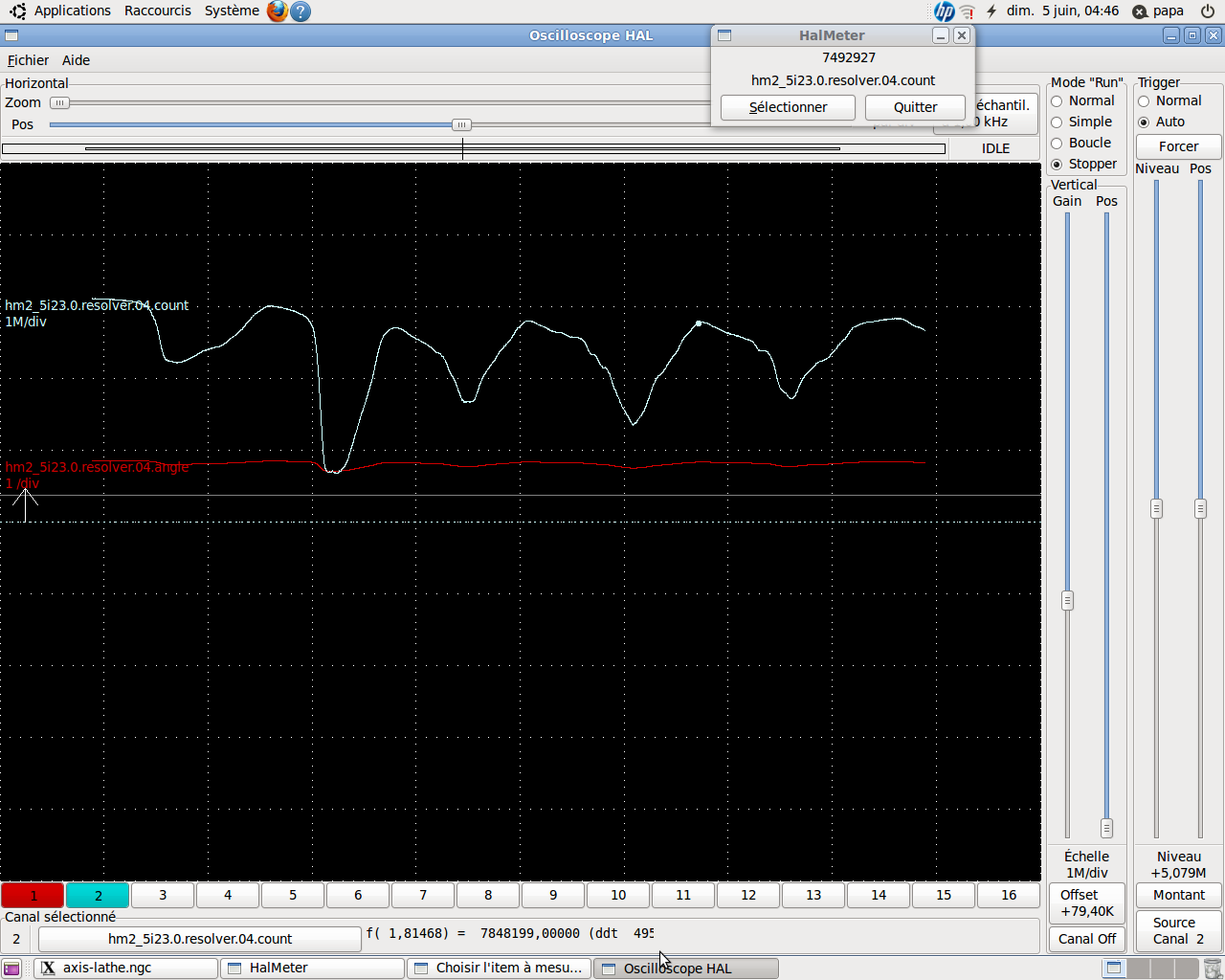

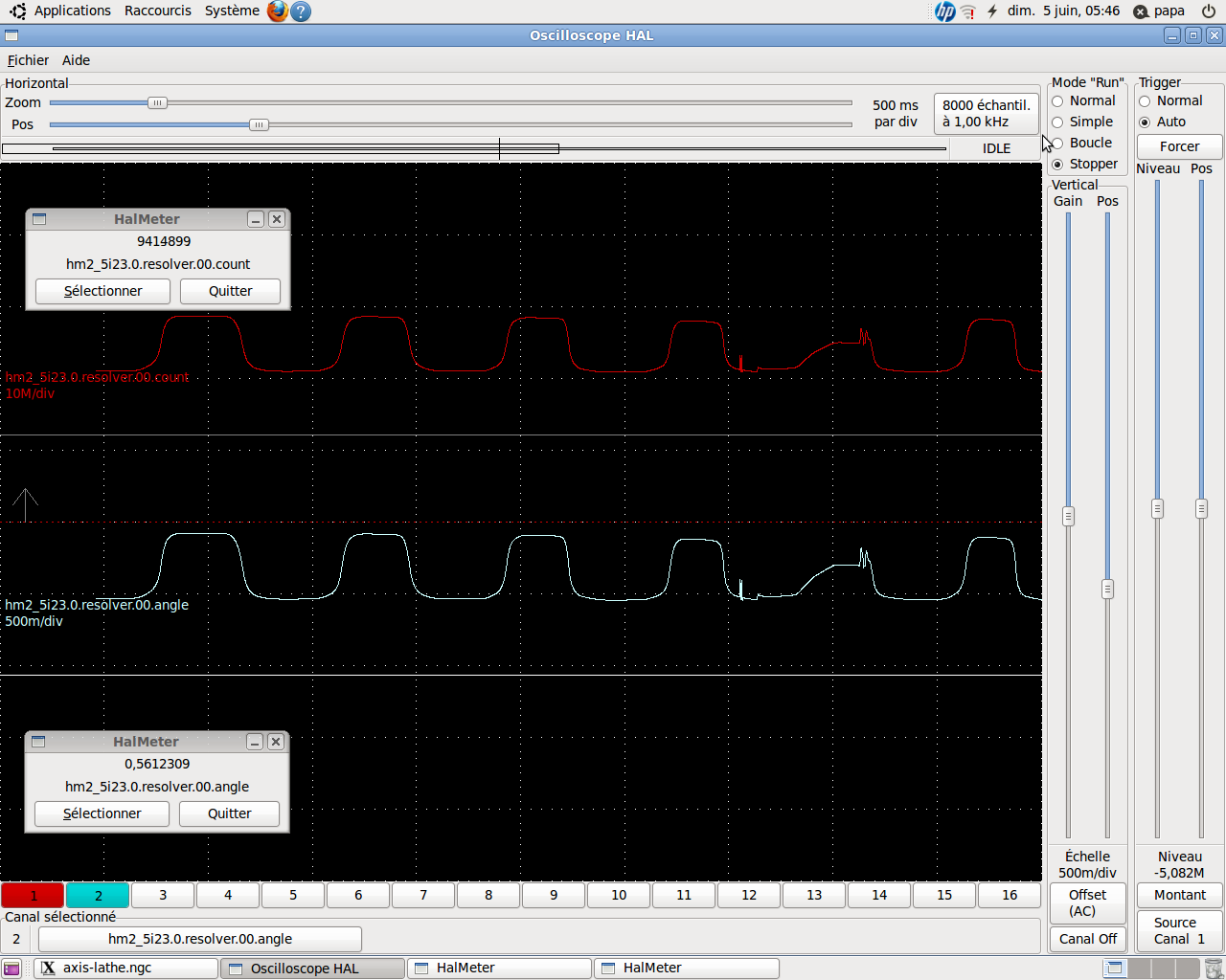

14 Jul 2017 16:05 #95795
by clematites93
Replied by clematites93 on topic 5i23 7i49 7i52 8i20
Hi PCW,
thank you again for your explanations. I would like to check if I understood correctly before moving on to other problems.
Hopefully my screenshots are visible enough
Thus, an angular variation, in one direction and then the other, of a few degrees of the shaft of the servomotor would produce an increase or a decrease of several millions of hm2_5i23.0.resolver.00 count.
On the other hand, a variation of several hundred thousand at rest can be considered as noise which will not interfer, in any appreciable way, on the measuring chain.
First question please : is you agree with this statement (I am not a specialist) ?

On you HALScope screen shots is the shaft moving back and forth?
If not, something very basic is wrong
is the resolver error bit set?
